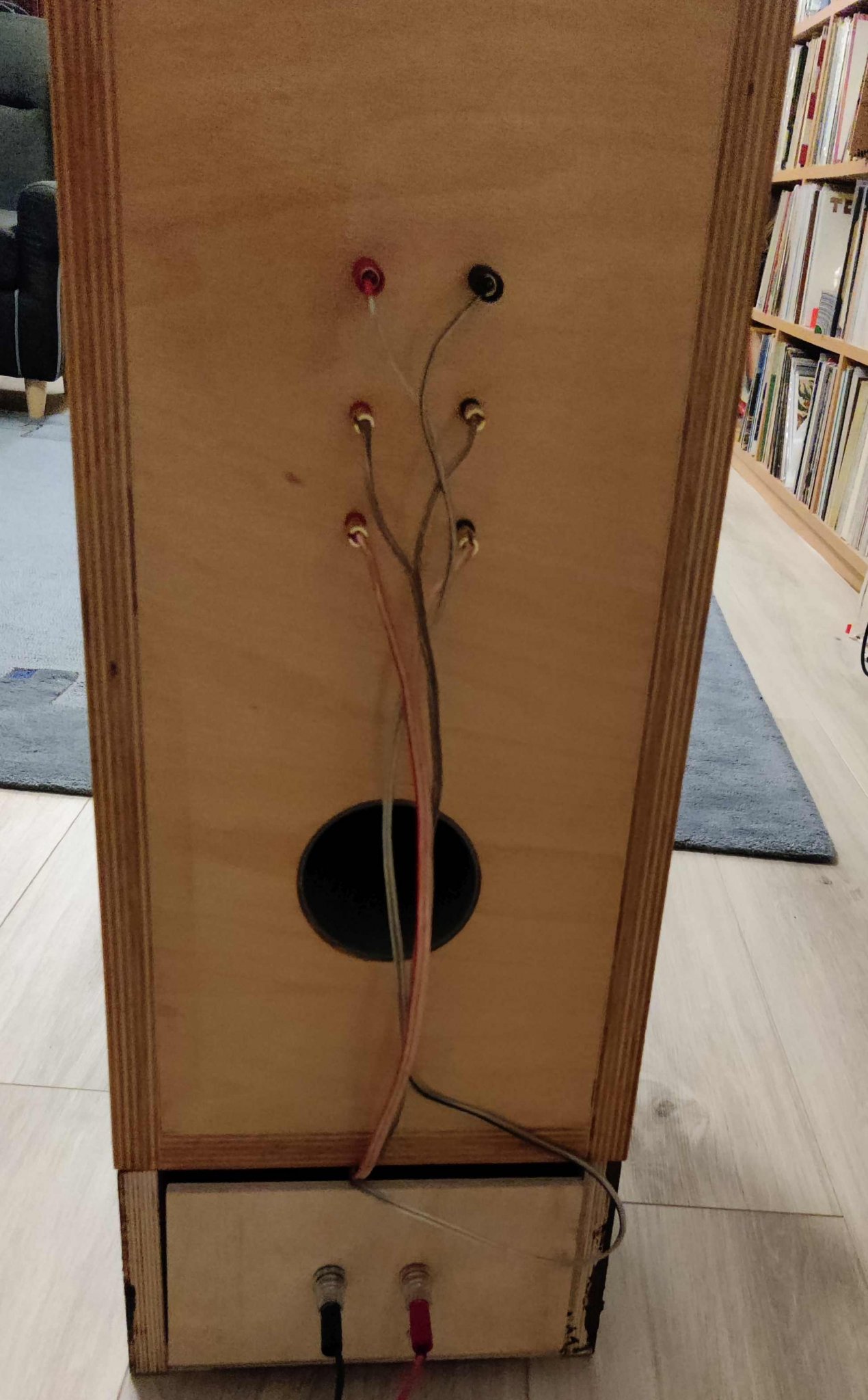

No. 2 is alive and playing

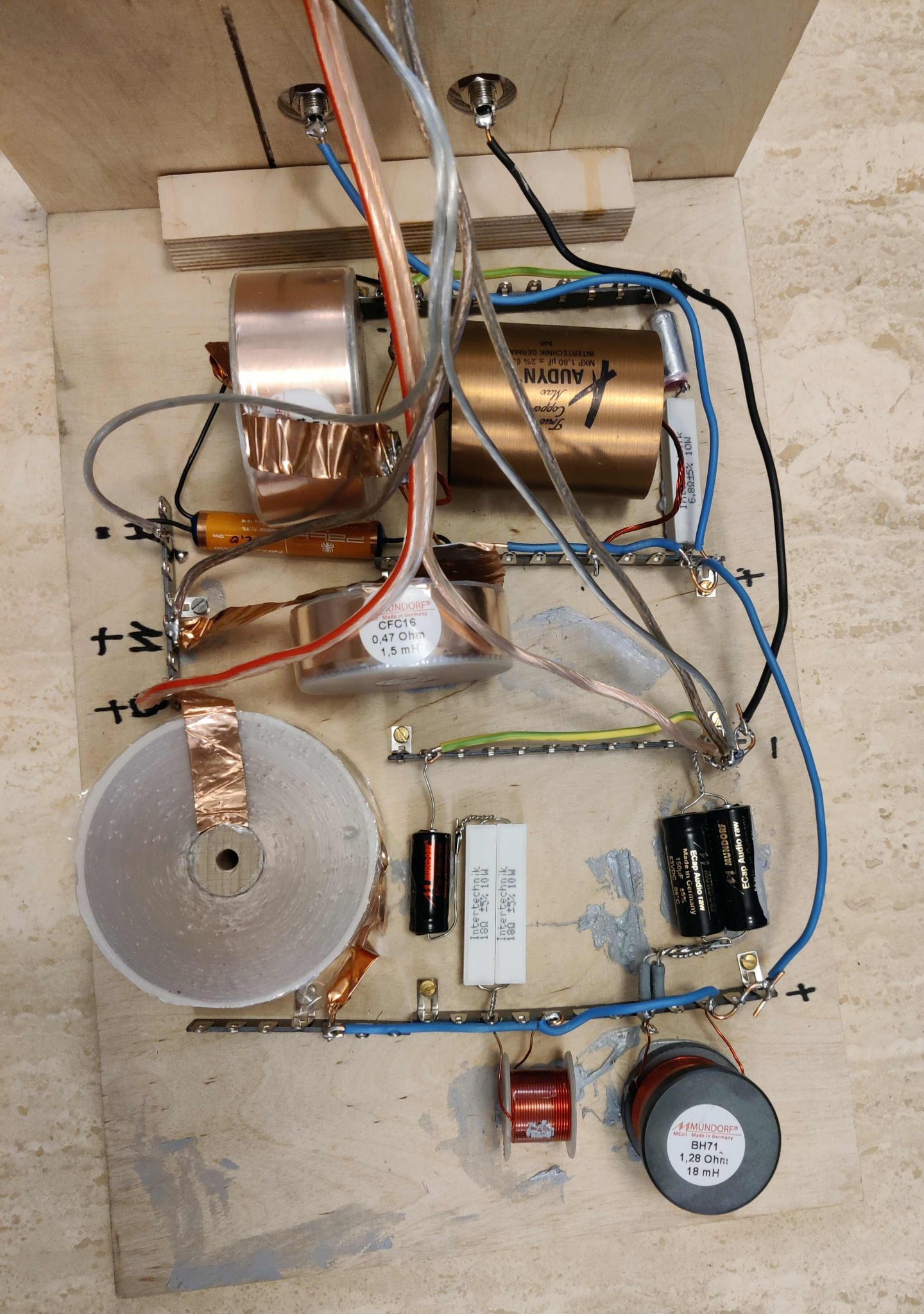

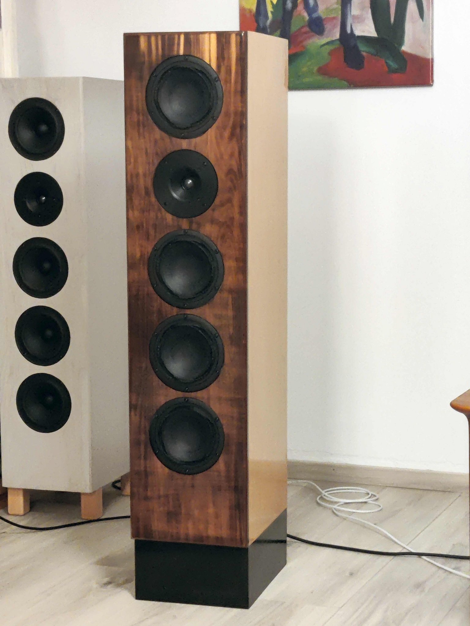

I finalized yesterday my Elsinore ULD build.
First I listened to the ULD with the old X-over while finishing the new x-over. After may be 5 hours of listening the sound opened and Ane Brun gave a private concert in my home.
Then I changed to the correct x-over and let everything play for some hours. in the evening I did some listening and encountered as follows;
  • the Purifi drivers are worth every cent, the sound changed significantly. The bass is stronger , may be deeper, that is not so important for me, but the deep region is a lot clearer. Sometimes the Elsinores sound shlightly muddy for me, I am using the PASS V_Fet amplifier (its single ended) With the 8W Monster (push-pull) there is no more mud.
  • midds are lightning fast, I had no idea that the Elsinores can be bettered that much. Tonality doesn't change that much, everything is clearer.
  • highs are my problem, they don't fit to the rest. There is some irritation and longer listening lead to fatigue.
I the night while sleeping I thougt about this (everynone may be aware of this penomenia). There may be 3 possible scenarios.
  • I confused the polarity of the tweeter because I had to change the cabling during work (my cable was not long enought) and used a preasembled cable (I would give this the highest probability),
  • the big C1, 1,8 µ needs time to burn in
  • I have to use R1 in a different way, I have a R with shielding, in the previous Elsinore I used them without connecting the shielding to minus.
I am convinced that this problem will be solved next weekend (my Elsionore ply in my friends room and I am only able to visit her on weekends).
So far, if someone has some spare money and a lot of time, go for the ULD Elsinores. Highly recommended.

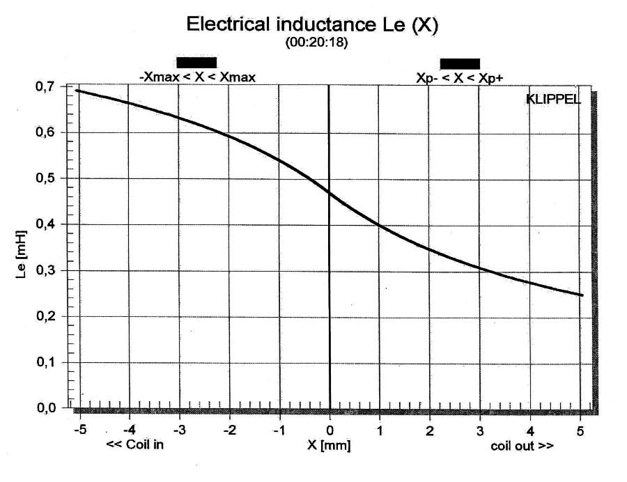

OK, here goes, I am going to make what I hope is a good attempt...
Yes, the position of the driver cone, assuming it is within the limits of Xmax, does not draw the same current as it does in the rest/mid position.
If the cone is in then the inductance goes up. The impedance seen by the amplifier also goes up. Current goes down.
If the cone is out then the inductance goes down. The impedance seen by the amplifier also goes up. Current goes up.
The amplifier's current is no stable.

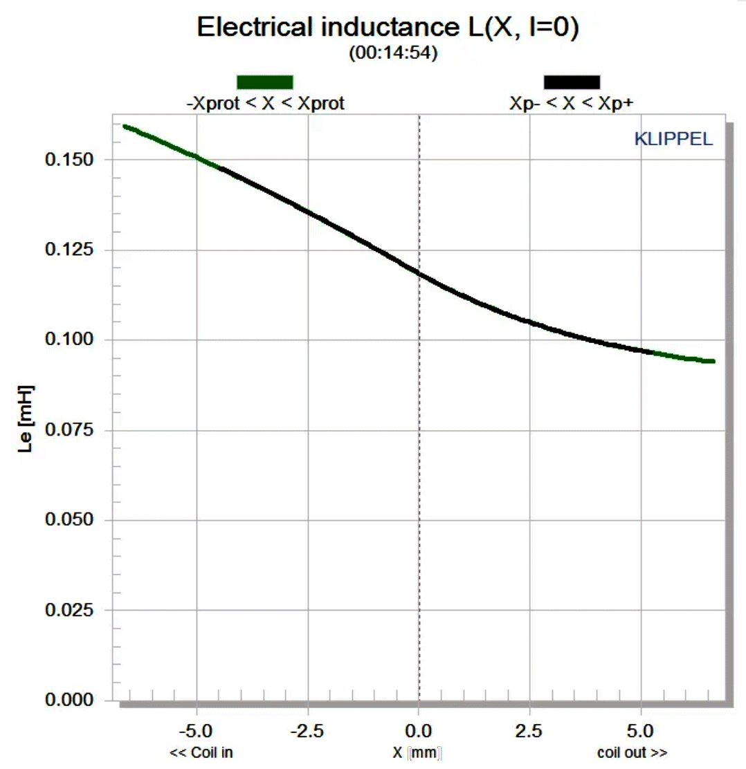

Let's look at what the above looks like, something like this Klippel curve:
So this is 10mm peak-to-peak excursion.
Using the above, let us add a series 1mH inductor:
Col 1.col 2.Col 3.Col 4.Col 5.
-5mm0.7mH+49%1.7mH+17&
0mm0.47mH0%1.45mH0%
+5mm0.25mH-47%1.25mH-14%
In fact the total variation from in to out is nearly 3:1 before we add something to stabilise that.
Now adding 1mH and look at columns 3 and 4 and something interesting has happened. It's gone from near -/+50% to around -/+15%
In ratio terms we have gone from 2.8:1 down to 1.35:1 and this has now stabilised the impedance.

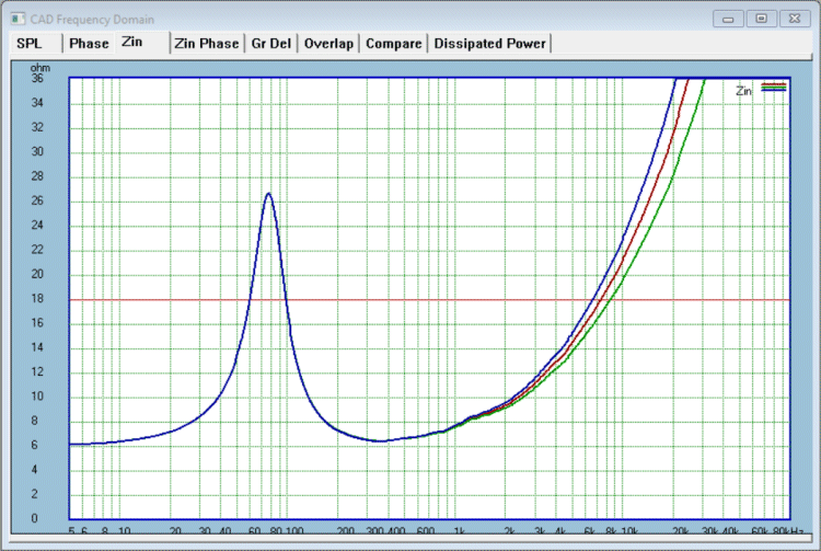

Look below for an example of what we are trying to stabilise:
Here Red is resting. Blue is when the cone is -5mm in position and Green is +5mm out.
The impedance plot you often see in reports are not stable impedances, they are potentially dancing all over the place!
And the crossover, they can make the problem worse and also, if you are clever about it, make it better.

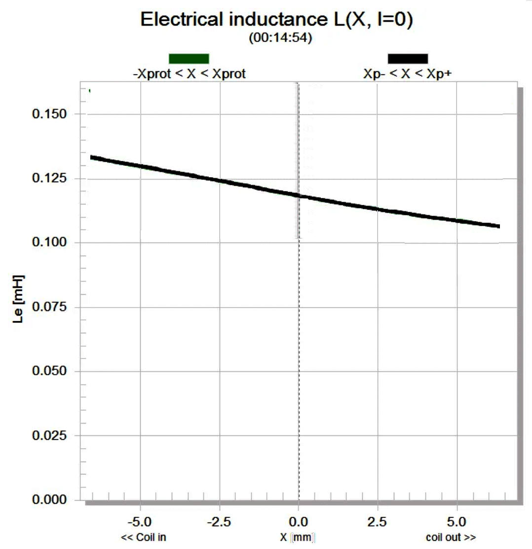

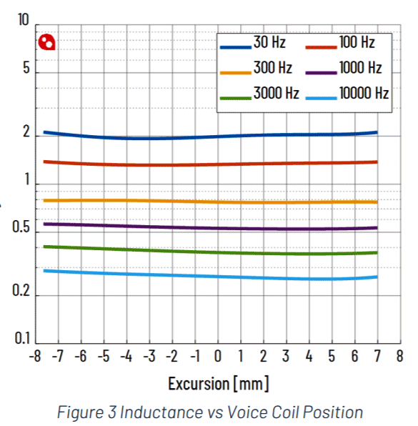

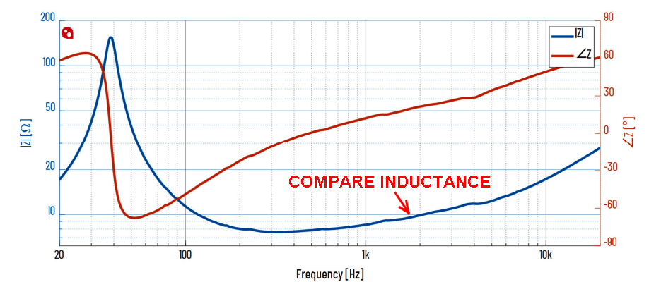

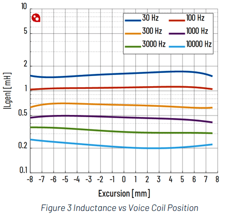

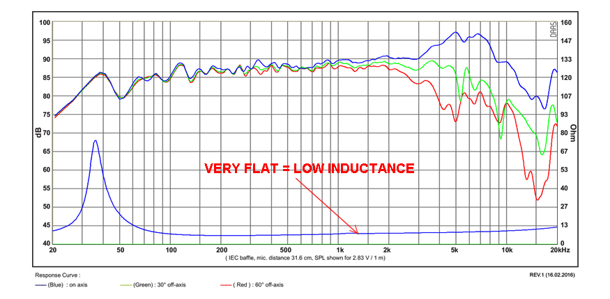

Compare the above 'Klippel' curve to this:
Now understand we can understand why the Purifi is so special. The inductance is not particularly low, but it is incredibly stable with excursion and hence impedance/current modulations are very low to start with.
Let us look at the SB Acoustics driver we use in the standard Elsinores and why they are way above average:
I have confirmed the above measurement and whilst not as good as the Purifi in flatness, they have an advantage of their own: Very low inductance!
Now add a 0.5mH inductor to both, the flat Purifi goes even a bit flatter again and the SB driver improves a whole lot.
The SB17 driver as the example below, let us add a series 0.5mH inductor.
-5mm0.17mH+41%0.67mH+8%
0mm0.12mH0%0.62mH0%
+5mm0.95mH-26%0.595mH-4%
Look how stable things are in columns 3 and 4 after the 0.5mH inductor is added in series. Now use four drivers in series parallel and the approx 12mm peak-to-peak excursion of that drive becomes a massive 48mm.
The effect is shown below with four drivers and since only 2.5mm p/p excursion is now required for 10,, p/p excursion, we can see that I doctored the measurement to look like below.
Compare that to the above. Now four SB17 drivers as the example below, let us add a series 0.5mH inductor.
-5mm0.13mH+8%0.63mH+2%
0mm0.12mH0%0.62mH0%
+5mm0.11mH-8%0.61mH-2%
Again, look at columns 3 and 4. Now the impedance will vary by only a few percent. Pretty amazing!
I am not sure how you guys reading the above understand that we are trying to eliminate distortion due to the driver not having a stable impedance and hence impedance/current modulations are the result, and how this leads to additional distortion.
We cannot reduce the distortion of the speaker, but we can use techniques that reduce the distortion of the amplifier because as a voltage source it cannot control current, only voltage.
So I will leave it there. It's up to you guys whether you want to understand this or not - but at least it will give Elsinore builders some idea of what is behind the thinking of the design.
Cheers, Joe

Hello All,
I went looking on my desktop and found this QA impedance and phase plot for the ScanSpeak XT25 tweeters that are installed in sealed boxes with HDS830875 woofers on my workbench. The same tweeters discussed back in the early posts of this thread.
As installed and measured the tweeters have 4 Ohm Mills resistors installed in series.
Both the impedance plot and phase plot are much flatter with the the 4R Mills resistor in series.
Thanks DT

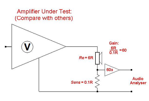

I want the world to become more aware that the imperfect driver causes the amplifier to produce "current distortion" due to what Esa Merilainen has called "EMF-derived distortion."
The beauty is that we can measure this distortion!
Note that the above measures the amplifier's "current distortion" and not that of the speaker, even if it is "EMF-derived distortion."
Yes, the amplier is what we are testing. Indeed with the same driver and changing the amplifier, we may well find that the two amplifier design might well produce somewhat different distortion profiles. Wouldn't that be cool, because we are measuring the distortion of the amplifier and finding differences? The implications are enormous: Amlifers do sound different and we can measure them/why?
That thought is not that easy to grasp. Use a high-quality audio analyser to measure the distortion in the above jig. This is set up for 8 Ohm driver, but change the gain = 30 approx, and then it is set up for 4 Ohm drivers. This way you recover the voltage that appears across the DC resistance of the voice coil as the suitable voltage that is proportional to the current that produces the force factor.

SB17MFC35-08:
PURIFI:
Now that is still reasonably low inductance compared to others, around double. But in this case it is not bad because the inductance is flat with any excursion and that is reveled here:
That aspect is much superior to the SB17 driver. You can see that the Purifi inductance is about twice, but much flatter with respect to voice coil position. The SB17 has ultra-low inductance, but not as flat. You can have one or the other, but unlikely both.

Addition to my yesterday post: Problem is fixed, it was the easiest thing ever, I confused the polarity of the tweeter.
Now everthing is like it should be and sounds as I hopped it would do. Or even a lot better.
It's like some guys allways write , go and build something, preferably a set of Elsinores ULD. Guess this is the end of my long journey for the best speakers.
