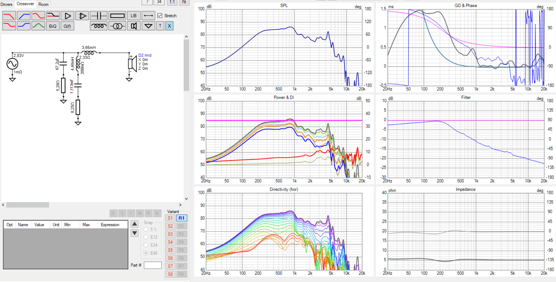

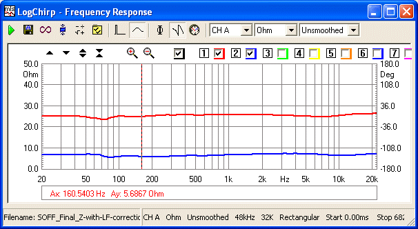

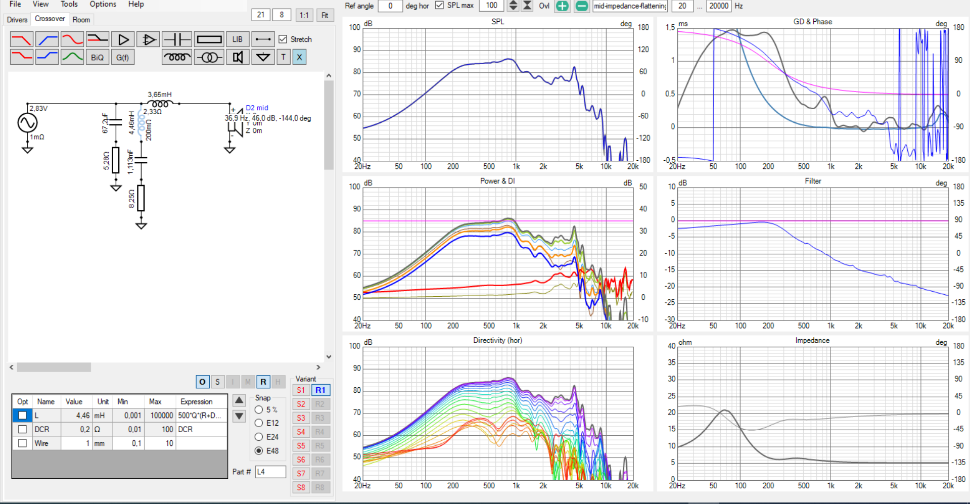

Hello Joe,
I am assuming that the tweeter plots in your post were made with a voltage source amplifier.
I also observe that both you and GedLee listen with your speakers toed in.
Me Too.
I also think of you as more artist than "textbook jockey".
Thanks DT
Re plots, correct. Voltage source is OK for amplitude/frequency response plots. But for distortion that is a different matter.
And I have found that it is actually best to ignore (but still look) what speakers do purely on axis. But for best performance, just a bit off-axis and design them that way.

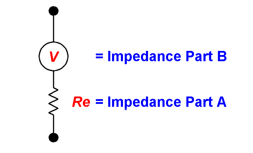

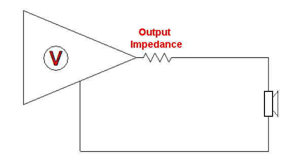

Here I will post this very simple but telling...:
The above, between the black dots, represents the "total load circuit impedance."
Where does the "the EMF-derived distortion" come from?
I can explain and so I shall attempt to explain it right now, so please read on...
The "total load circuit impedance" is Part A + Part B above. That determines the current drawn at any time from the amplifier.
If Part A is 6 Ohm and Part B is 3 Ohm and the source voltage is 9V, then the current will be 1 Amp and the heat dissipated in the voice coil will incidentally be 6 Watt. Part B is actually back-EMF of some sort, inductive back-EMF, motional-EMF and microphonic-EMF. All three presents themselves as less than stable impedances. When the change, the current of the amplifier changes, and that is "the EMF-derived distortion."
I also call it simply "current distortion" and nobody bothers measuring it and I hope to change that, or at least do my bit.
It is not Part A that causes "the EMF-derived distortion" as that is basically the Re DC resistance of the voice coil. For our purposes, it is almost a constant. Thermal change in Re is so slow as to only show up at very low LF (just ask Earl Geddes, he has made that very point.)
The key here is indeed "the EMF-derived distortion" and what causes it?
Impedance Part B is the cause!
What kind of impedance is Part B?
EMF!
Note the "V" in Part B?
Voltage!
That's right, EMF, or electromotive-force, is a Voltage!
All the imperfections of the driver make this Part B impedance unstable, which means that the Part A + Part B total impedance is unstable and draws unstable and corrupted current from the amplifier.

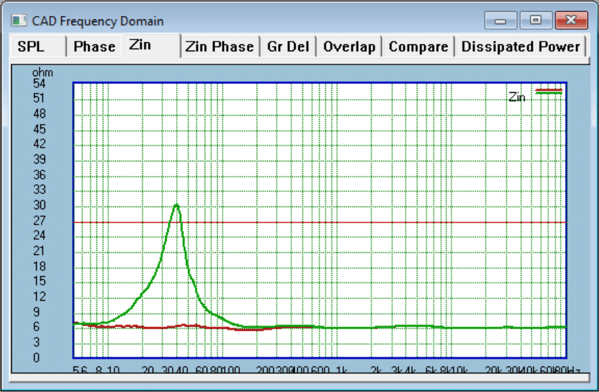

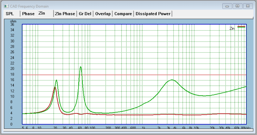

1. The "EMF-derived distortion" mainly shows up as inductance above a few hundred Hertz. Make the driver better by reducing the internal inductance of the driver and then add the necessary external inductor. So if the driver inductance is 0.2mH and we add a 0.4mH inductor externally, then we have achieved the same reduction of -6dB that Esa uses his example. But the distortion is reduced further because by 10KHz the non-linear inductance can drop down to 30-50% compared to 1KHz. Now we have reduced distortion even further and -12dB on average.
A SINGLE INDUCTOR CAN GIVE YOU THE SAME ADVANTAGE AS CURRENT-DRIVE!
Can anybody here understand what I am saying? Be clever and you do not need a current-drive at all.
2. Make the driver have a constant and stable inductance. This is what Purifi does. The better the driver and the less "EMF-derived distortion."
3. Combine 1 & 2 above, and that is what the Purifi ULD plus Elsinores does.
4. The use of line sources can be used as well. Note the Elsinores have four series-parallel drivers below 500 Hertz and series drivers above that. A reduction in excursion is desirable to reduce "EMF-derived distortion."

Indeed all amplifiers can be modeled this way:
Yes, all amplifiers can be modeled this way, as a voltage source followed by a series impedance.
The voltage source, it will be zero.
The current source, it will be infinity.
With tube amplifiers, it will have a value typically up to 5 Ohm, sometimes more.

Feedback here is feeding back because the amplifier is distorting and corrupting the current. Not like feedback in an amplifier. The messy aspect is that it circulates and smears out in time. He uses complicated language, but once the mechanism he describes is understood, it changes everything and cannot be unlearned. It also highlights another aspect of current distortion, it is time smeared.
The effect he is discussing, it can be measured and what else can you call it but "current distortion."
Note the EMF? That it is a voltage? Remember this:
All the bad stuff mentioned by Esa above, ends up in Part B above, causing it to moderate the entire impedance because it is in series with Re and causes corrupt current. So Part A + Part B is not a stable impedance and hence unstable current that reverberates around like 'feeding back and forth.'

Though of damping for my part was based on observation that if you take naked speaker driver on your lap, that is not connected to anything, and push the cone with your hand you can pretty much make the cone move but short its terminals you now need to push it harder as something resists the movement. I've reasoned this is because current can flow in the (short) circuit and magnetic field develops to resists the movement, damps it. This is due to voltage developing due to coil moving inside magnetic field, and shorting the terminals allows current to flow through relatively low (total) impedance and strong magnetic field develops as result resisting the movement. Isn't this basic thing, connect the bicycle magneto to the rim and you've got light but the dang magneto makes you do more work :)
Oh dear, I have come across this explanation before, several times.
1. The result is correct!
2. But the interpretation is wrong. Sorry!
We are talking about electrical damping, right? That is defined by this Qes equation:
Qes = (2Pi*Fs*Mms*Re)/(B*L^2)
Note Re and the relationship with Qes is critical. The higher Qes is, the less damping. The Re is the total resistance (which is an impedance) in the entire loop.
In your example, that last bit has been ignored. The default of the driver is not an open circuit and that is how you have presented it. All you have done is proved that electrical damping disappears when the voice coil is open circuit.
Let us say that Qes = 0.5 and the Re is 6R DC resistance of the voice coil. If that Re is increased by 10% to 6.6R, then the Qes will also increase by 10% and become 0.55, then if the increase were 20% then we would have 0.6, and if we doubled Re to 12R, then Qes = 1. Twice that of the original Q
So one changes the other proportionally by the same percentage. But what if we increased Re to infinity?
Then there would be no electrical damping at all, leaving only some mechanical damping left over.
That is what you have done when the voice coil is open circuit and we have now created an infinite impedance and no damping at all.
That equation also demonstrates something else:
ONLY AN AMPLIFIER WITH A NEGATIVE IMPEDANCE CAN IMPROVE DAMPING AND REDUCE QES.
In other words, you need to reduce the value of Re below what the DC resistance of the voice coil value already is.
So any amplifier with any output impedance, voltage or current drive, it does not matter, the amplifier can only decrease damping and the amplifier cannot add damping. It is pure physics.
I repeat: The amplifier cannot add damping
The amplifier can only make damping worse. The best it can do is not make it worse, and then it would need to be zero Ohm. So would cabling and crossover etc.

THE TRICK: MAKE THE AMPLIFIER PRODUCE THE SAME CURRENT AT ALL FREQUENCIES.
Make sure it does that, whether or not a voltage source or current source is needed. The trick is combative with both types of 'drives' and any kind of amplifier.

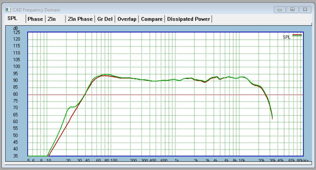

Below is an actual measured impedance after the current had been equalised - EQ the current:
Now it does not matter what the output impedance of the amplifier is, you can even make it infinity. Raising the impedance will have no effect at all on damping. And the physics and reality bear this out. The above is a sealed box tuned at 40Hz and being a Butterworth alignment will be -3dB @ 40Hz and -12dB @ 20 Hertz, one Octave lower.
THE AMPLIFIER NEITHER ADDS NOR SUBTRACTS ANY DAMPING AND IT WILL ALWAYS BE A "BUTTERWORTH" ALIGNMENT.
It can also be done with vented boxes, but the impedance will only be flat down to a certain frequency:

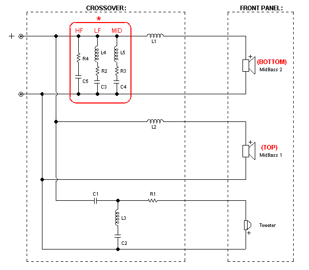

This schematic shows in Red the current EQ used - makes the amplifier produce the same current down to the lowest possible frequency:
The above box is vented and tuned to around 38 Hertz. But even the lower peak is reduced in amplitude and frequency.
Let us know compare voltage source versus current source:
The slight deviation near 25 Hertz is near 30dB down and all that will do is reduce max power handling by a little bit.
BTW, the above is not the Elsinores but another design that I have done for more commercial reasons, but the Elsinores are also designed this way.
Hope the above has some clarity.

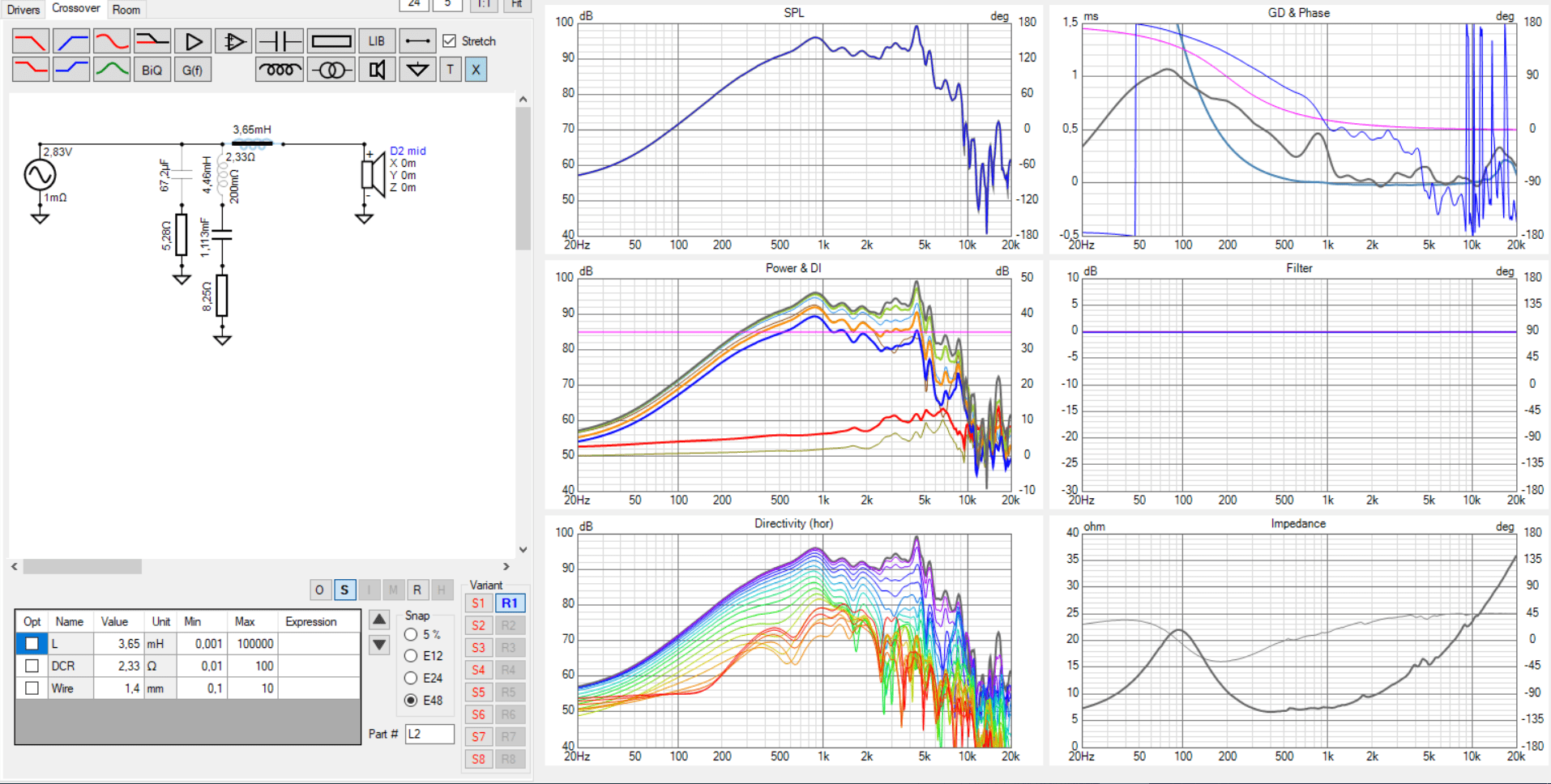

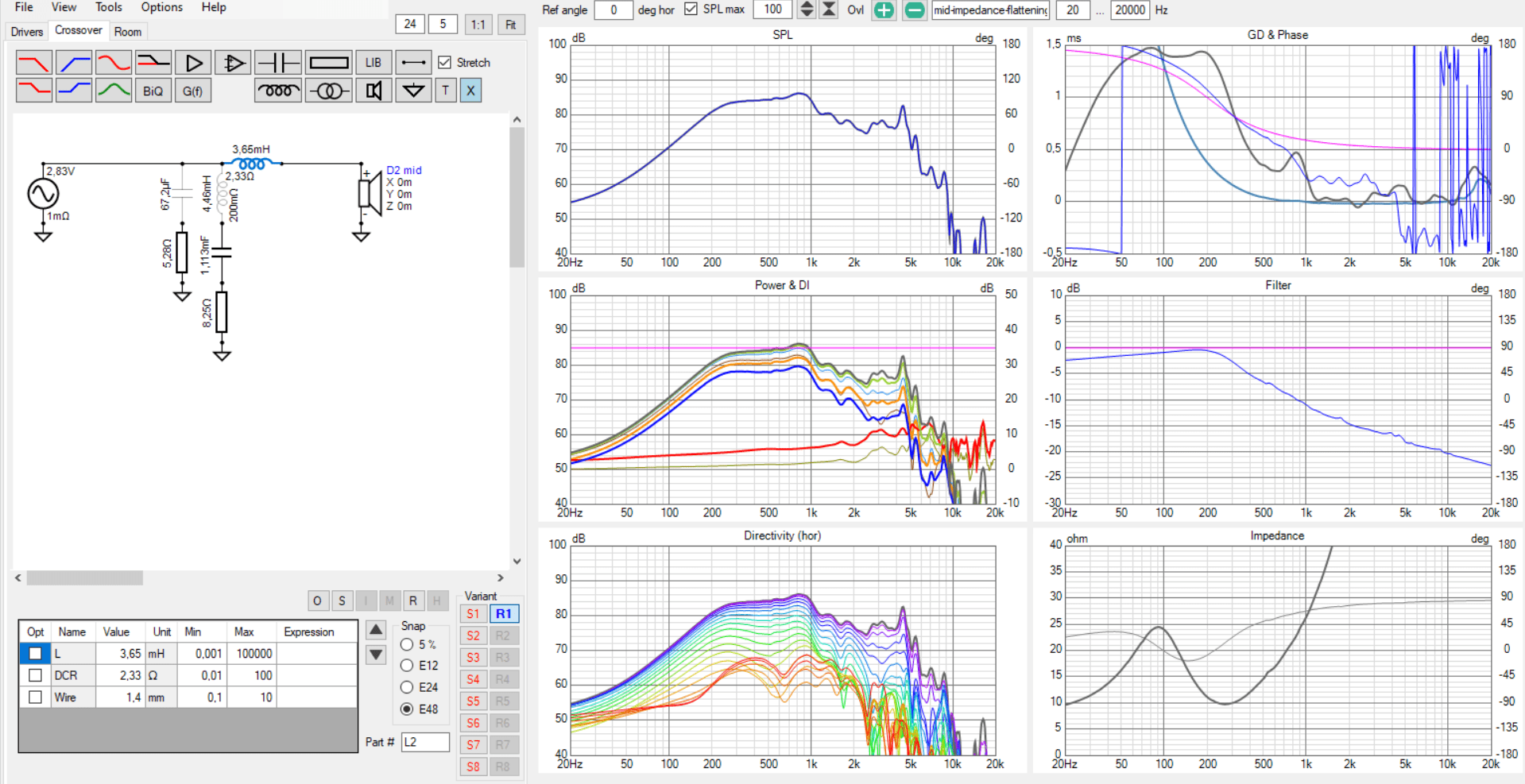

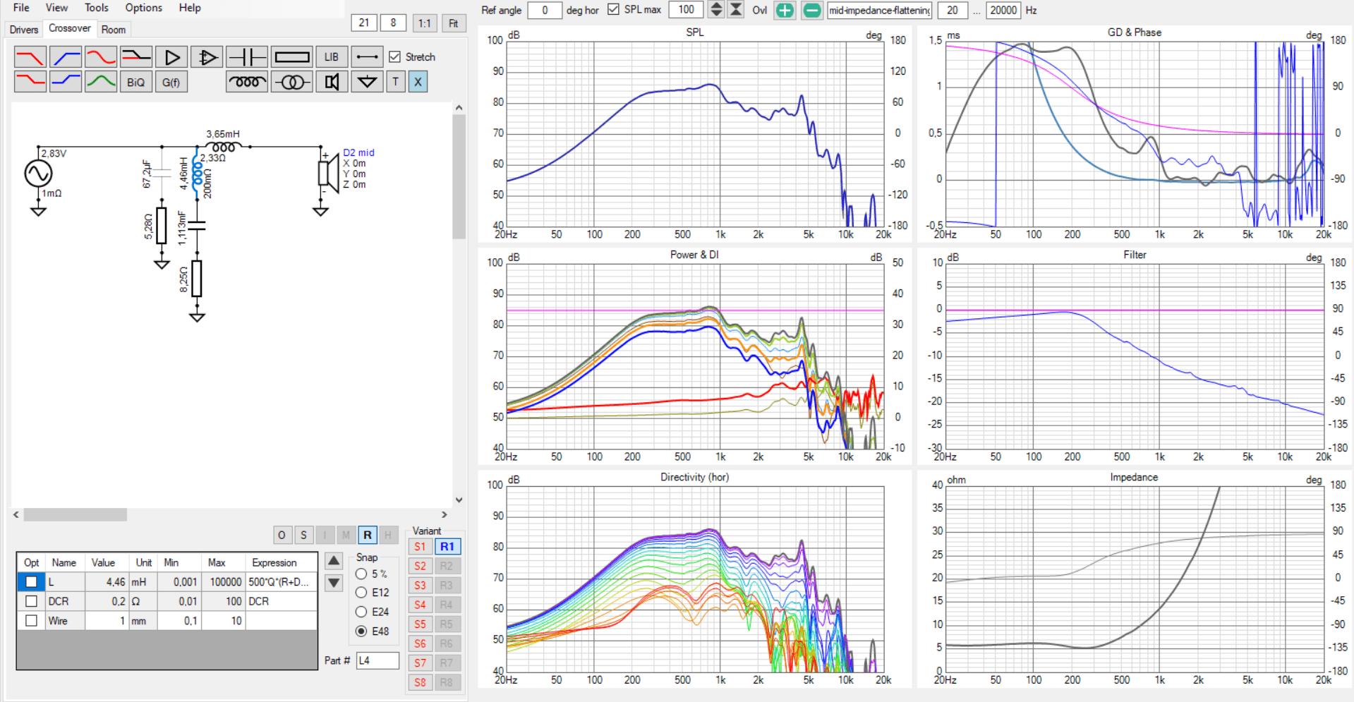

Here is quick illustration what zobel and series notch to equalize the impedance does for midrange driver I happen to have measurements for. Simlar thing as you have illustrated (for low woofers) in post #4894. Amplifier load impedance is pretty much flattened given that I didn't use too much time tuning it.
If we use same trick as is used here on this Purifi paper https://purifi-audio.com/wp-content/uploads/2022/03/220211_R05-Notchfilter.pdf to check out what the impedance is for the driver, driver as source. In VituixCAD we just move the voltage source in place of the driver and make short on where the driver was, kind of emulating very low voltage amplifier output impedance + the network as load for the driver. We see the impedance seen by driver is very low on low frequencies and electronic damping happens for the woofers response because current can flow quite nicely between the driver terminals making the magnetic damping happen for driver resonance, while impedance shoots up on midrange and reduces current there, for reduced current distortion.
Sorry had to run earlier middle of posting the previous so, here for completeness sake raw response

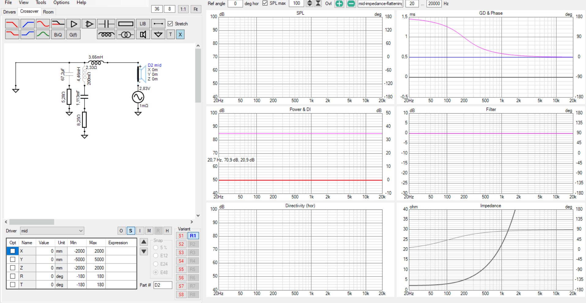

Series inductor only, and view from the drivers perspective

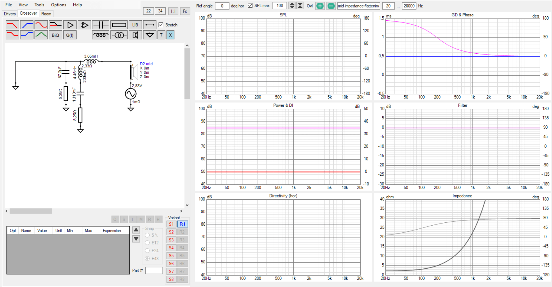

And then the impedance EQ, notch and zobel. These seem to affect only the amplifier load impedance, nothing happens for response or impedance seen by the driver.
All combined was on the previous post. Don't mind the response, its quick one to demonstrate impedance from drivers perspective, to estimate current generated by driver.
