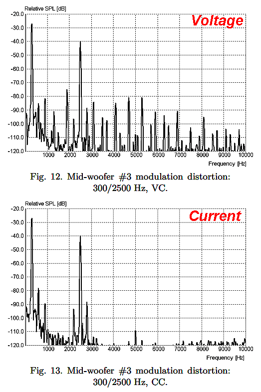

Experiments done by me and others don't show current drive to produce less distortion per se.

I have been thinking about answering the point you made and perhaps a bit late as it is now days ago since you said the above.
I am glad that you have done those tests yourself and that you found it produces produces lower distortion. There are now a number of examples that have been posted on the internet. Pavel (PMA) has and I tried making an approach, but he knocked me back. I don't doubt the measurements, but I doubt the interpretations.
We agree that the differences are definitely there. But what is this lower distortion? Or maybe we are looking at it the wrong way around?
Sometimes the wrong questions are asked and then nobody asks the right question?
This has reverberated in my head for more than ten years. Will we ever make progress? Do you that we often have to get things down to the most basics, which I did. The it dawned on me, read the next sentence very carefully, please.
What will show we are making the correct progress? Here I want to make a point that requires a LOT of lateral thinking:
This is what hit me:
We know we are making real progress when we get the same or near low distortion with both current and voltage drive.
Please, think about it.
We need the same low distortion from voltage drive that we can get from current drive.

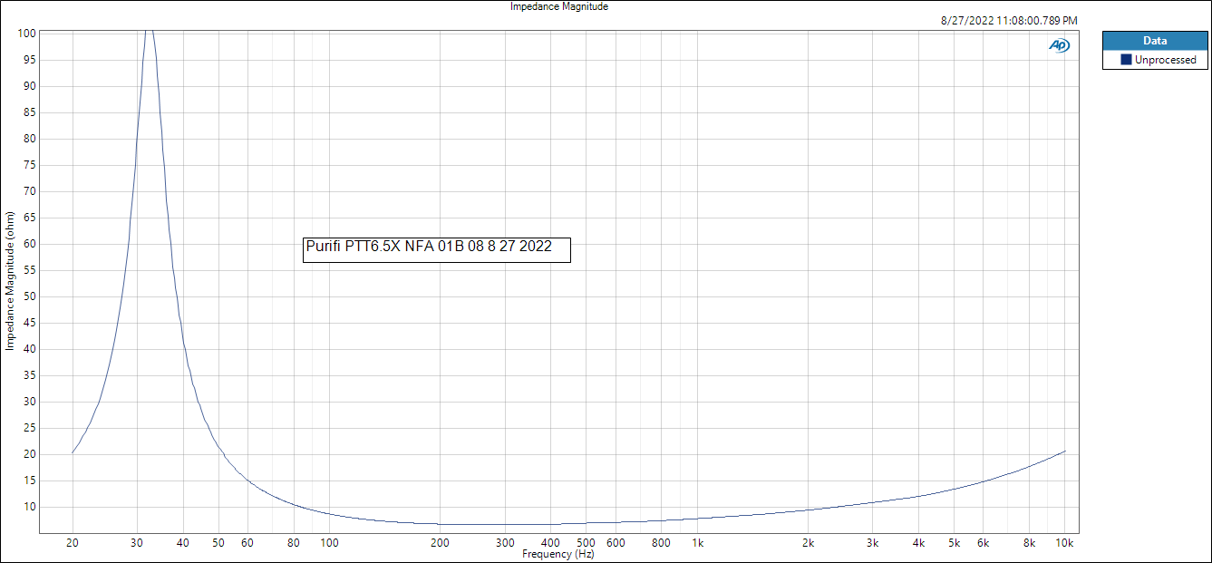

What driver are you speaking of? Where is the data?
Are talking about your new reference driver or a Purifi driver?

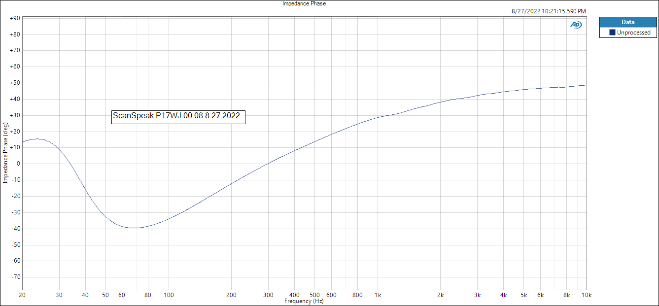

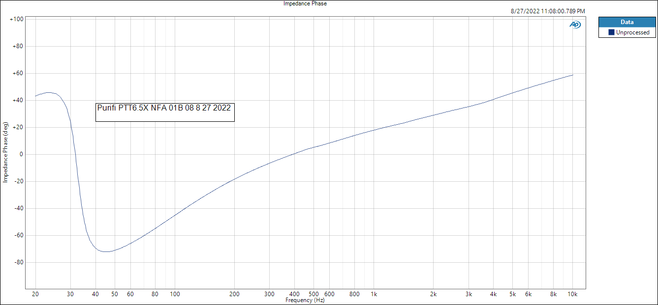

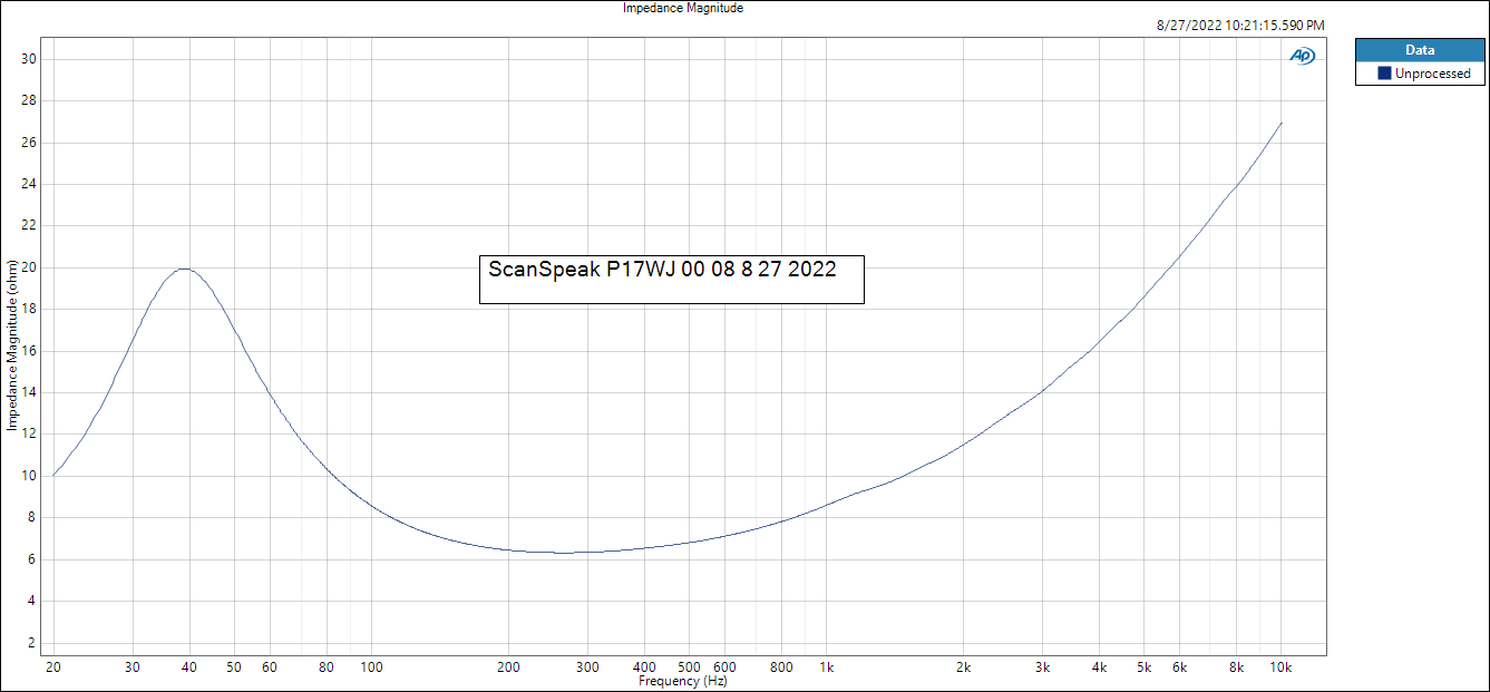

For grins here are impedance and phase plots for the Scanspeak and Purifi drivers. At 2 volts input.

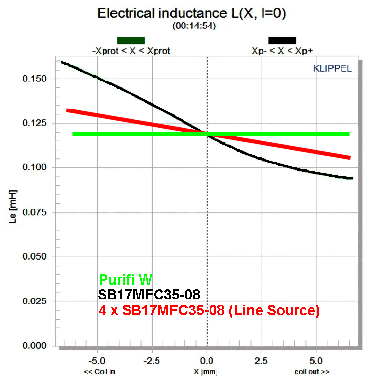

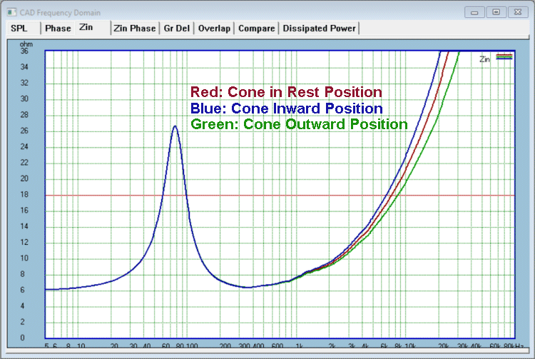

Again, look at the Elsinore design. I have listed six things about the design that gives me what?
LOWER DISTORTION!
That is what I want. That is the only question and not endless theory.

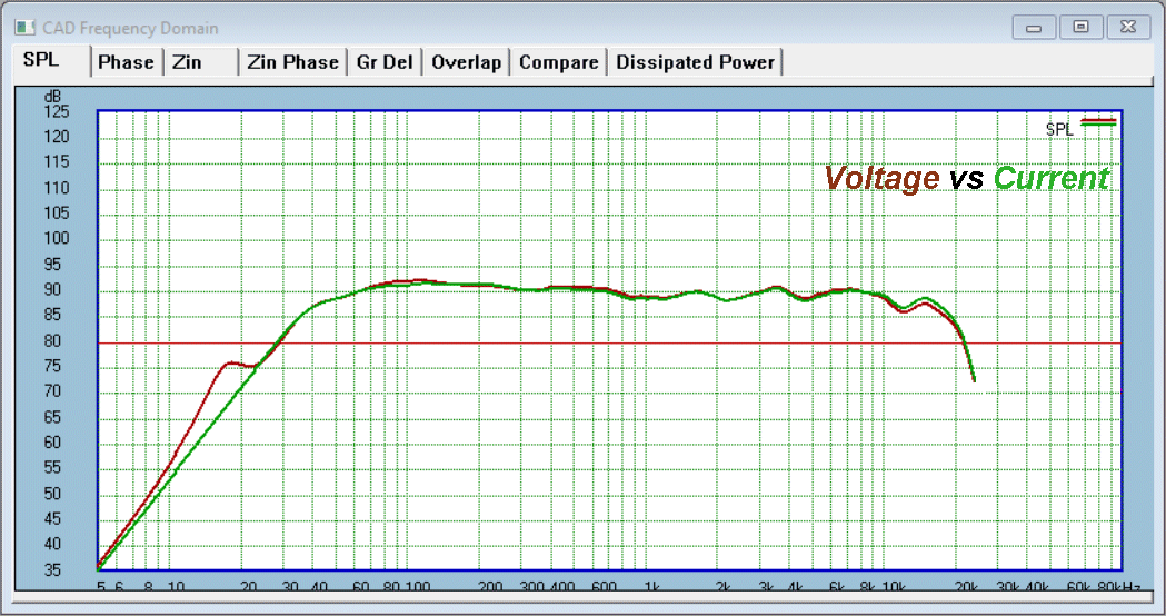

Yes, the Elsinores sound always more like current drive even when the amplifier is a voltage source. On top of that, even if you insist on current drive, they will work with them as well. They will work with any amplifier and I have posted that proof many times:
ABOVE: ELSINORE ULD 15° OFF AXIS
And it is all to do with those six things I have listed. Practical outcomes, solutions that work, not news, not olds, not whatever that is supposed to mean (nothing really).
Below I have reposted what they are:
1. Select the right driver(s). Forget current-drive making it better, even current-drive cannot do that.
2. If available, use multiple drivers to reduce excursions. At mid frequencies, cone motion is a problem with most drivers, and using multiple drivers gives you a potential advantage and hence lower distortion.
ABOVE: ELSINORE LF LINE SOURCE GETS CLOSER TO PURIFI.
3. Equalise, or EQ the current and make the load virtually non-reactive and look like a resistor. The current phase angle will always be near zero.
4. On the low-pass filter add an external inductor to reduce/Stabilise impedance/current modulations. If you add three times the inductance, you can get major stabilising of the inductive impedance shown below and lowers distortion.
ABOVE: IMPEDANCE IS NOT STABLE, EVEN IF WE THINK IT IS, AND CAUSE CURRENT MODULATIONS IN THE AMPLIFIER = DISTORTION.

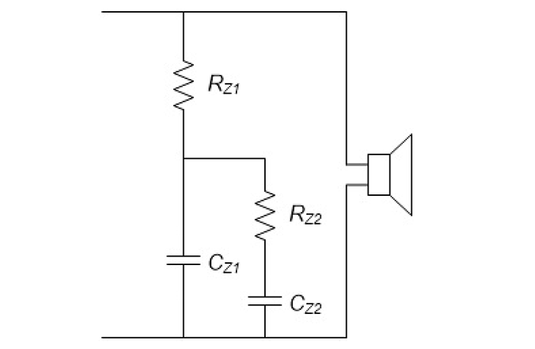

If you are looking for practical solutions to reducing and testing distortion in your Scanspeak reference driver consider this impedance compensation. Amplifiers and crossover networks like flat impedance curves much better (lower distortion).
This graphic was lifted from a 2020 AudioExpress.
https://audioxpress.com/article/voice-coil-lab-notes-improved-zobel-network
The original work was done by W. MARSHALL LEACH, JR. in 2000 and published in an AES paper in 2004.
https://www.aes.org/tmpFiles/elib/20220901/12997.pdf
Things work out better when signal levels are kept Small. Crank things up and variable BL and Le become problematic.

The Marshall Leach solution I offered up a couple of posts ago is a couple of capacitors and resistors that make a Zobel that is in parallel with the resistive inductive driver load. The phase angle of the RC Zobel is opposite to the phase angle of the inductive driver load. This is very much like your local power utility switching in a bank of capacitors for power factor correction.
Marshall Leach calculated the 2 capacitor + 2 resistor Zobel to flatten the impedance curve of the resistor + inductor load of the driver. The impedance curve ends up being pretty much flat.

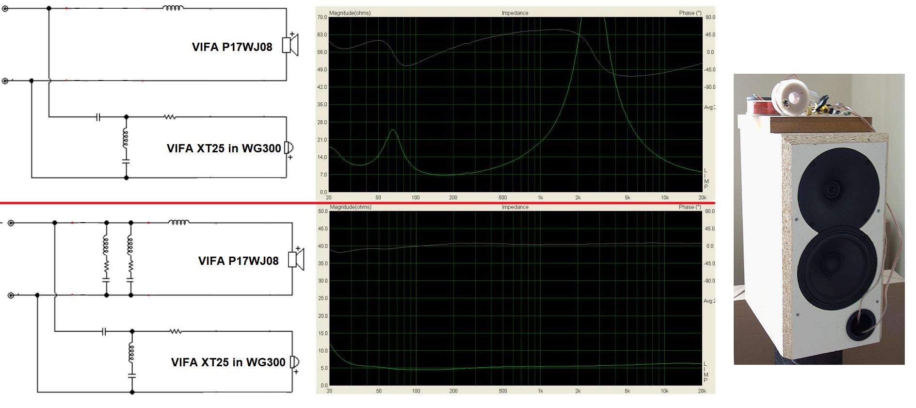

Coincidentally, I'm tuning a speaker crossover with a VIFA 17PWJ08. I'm reading a claim from Joe Rasmussen here about increasing distortion in voltage amplifiers due to load impedance swings. I was always mainly interested in practice, what I hear or don't hear. That some measurement will show a difference is one thing, what the ear perceives and the brain is another and more important thing. So I decided to do a listening test of the effect of including compensation, I have a transistor amplifier. The imbalance without compensation is really big with my speakers, the maximum of 2.8kHz is over 100 Ohm. The crossover is located on the cabinet, so it is easy to quickly engage and disengage the compensations. I noticed only a small change in the sound, with the compensations the micro-detail decreased a bit, the experience became darker. The difference is really small. I hear a much bigger change in sound when I change the power cable to the amplifier.
When using an amplifier with a high output impedance (tubes), the compensation of the speaker impedance is good, but there is a significant effect on the frequency response, and this makes more audible differences in speakers with unbalanced impedance, such as my case. I'm sorry for my bad English.
No, that is incorrect, I think you have misuderstood something.
Indeed I have a pair of Vifa drivers here and they are an example of a driver I do not want to use for design purposes. To me it is a reference for what I do not want a driver to do. Yeah, I know, it's complicated. I use it to measure distortion in amplifiers on the current side. I want an imperfect driver for that. I am not going to use it in a project. To me it is a reference driver.
But I don't want to discourage, good to see hands-on DIY.
Did you also measure frequency response? The change you heard was most probable due to a slight FR change.Coincidentally, I'm tuning a speaker crossover with a VIFA 17PWJ08. I'm reading a claim from Joe Rasmussen here about increasing distortion in voltage amplifiers due to load impedance swings. I was always mainly interested in practice, what I hear or don't hear. That some measurement will show a difference is one thing, what the ear perceives and the brain is another and more important thing. So I decided to do a listening test of the effect of including compensation, I have a transistor amplifier. The imbalance without compensation is really big with my speakers, the maximum of 2.8kHz is over 100 Ohm. The crossover is located on the cabinet, so it is easy to quickly engage and disengage the compensations. I noticed only a small change in the sound, with the compensations the micro-detail decreased a bit, the experience became darker. The difference is really small. I hear a much bigger change in sound when I change the power cable to the amplifier.
