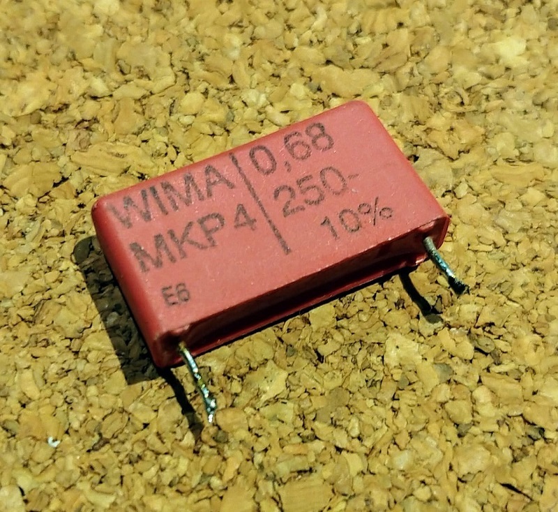

Cap for C5
Joe,
C5 cap value for the Elsinore MK6 is 0.68 uF and your comment is "Use decent quality PP X2 type ok".
I have attached a picture of a 250V Wima MKP cap - will this work for C5 or you advise something else?
- Z

Joe,
- Z
That is just fine. The PP X2 may just be easier for some to source as they are used as suppressor capacitors.

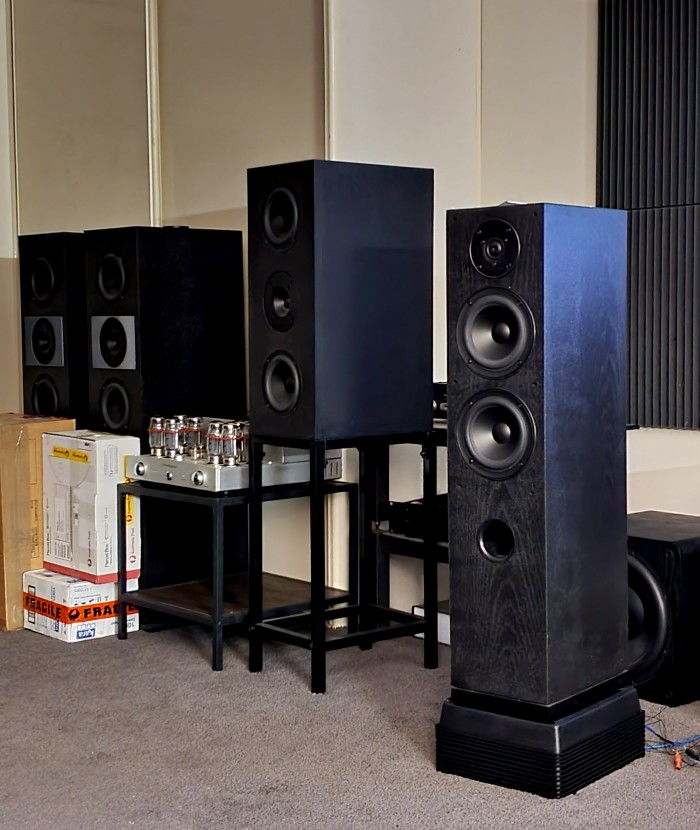

See the pic attached below. You can see the Elsinores which are Mk-3 boxes converted to Mk-6, the one of the Hamlets and finally an experimental 2-1/2 Way floor stander. Note how the box is elevated? This is because the tweeter actually needs to be set back 5 degrees (about 12mm), so to offset that, I had to raise the speaker temporarily so as to listen on the axis of the middle (midrange) driver. The front panel could have been slanted 5 degrees and then put back on the floor and listen at the height of the tweeter.
This is basically all you can do with the type of crossover used: Low 1st order but one that does NOT sum like a Butterworth (-3dB and significant loping), but 100% vector summing where you need it (-6dB and loping is not audible). The speaker is fairly tolerant to loping.
I will post some RTA measurements later. The area affected is just the area above the crossover as will be shown. These are actual measurements and not simulated.
As for the Elsinores, the situation is slightly different, here we have something more akin to a focussed array and both vertically and horizontally are symmetrical. Next time I have a pair in the system, I will do the same, but suffice to say that they are even better. The same applies to the Hamlets.

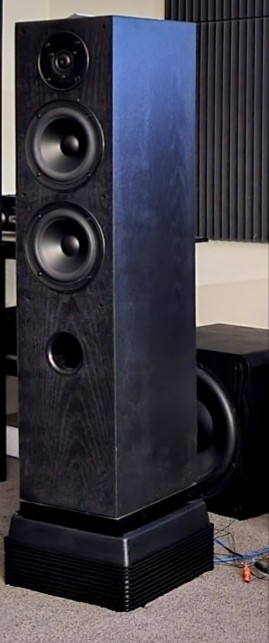

"experimental 2-1/2 Way floor stander."
i'm shocked to see you erperimental image, is it SB29RDC? i noticed the dimple tweeter
do you mind to share this experimental result for the crossover? I'd like to build it as my Elsinore alternative. not expecting a fully tested like Elsinore but this is something I can afford for the tweeter.
well hamlet i can build it for my 5 channel HT, might not need the extra 2 lower woofer for the bass because i already have 2 sealed subwoofer

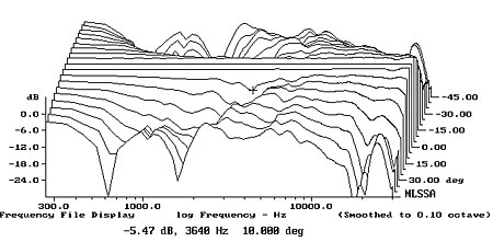

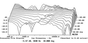

I'd still be interested to know or see a vertical plot.
I have also had speakers where you could hear lobing in the vertical response from seated to standing - I was really not keen - just want to make sure I'm committing to the right speaker before investing in a build.
Below is Lipinski's vertical's taken by JA which are similar except that Joe's crossover is a bit higher and his drivers are a bit further apart (..which means the dip off-axis will be more pronounced and likely starting higher in freq.)
My guess is that you still have at least 10 degrees vertical before any difference and perhaps 20 degrees where you start into a moderately narrow-band -6db dip.
If you are particularly sensitive to this sort of result (and can't stay far enough away from them or listen within that vertical window) then I'd look elsewhere. 😱
Reactions: stretchneck
Yes that is the tweeter and with the right crossover is not at all bad for a cheapie tweeter, most of which are to be avoided. That 2-1/2 Way is built into a pair of boxes that I acquired for free, but this is not ready to be published and at this stage there are no plans to develop it. Like I said, it is experimental.

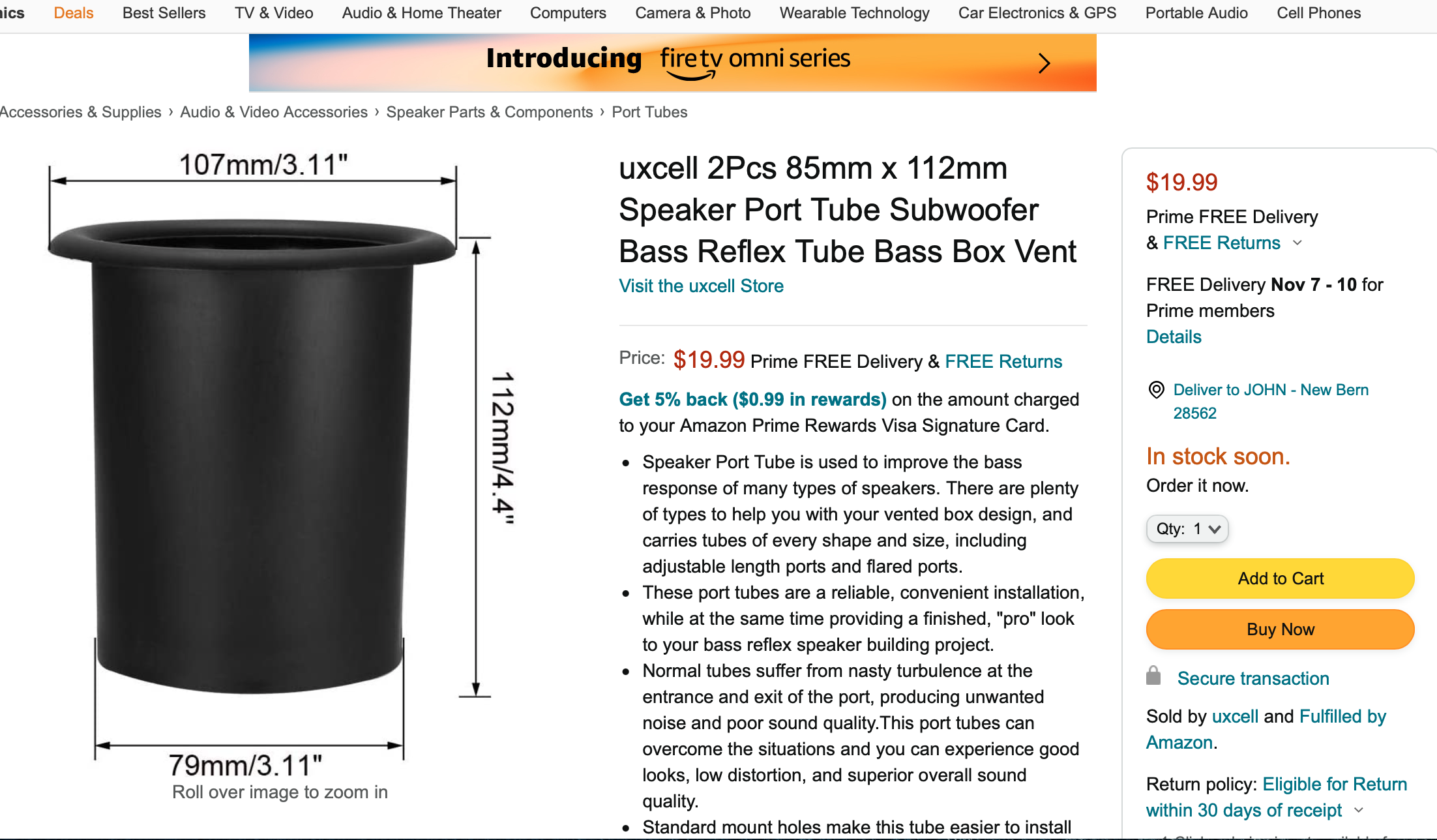

Port tube dimensions -- hard to find size -- HELP
Hey Joe,
I'm gathering parts for my Elsinore build and I've sourced everything except the port tubes. I'm having a hard time finding the correct size here in the US.
You specify 90mm dia x 100mm L with inside dia of 86mm.
The closest I can find is a set from Amazon that are tapered a bit:
Specification:
Mouting Diameter:85mm/3.34inches
Total Length:112mm/4.4inches
One End Diameter:107mm/3.11inches
The other end Diameter:79mm/3.11inches
Package Content:
2x Speaker Port Tube
Will these work? If not, do you or any DIY Audio member have a suggested source?
Thanks,
HappyJack
