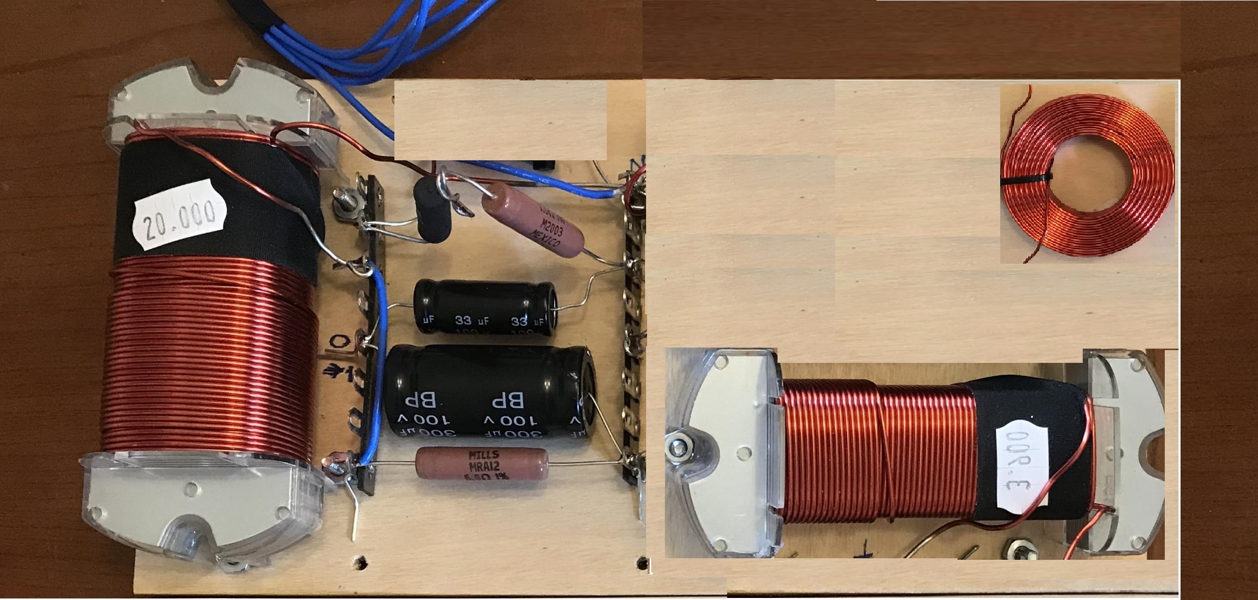

Try to rearrange the inductors so that they are perpendicular to each other. As it is, you will get a lot if crosstalk between them.Finally making some progress on my Elsinores. Crossovers finished today and only one coat of paint left! 🙂
Thanks for the input and tip! Unless it's obvious, the two boards for each speaker will not be close to each other, so I assume you're talking about the two magnetic core and tiny air core inductors on the boards in the top of the picture. For some reason I had thought that I had read that the magnetic core inductors wouldn't be a problem in the current config. Should one of these be perpendicular to the other? May have to rethink this as there won't be enough room at the base of the speaker where I was going to attach this board.
That's a good catch by mbrennwa.

Here you go with a mock up of what mbrennwa is suggesting if I have understood correctly.
I have taken the liberty to elongate your XO board - hope that will still allow for suitable placement.

Thanks zman01. I thought he might have meant something like that. Space will be an issue for sure. Maybe I can try and get one of those large inductors standing up or move somewhere else with extensions.
Thanks, I had seen those but stupidly thought that The two large inductors would somehow not be affected. Maybe it was wishful thinking in order to keep a small sized board. Back to the drawing board.

Taking another look at the Troels coil placement picture in the link above. The two larger inductors on my board are around 14cm apart so it seems that I'm somewhere between the 1st and 2nd image (somewhere between problematic and good). Maybe if I push them out another few cm to the edge of the board and I'll be ok?
Want a tip to know how to do it?
1/Just remember to never get their axial line to cross together and you're good (this is ensures that mag flux from one coil never enters the other coil's winding).
2/ keep them 10cm+ apart (this is for leaking flux of one coil to be really weak when reaching the other coil...)

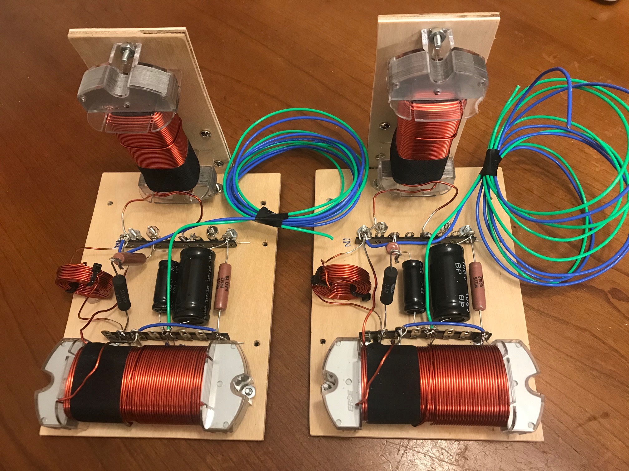

Thanks everyone for your very helpful comments. I have rearranged the layout and I think I'm no longer disobeying any of the inductor placement rules (fingers crossed).
Ehmm... I think you still have at one place: magnetic coupling could be made weaker between the front inductor and the small round one standing on its side at the left on the picture... but I may be picky about its effect here...

Looks good to me!

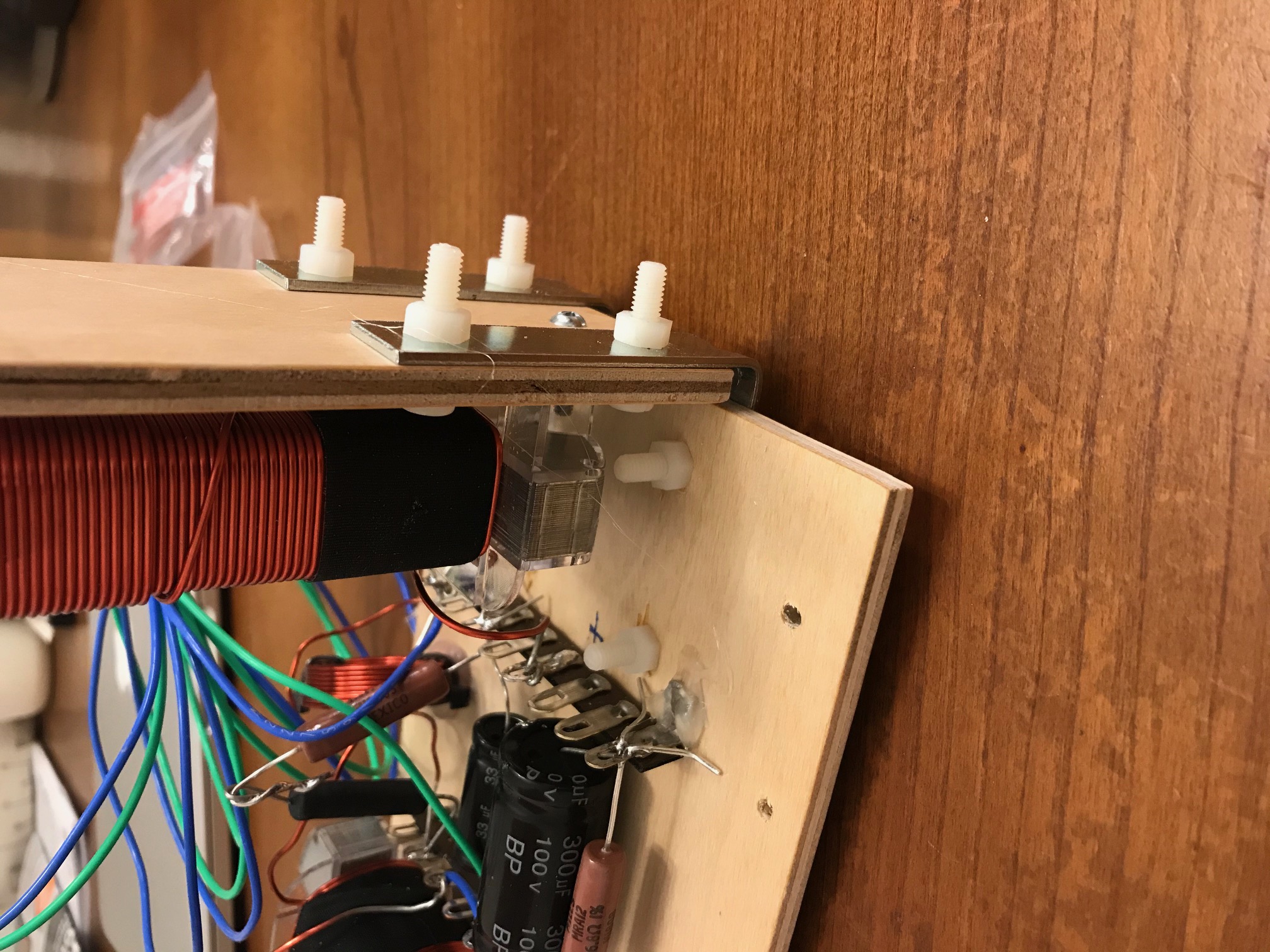

Ah, I never thought of the screws!
No more metal screws, replaced with nylon screws. Speaking of metal, I may now have another problem. The corner brackets that are holding the inductor vertical. According to the packaging they are made out of zinc. Do I need to cut off an inch or so of the bracket?
Just theorising here, but non-magnetic metals in proximity of an inductor have been shown to pass a current, and that current produces a magnetic field. On the other hand that doesn't mean this interaction is necessarily non-linear, like saturation can be.
..Speaking of metal, I may now have another problem. The corner brackets that are holding the inductor vertical. According to the packaging they are made out of zinc. Do I need to cut off an inch or so of the bracket?
Chances are they are Zinc PLATED. So again, likely steel. (..basically a poor man's stainless steel because Zinc is a rust inhibitor.)
It really depends on the amount of interaction.. same for the screws, but note that the plates are further from the inductor and behind the hdf board, not right up against the inductor like the screws were.
Also the little Inductor just needs to be turned 90 degrees.

If I turn the little inductor isn't it going to be the same direction as the 20mH iron-core and that's the reason I turned the 4mH vertical?
In terms of resistance, yes, the resistance of the 20mH inductor plus the 6R8 resistor add up to 7.5Ohm as per Joe's recommendation. 🙂
The parts you spec'ed for Pilk are definitely very nice. I was trying to maintain a budget friendly crossover for now.
How would there be a current induced in the metal if its non-magnetic?
I would not care about a piece of non-magnetic metal near the inductors.
