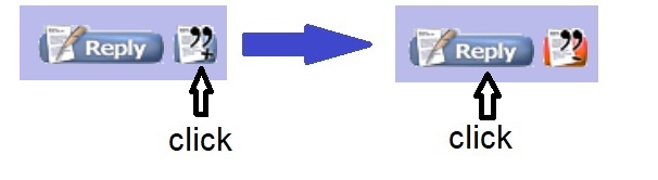

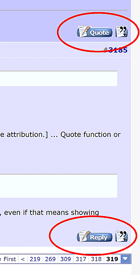

ALSO: For some reason I have no 'Quote' option on the last post, I only get 'Reply' - so please for give me, OK?
That is why I haven't used the Quote option in this reply. Again, why does everything have to be misinterpreted in a negative way? Especially when I don't have the option.
See below - I don't know why it is like that.

Sorry, but I don't have the 'Quote' function on the last post and replying is a problem.

I understand (sorry if I am unable to use 'Quote' option).
Joe,
You should be able to now - please refer to my earlier post on how to do it:
