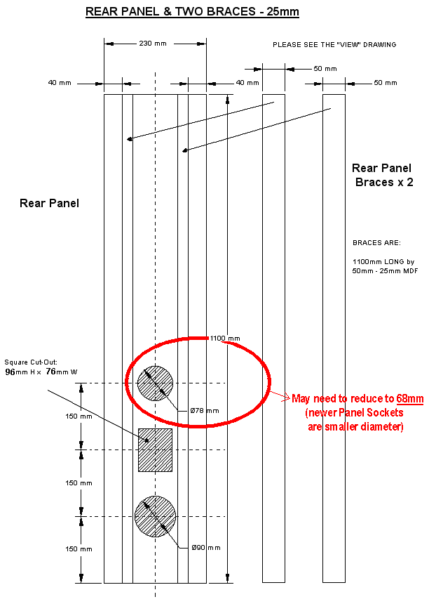

Just an adjustment to one of the drawings on the website, this is the rear panel. The speaker panel that is used for the connection of the tweeter, the current available version has a smaller 68mm diameter, the old one which was 78mm is now hard to get.

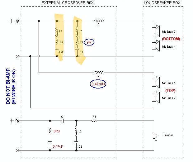

on russian forum i found opinion that if amplifier distortions is independent of the load - chain which is mentioned yellow on the pic can be removed - so they are insisting to try both with and without that chains if u have a good solid amplifier
who tried or have some experience about it
Jabar keep us posted. I think that those circuits are for impedance flattening purposes, very useful for tube amps.
Yes. It is correct. And basically it shouldn't affect the sound. Well, except in the case of tube amplifiers. My amp is very strong. There should be no changes.
And yet something can be heard differently. I'm not sure, but I think the lower midrange is fuller. More tangible.
I guess everyone has to find out for themselves. And evaluate. For the moment I leave the crossover without this correction. I have easy access to the crossover, so let me experiment a little more.
