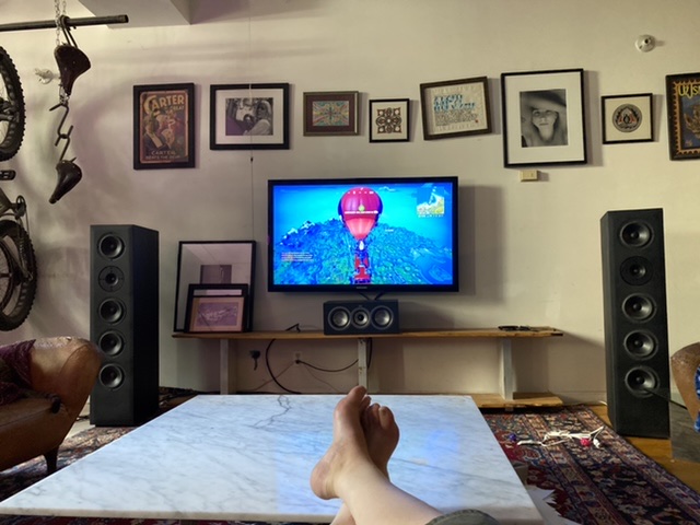

i've had my MKV's running for quite a few years and after a year or so, thought something was off, sound was just a tad fuzzy. took a SUPER close look at CO and found that one of the woofers or midwoofers was wired wrong, threw the whole dang sound off. after that...OMFG, these speakers are fantastic! i think these might be easier than some DIYs o make a little goof. love the pic with the feet up

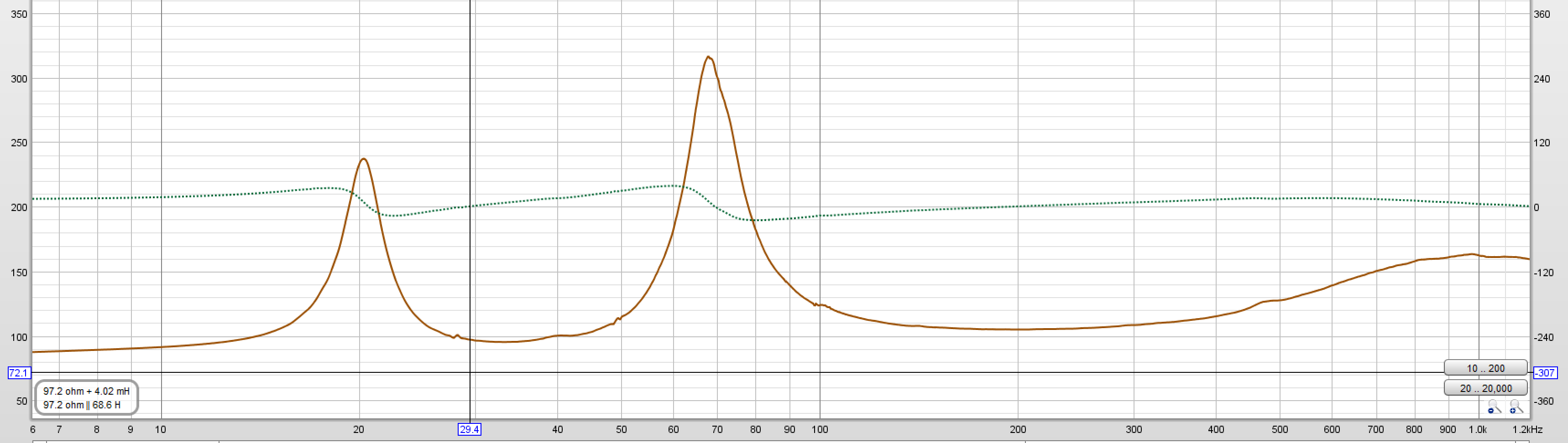

I had to shrink graph from 10Hz to 1kHz so I could upload it...

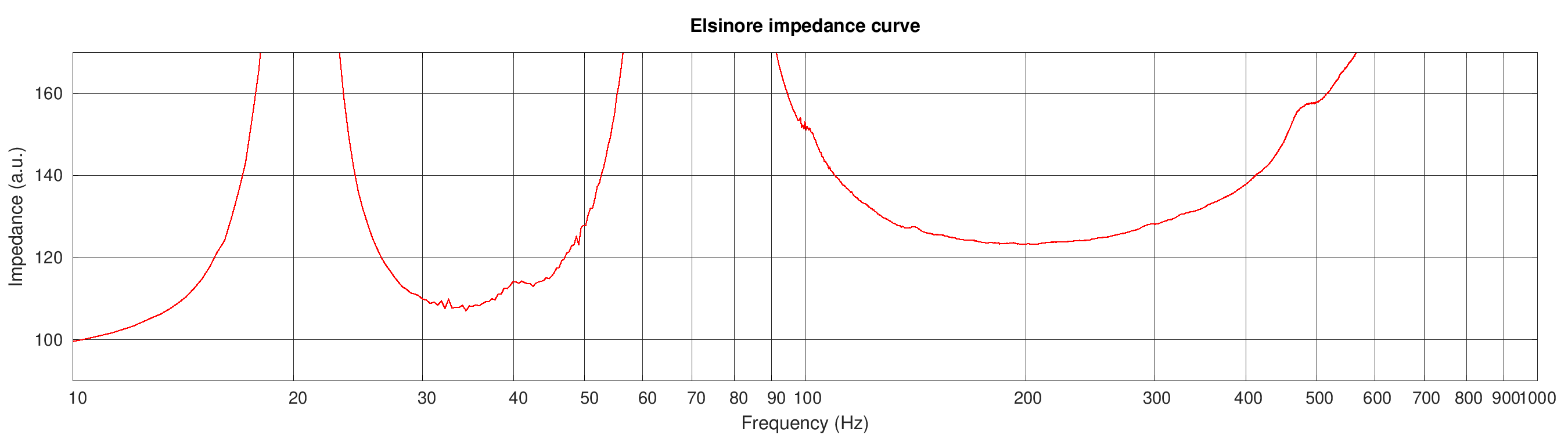

Alright, I made a new plot, zooming in a bit. It looks like the impedance level is not right, but the overall shape looks fine to me. Did you maybe use a different value resistor in the measurement?
Anyways, take a look at the attachment. The minimum between the two bass-reflex peaks is at 34 Hz, so that's the bass-reflex tuning frequency.
There are also some interesting wiggles:
  • At 40 Hz and 110 Hz: I have no idea what this is
  • At 145 Hz, 295 Hz and 470 Hz: These look like the internal standing wave developing along the vertical axis of the box. You might want to try to attenuate these by adding some damping, or maybe an internal Helmholtz resonator stuffed with sound absorbing material.

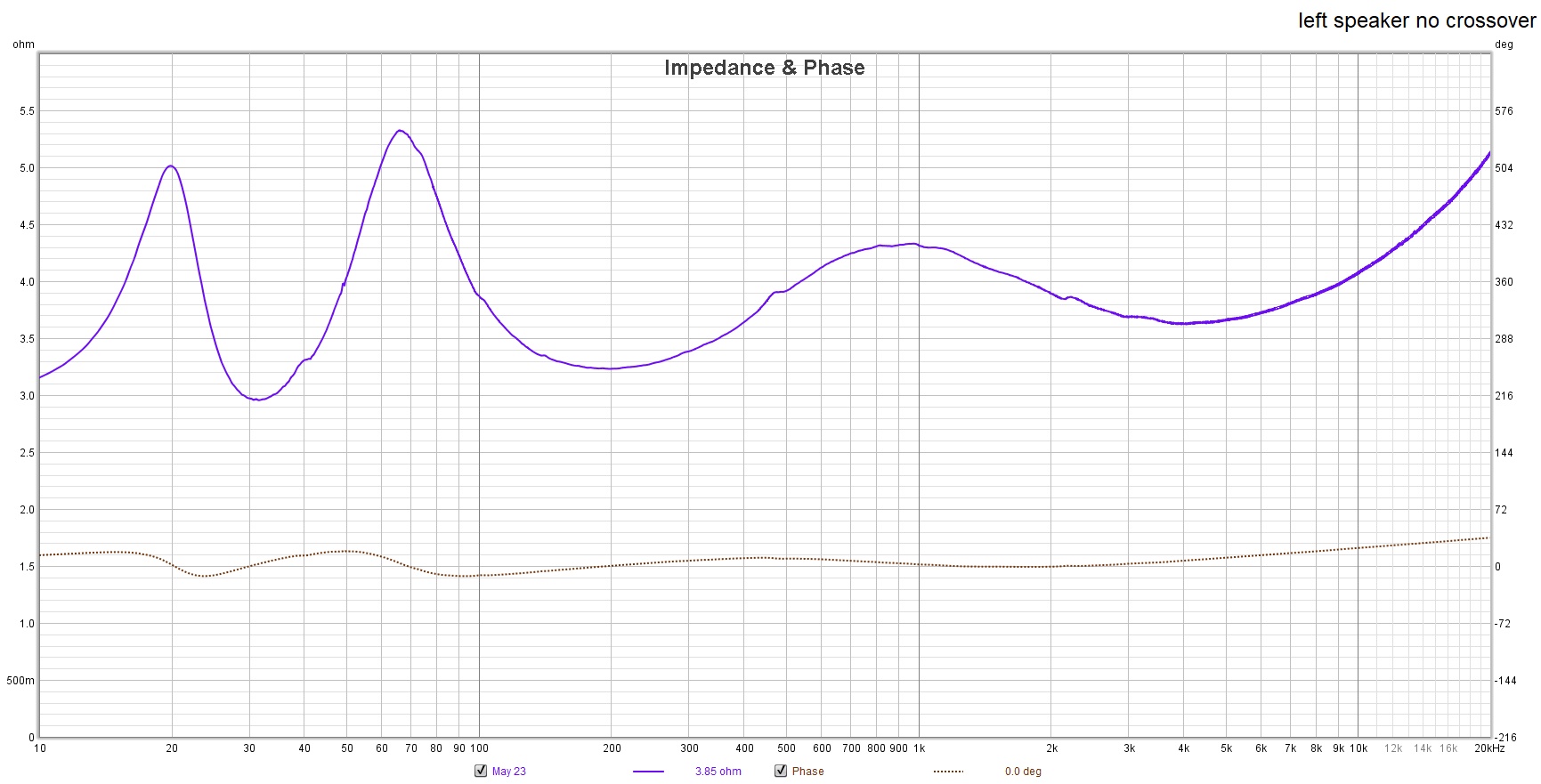

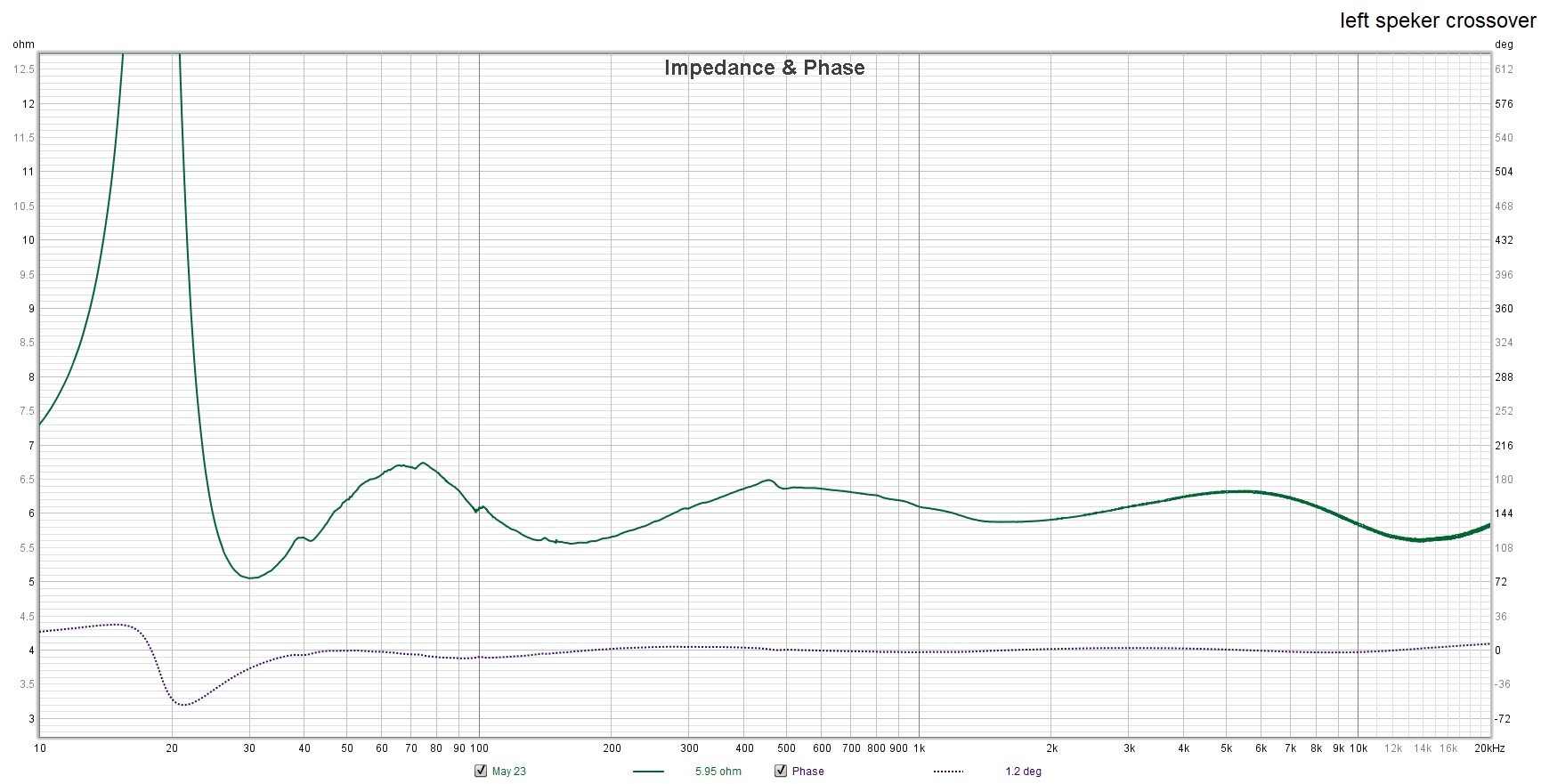

Well finally I was able to tame the measuring device 🙂
Now I have this two measurements with and without crossover. I didnt add the stuffing yet. If I understand those little bumps are standing waves? But other than that do these graphs look like they should? There is some difference in tunning frequency between the two should I tune with or without crossover?
thanks
