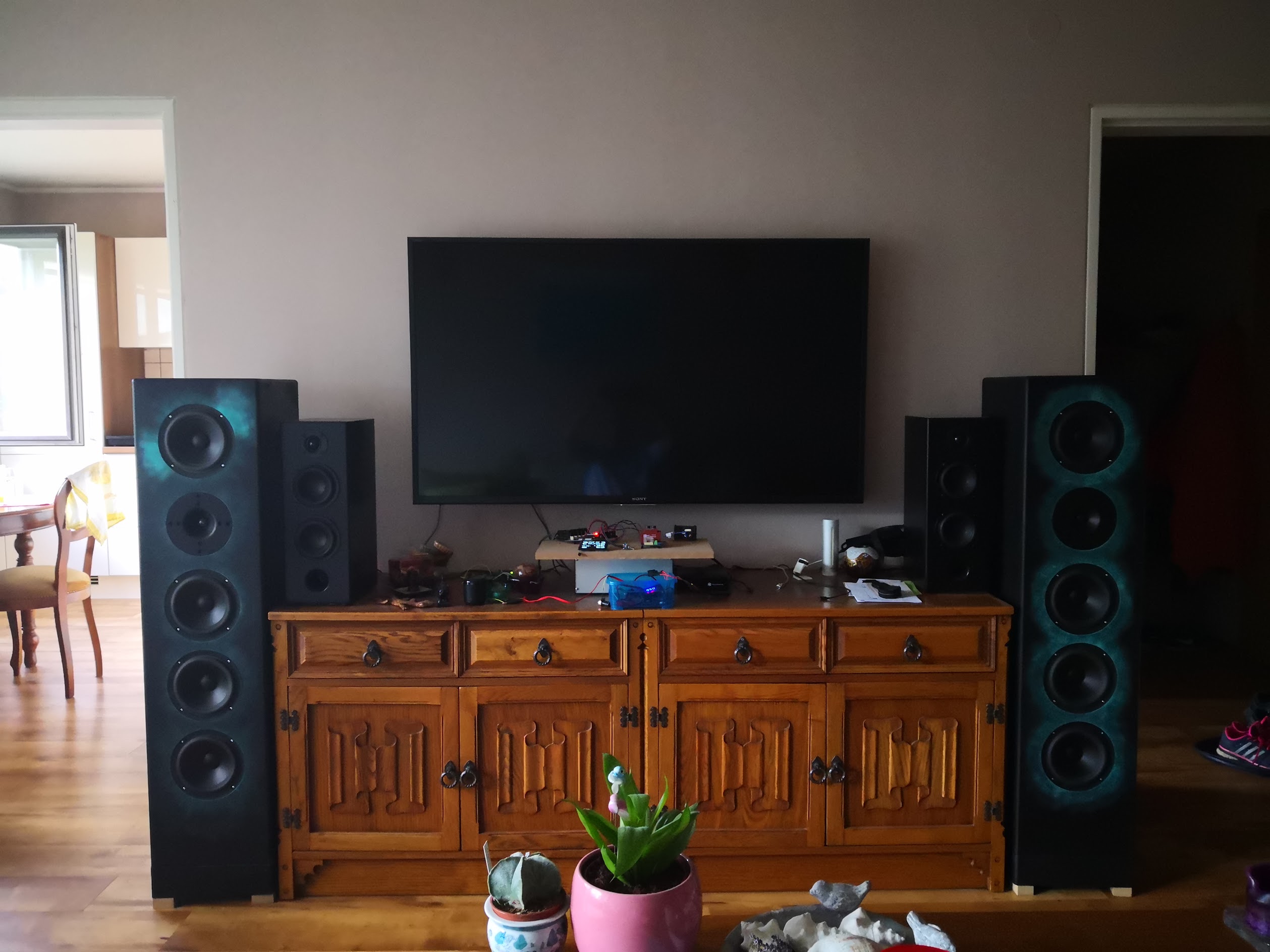

OK, I found the problem, after looking at wiring diagram and my crossover I found I wired zobel the wrong way. Will try to rewire it tomorrow I just want to enjoy the sound coming out without zobel for the rest of today... Thanks Joe for designing this magnificent speakers... Here is a picture of my setup will post some more photos when Im done...

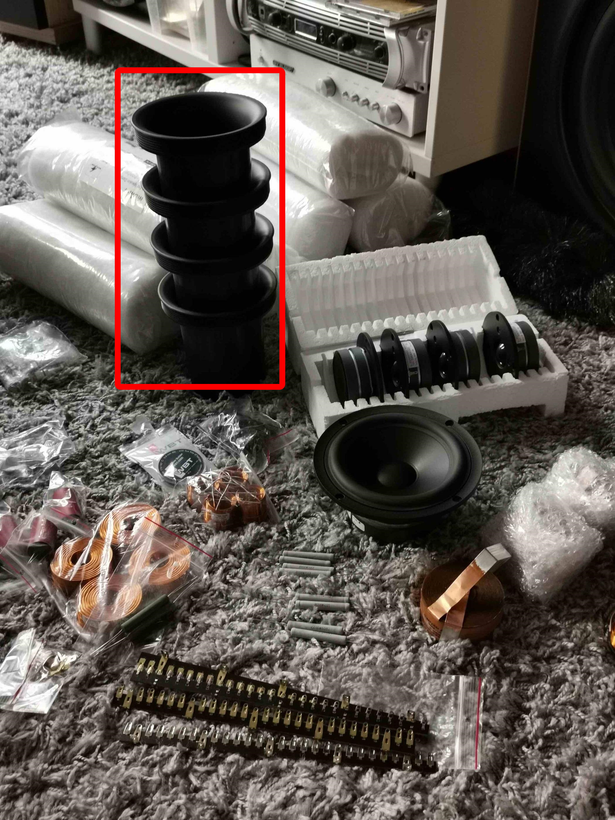

JarBar,
May I know where you bought these speaker port tubes?
Thanks.
