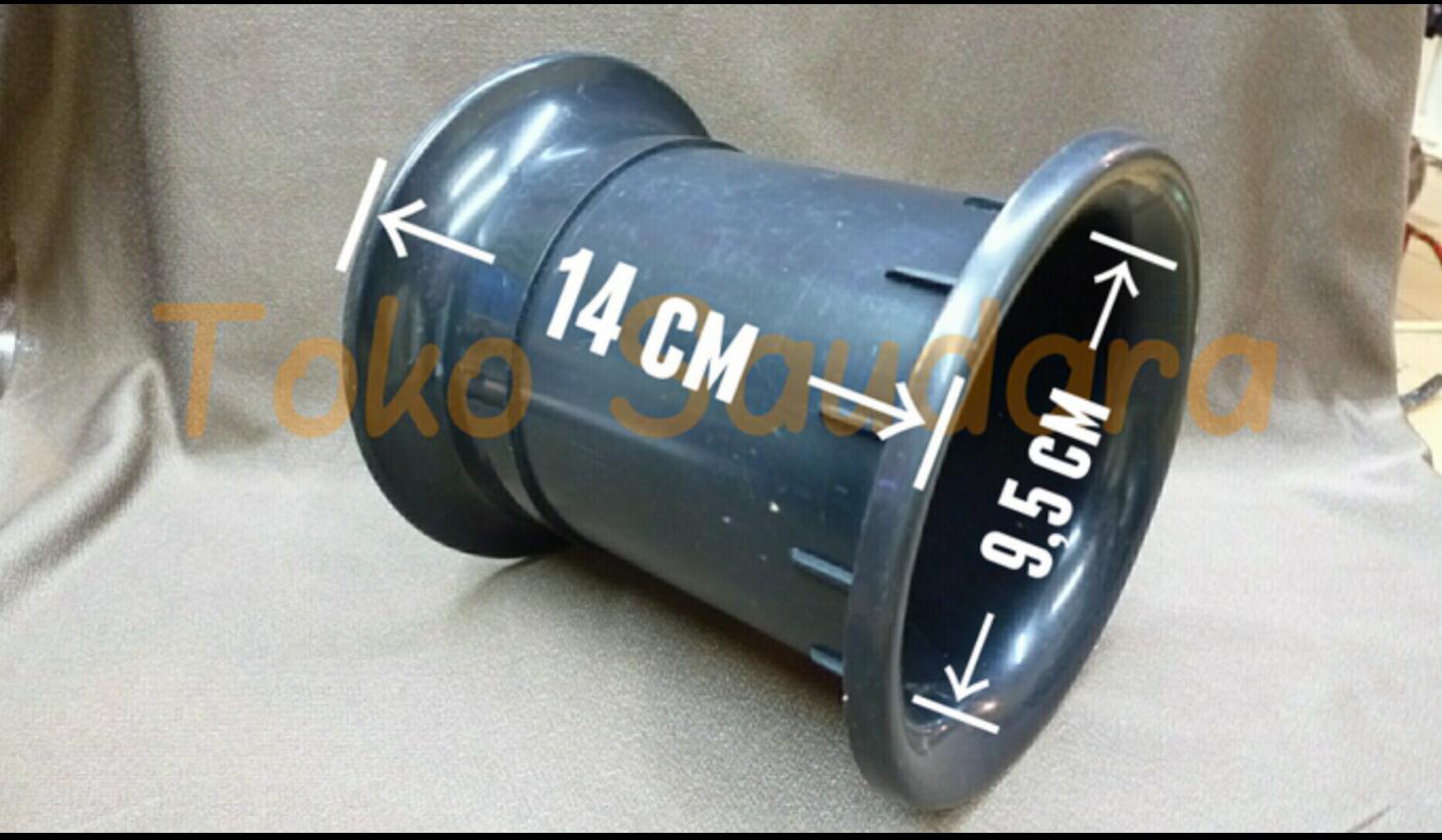

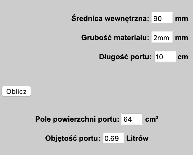

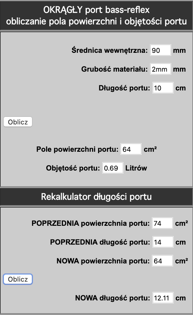

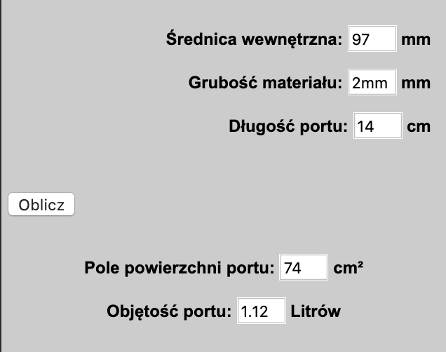

need some insights:
- in Joe's drawing, the port is specified 90mm diameter with 100mm length. if i use below port with 95mm diameter, what is the length required? can i just extrapolate into (90/95)×100 ~ 95mm?
- for bottom port placement, what is the minimum space distance required between the base and port mouth?
According to this calculator and averaging up to 97mm in diameter, the length should be 12cm.
EXCURSION Car Audio - kalkulator portów bass-reflex

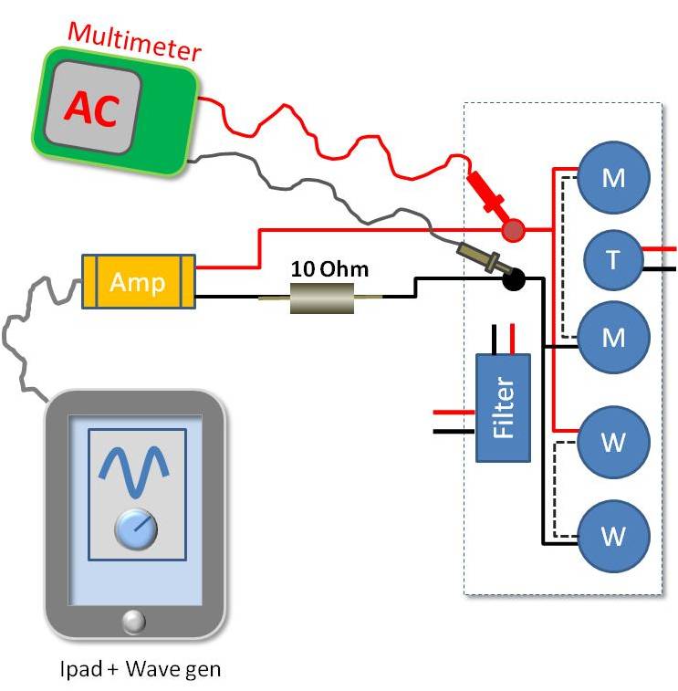

Fb - AC meter.. Voltage or Resistance ?
Bringing up this post with the image attached...
Silly question...
The AC Meter.. Are we dialing the meter to measuring resistance or voltage ?
Using resistance, both of my meters fluctuate so much, I cant get an accurate reading. (If this is in fact what Im supposed to be plotting, Guess I need a new meter or have to dig my old 30+ year old analogue one out of deep storage...
Using the Voltage function, I cant believe my eyes, but it looks as though the lowest number is read at 33 HZ ! I must be doing something wrong, its unlike me to nail anything on the head at first wack, never mind Fb!!!
Make sure you have no crossover attached. Just drive the four driver together by connecting jumper. Use a 1.5V battery and make sure they all move out together (or in together, depending on which way the battery is turned around). That makes sure they are all in the same phase. Now apply the signal. Using the series resistor, it is most common to have the AC meter across the speaker terminals. Below 100 Hertz you should have two peaks and a saddle in between. The higher peak may be around 70 Hertz and the lower peaks in the 20s of Hertz. The saddle, where the meter reads lowest, will be the Fb of the box and around 33-35 hertz.
Cheers, Joe

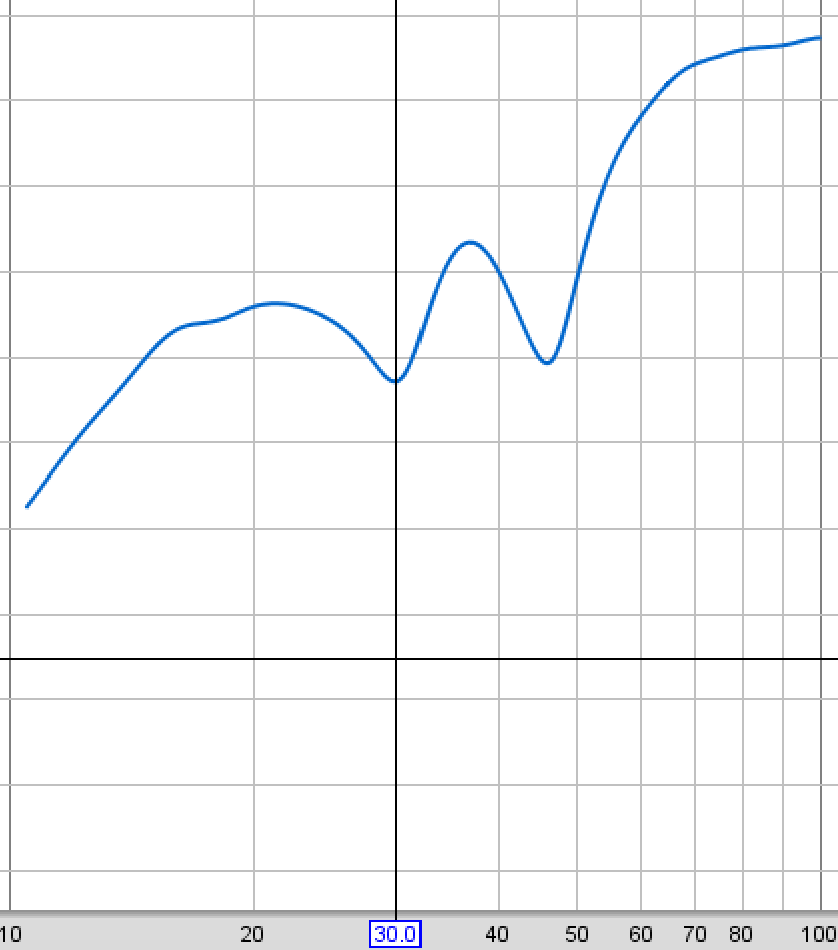

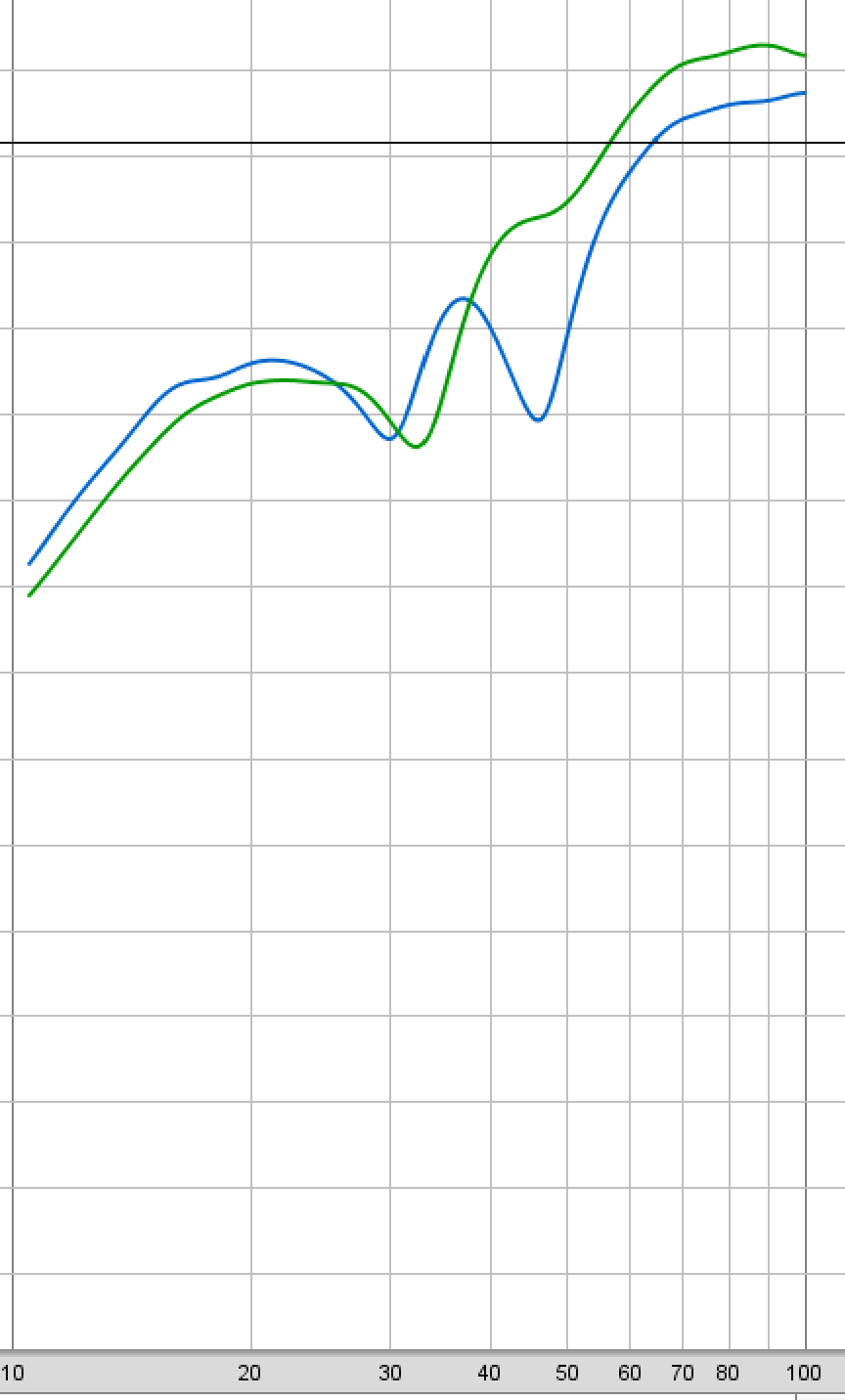

I just measured the other speaker for port tuning and the SPL shows quite different response. Why would I have so pronounced two dips at one speaker and not the other?
I am not quite sure what you're trying to achieve with the woofer SPL measurements.
To check the tuning of the bass reflex ports, I'd suggest to measure the electrical impedance curves.
thanks for reply. No not same physical location. Only trying to tune port with microphone 1 inch from cone, because my multimeter sucks 😀. Will try impedance measurement with sound card and resistor...
You could also measure the cone excursion of the woofer(s) directly. This will result in the most accurate measurement of the bass reflex tuning frequency. It's not difficult to do, see here: Open Source Monkey Box

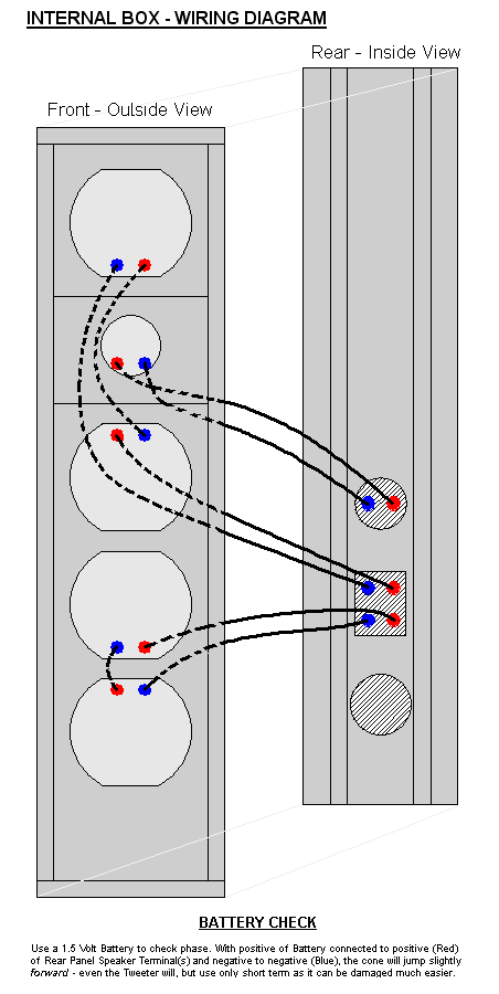

have not been able to find an answer to this maybe someone can help?
the crossover diagram off of customanalogue.com shows the + from the CO connected to the - speaker terminal on the tweet.
The box wiring diagram shows - to - and + to +.
not sure which to follow...
thanks in advance
sj
https://www.customanalogue.com/elsinore/elsinore_images/Wiring.gif
https://www.customanalogue.com/elsinore/elsinore_images/EL-6_Xover-MFC.gif
