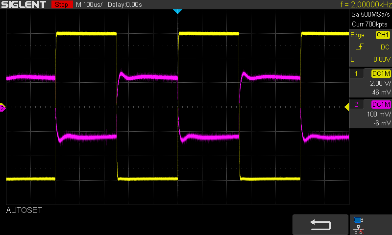

The 6R8 and 0u47 capacitor near the tweeter are not part of the crossover. Neither are L4, L5, R2, R3, C3 and C4.with additional zobel
then what are they?😕
These are to change how the speaker appears to the amplifier. You may have heard Joe mention these will work well with any amp, tube/valve, current amps.

That is certainly part of it.
The key here is to cause the amplifier to produce the same current at all times. For example, if the amplifier produces a square wave on the voltage side, then it should also do so on the current side.
This is a 2KHz example with the Elsinores:
YELLOW is the voltage side of the amplifier and RED is the current side.
It also does something very similar on the acoustic side.
So we shall see a reasonable facsimile of a square wave (time domain) in the voltage, current and acoustic dB-SPL. Needless to say, there are no commercial loudspeaker that does this. I read every issue of Stereophile and read every review of every speaker plus John Atkinson's extensive measurement tests, which are more thorough than what anybody else does.

I see that this is the schematic for the crossover. It doesn’t look like a first order transient perfect electro-acoustic design.
I was intrigued by your statement above that the acoustical side of the Elsinore can do square waves accurately.
Do you have some scope shots of microphone signals to show square waves or perhaps a derived step response from a REW (or equivalent) measurement?
