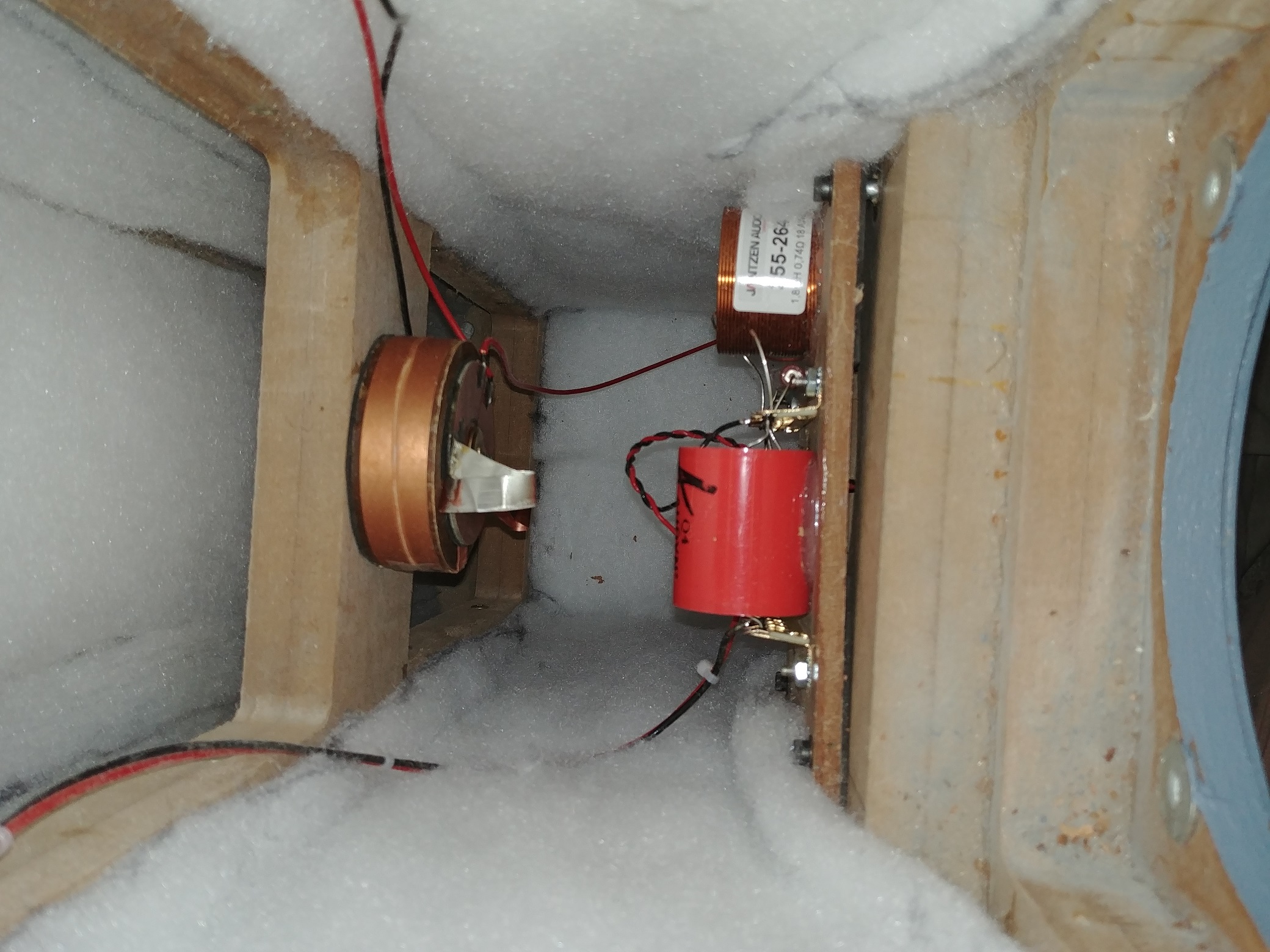

Note: those large iron-core inductors can sometimes "buzz".
Might be best to wrap them tightly with some Kapton tape..

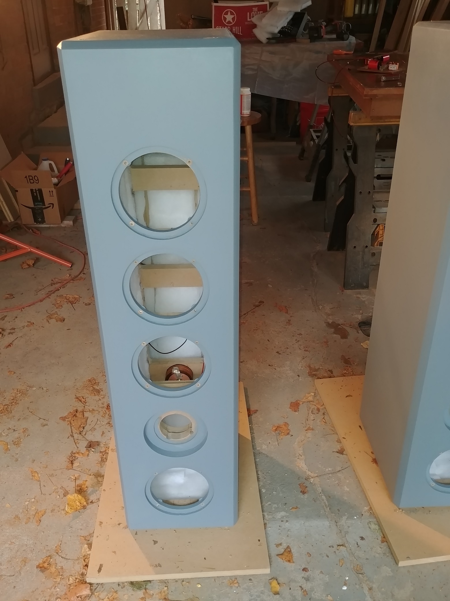

Good to see you getting closer to completion - what color are you going for the cabinets?
I am painting with Duratex tinted the pastel blue-grey you see in the photo (my initial primer coat). It will provide a nice contrast with the black drivers. I have experience from another project applying this with a fine foam roller so that the texture has an even, matte appearance instead of a more aggressive orange peel look suggested by the manufacturer. It hardens to a very durable, scratch and chip resistant finish.

Thanks for the tip, I just ordered some Kapton tape. Though the inductors are pretty tightly wound.
David
I have some that produce audible "buzz/hum" at higher input levels. Others, don't - sort of a "luck of the draw", and often most of it is near the "leads" from the inductor ..and even their "support" section, which is a good place for hot glue.
You can also "spot" glue the coils at multiple points with a hot glue gun - but that's something you have to do under-test.

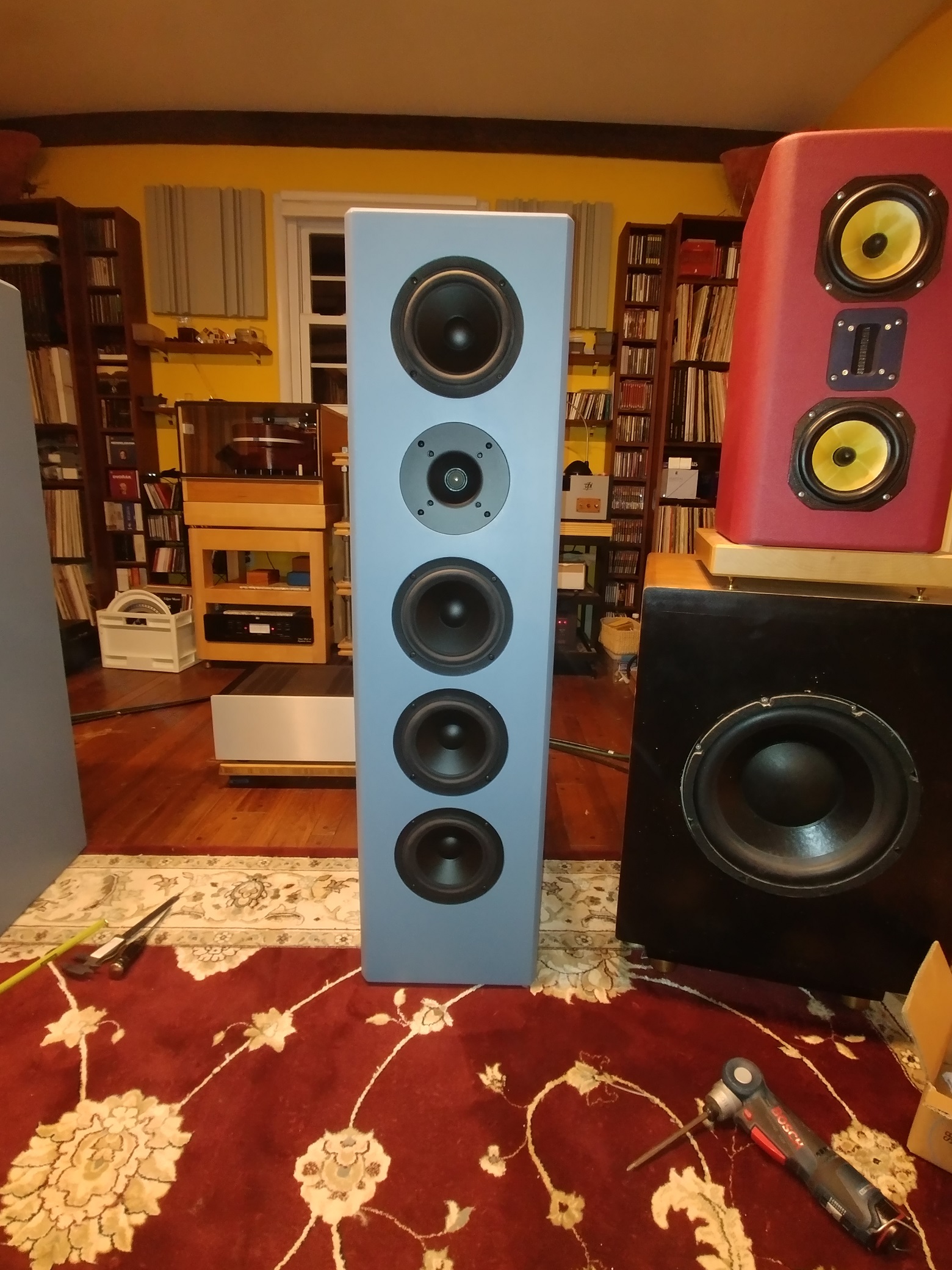

Had a very productive weekend, completing the wiring harness for the crossovers, installing the Dacron batting and crossovers, and finally bringing the cabinets inside for final assembly. One speaker is complete, save for the terminals at the back, the other still awaits the drivers.
Plan on finishing them tonight after work. I have spiked outrigger stands to attach which will raise the speaker by 2 inches (50 mm).
The speakers on the outside of the Elsinores are a pair of Zalytron/Orca Aria 5R speakers on top of powered subwoofers.

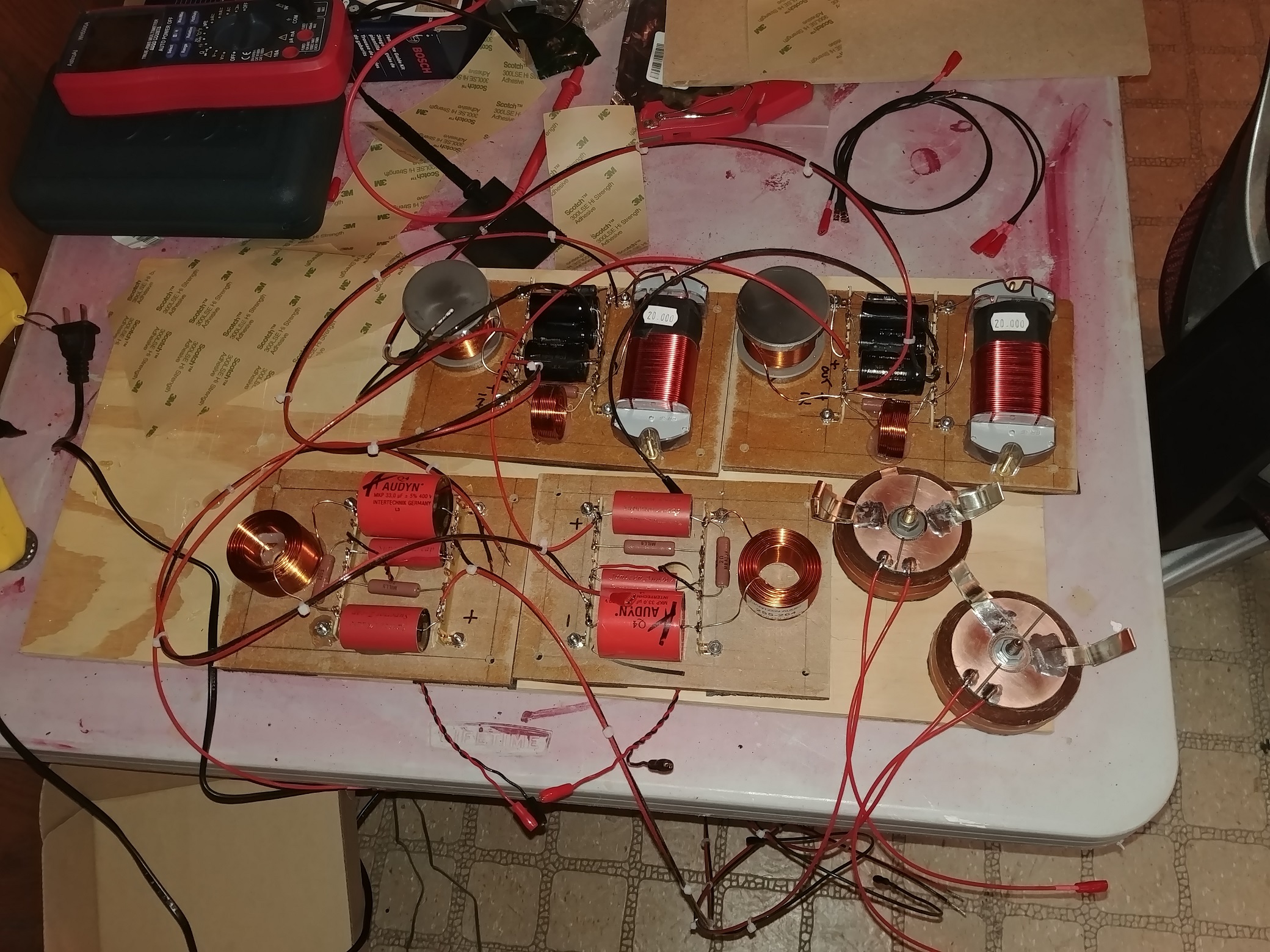

David:
Stellar work! After you’ve lived with your new Elsinores for a while, you might consider adding a bypass cap across C1; I used a 0.01 uF 3000v Cornell Dubilier 940C in that position to nice effect.

Thanks. I have a pair of those caps in my parts bin, so can add later. Looking forward to hearing these for the first time...still a bit more work, but hopefully they will be singing tonight.

Are those screws in the inductors non-magnetic?
Also, I would suggest to keep the inductors further away from each other, and at 90 degree angles relative to each other where possible.
The inductors on the lower mid-bass section are oriented 90 deg from each other so that field lines do not pass through the axis of the adjacent inductor. The screws through the foil inductors are brass. Keep in mind I have separate boards for the tweeter, mid-bass and lower mid-bass, placed in different locations in the enclosure. The picture is that I posted just shows all the crossover boards for both speakers laying on the workbench, and not intended to represent the actual installed layout.

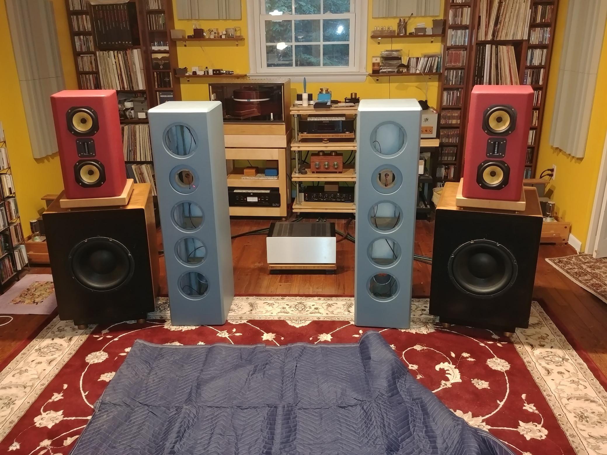

Congratulations on your successful build!
That looks like a Class A amplifier on the floor?
Zman,
Yes. It is my version of the Moskido, using First Watt BA Complementary Output boards with an Aikido tube front end. 6N1P gain stage and 6N6P White cathode follower. 25w class A power. My favorite amp, after 25 years of building tube amps.

Thrilled!
I have been a bit quiet since completing my build. After playing around with position in my room, I have just been sitting back listening. I have never heard a speaker disappear like these, and have such solid, even response from top to bottom. I had a few non-audiophile friends (fellow musicians) who were absolutely amazed that it was possible for speakers to sound like these do, creating a solid 3 dimension sonic image from the plane of the speaker extending side to side and to the back of the room behind the speakers, like being in a concert hall. But today I had a fellow audiophile and DIY'er over (who was picking up some horn speakers that I experimented with several years ago and not longer need or want), and he thought these were the best speakers and system he had ever heard, including at our local audio show (Capital AudioFest). In fact, he would love to participate in a group build of these, and felt that if more heard these, there could be several wanting to do so.
This is an incredible project, and I am absolutely happy beyond belief on how these turned out. They work perfectly with my Class A tube/MOSFET hybrid amp, and I have a pair of 20W+ GM70 SET monoblocks waiting in the wings to try out (as well as a pair of PP 300B amps that need little more work before I will try them).
