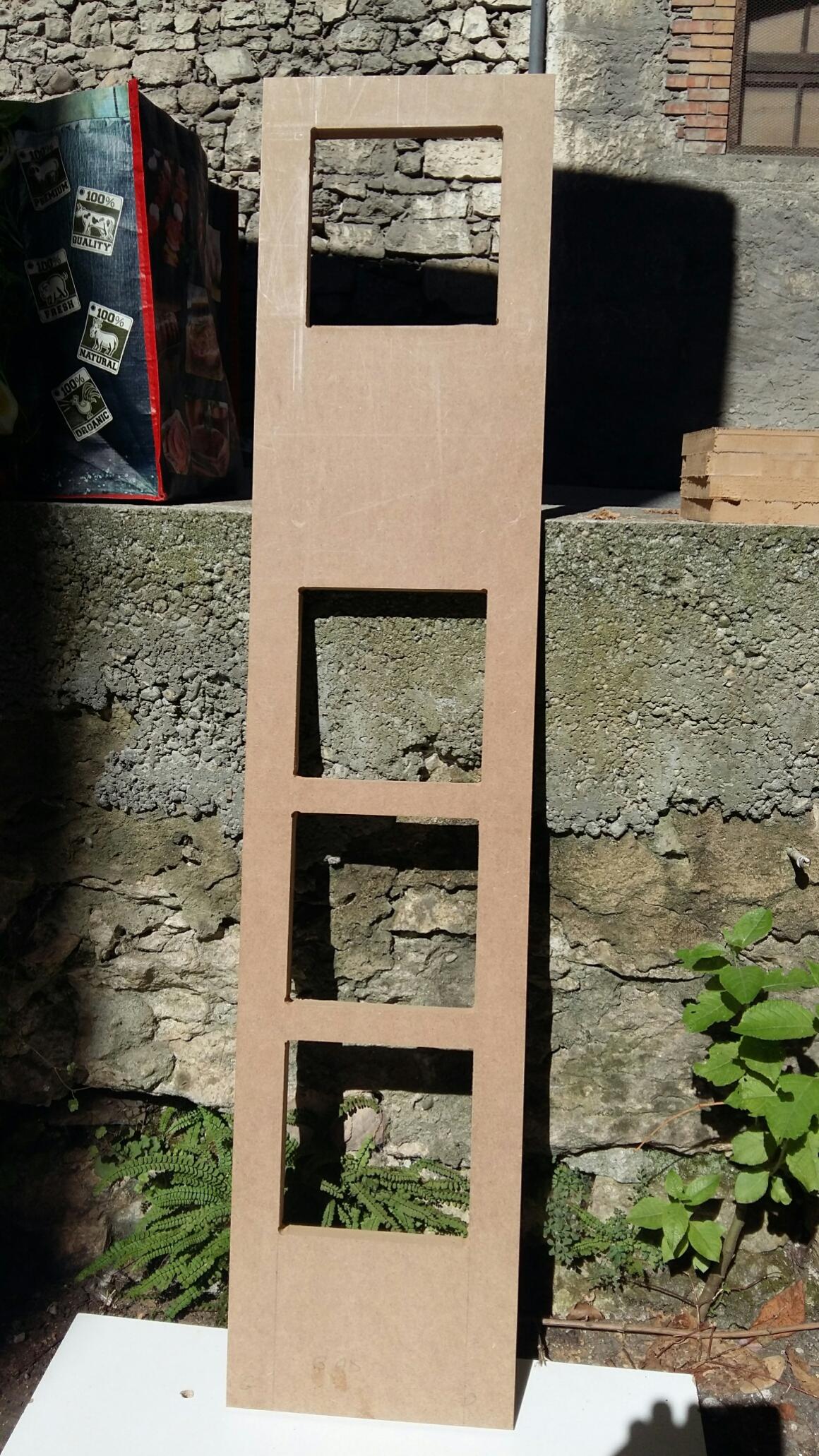

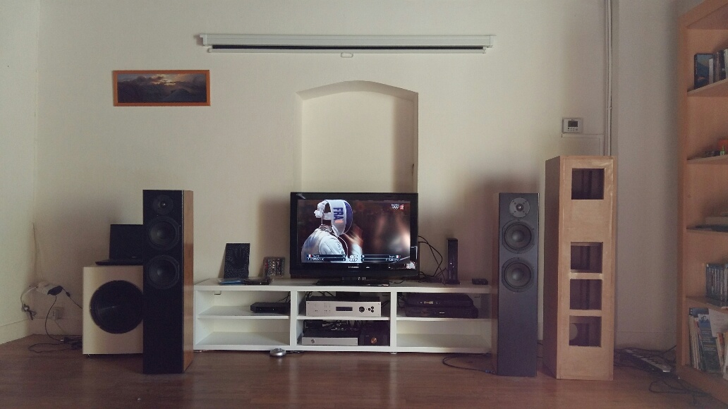

Three years after getting Joel's waveguide I've started building the Elsinore mk5 !
Concerning the crossover should I try the original one or directly make it the with Bolserts's mods ?
Below few pictures of my build in progress.
The boxes are made in 19mm MDF and will use bitumen + felt pads inside, the same way I've build the TG Nomex 164.
The Elsinore wil re-use the four 830875 and the 810921 from the previous build, the Elsinore are much bigger speakers !!

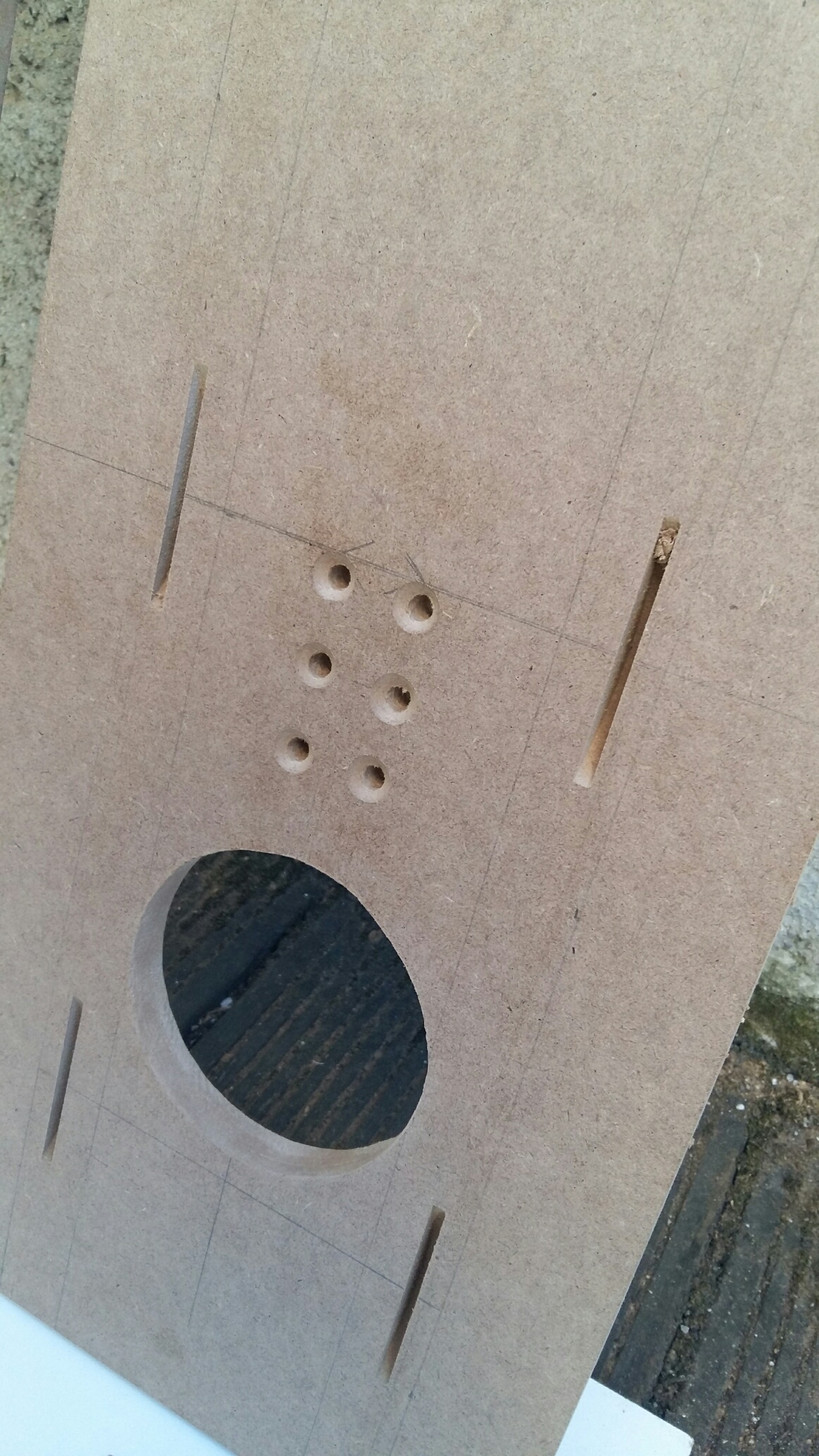

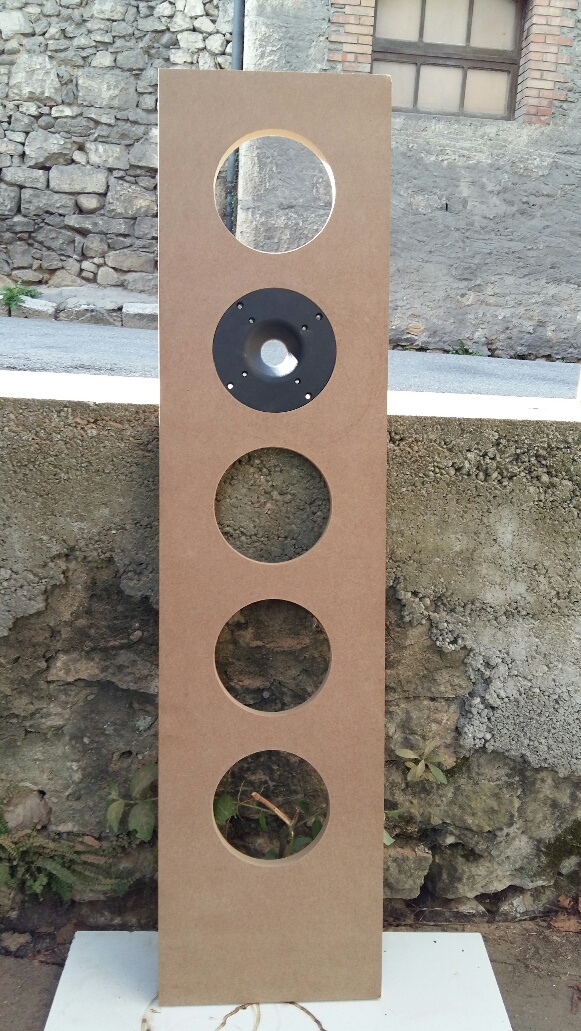

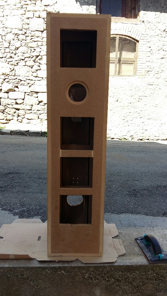

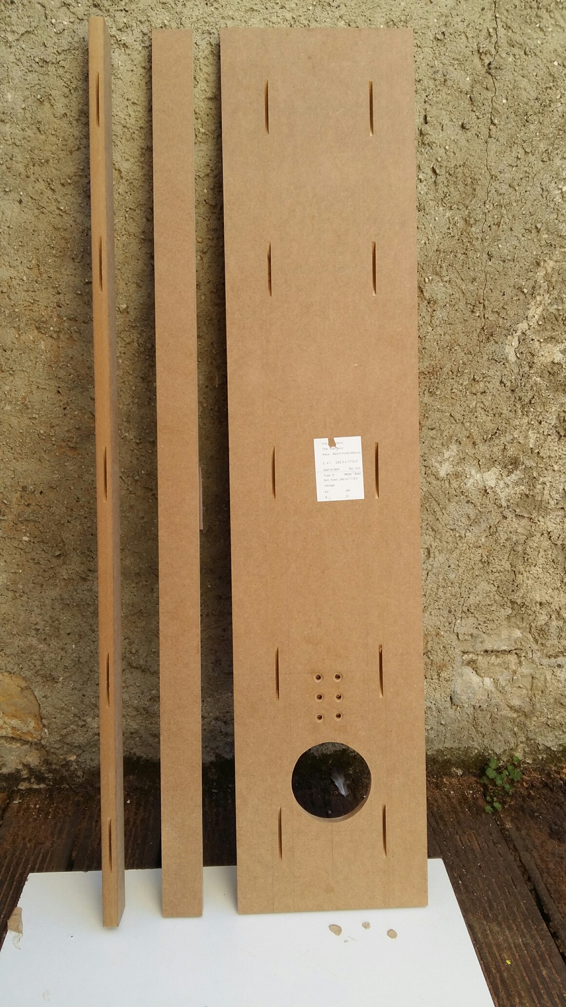

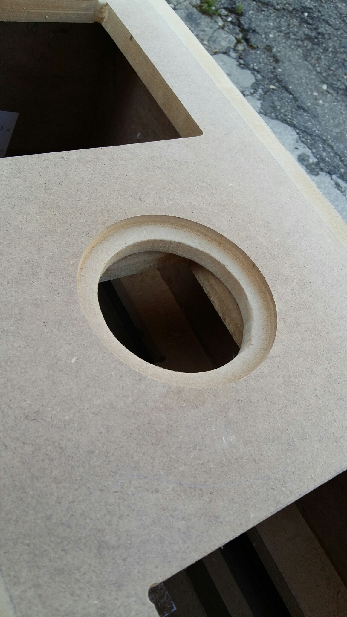

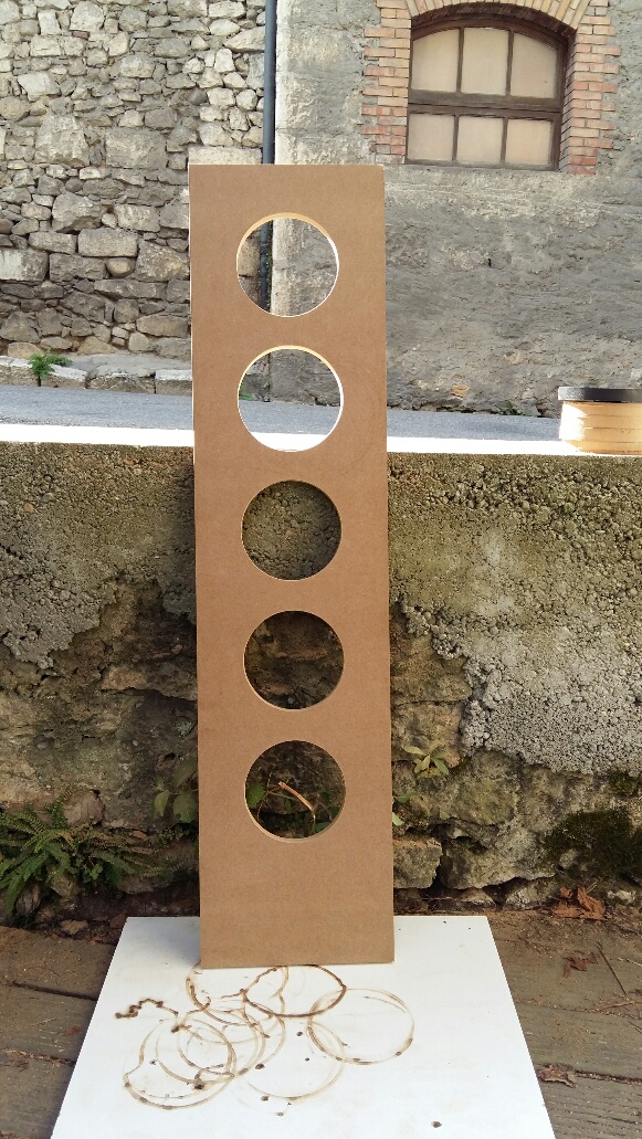

Afternoon work : routing front panel holes see pictures.Please post more pictures as your build progresses.
I have to check the combo tweeter/waveguide hole and put some damping material before gluing the front panel to the sub front panel.
I will start assembling the second box the on friday 🙂 All panels are cut excep the front panel.
There is more work on the boxes that I thaught before starting the build process !
Building the Elsinore speakers is a really BIG project 😱
