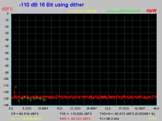

jcx said:Which is Right? – I vote neither
If you want to move beyond pinheaded angel counting and address practical audible resolution and 16 bit word length issues you quickly discover that digital domain manipulation must be done at high bit resolution and dithering used to create the final 16 bit representation. Using dither and noise shaping, audible resolution in 16/44 CD digital audio can easily exceed 96 dB – with the greater advantages of sub-lsb linearity and decorrelation of quantization noise – only people shipwrecked on desert islands, working with bamboo and coconuts have any excuse to be limited to undithered or 16 bit resolution editing for even 16/44 mastering

Was I wrong if I thought that the dither was meant to stay out of this story…?
File with 1LSB amplitude is here: maximum sample value = 1, minimum sample value = 0. Rob already uploaded something like this, but (no offence) this is probably more convenient. I am pretty convinced that any software analysis will never show this has anything but -90.3 peak. Since as long as this is 16bit format, none offset could be put into this, file is converted to the 172kHz/24bit format. After conversion it normally shows the same peak value. Then data were centered on the zero axis and… These three files are here zipped, so you can proceed to fiddle... Maybe you can put it back to 16 bit format…
Again, ignoring files, programs and stuff, it is only important how you define dynamics: as the smallest possible signal amplitude referenced to the peak amplitude or as the smallest possible change in the amplitude referenced to the peak-to-peak amplitude.
Pedja
Pedja
