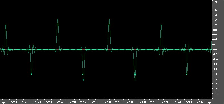

two heads are better than one and two voltage levels are smaller than three
The the number of possible DAC output voltage levels for the smallest possible output signal.
