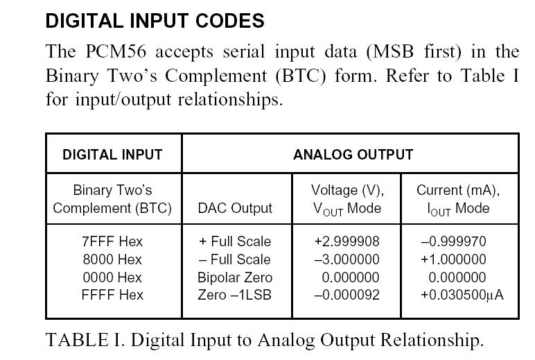

Mark Broker
Re Fred Dieckmann : The the number of possible DAC output voltage levels for the smallest possible output signal.
Using proper dither the lowest signal is below the dynamic range!
See attched picture...

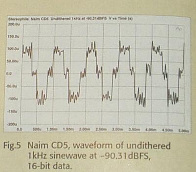

Do you really talk about the same thing?
Digital noise is one step, not zero, one step minus and one step plus. One steg compared to fulll signal is 16 x 6 db + 2. I think we all can agree on that noone has measured 90 dB at the most from a 16 bit system.
The question is: How noisy is a 100% digital signal? How small is the smallest signal. The smallest signal is only one step but this signal has also half a step DC-level.
Was I wrong if I thought that the dither was meant to stay out of this story…?
