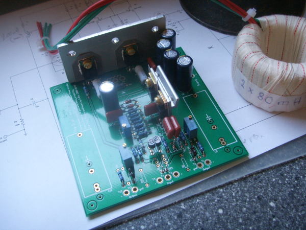

Actually, the only thing missing on my PCB, is the 10uF cap's at output, and the following resistors : R6/R7 R18/R21, they form the gain of the circuit right... so if i want a lot of gain i have to set them to 15K / 6K to give me 25x gain, am i right ???

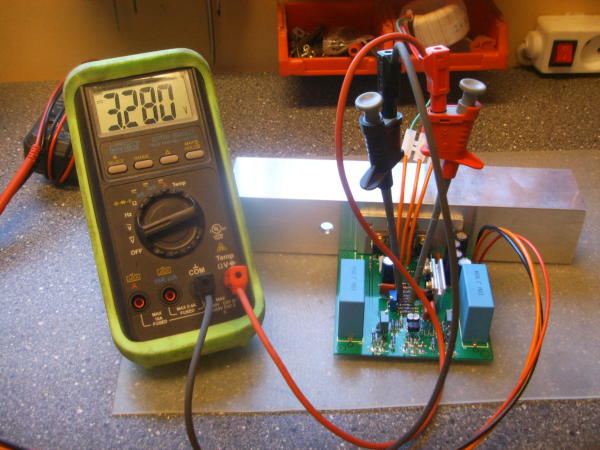

Sucess... well it was no problem making theese adjustment's, i had set R25 to MAX, and then lowered the resistance down, to have ~3,3vdc across R24... (voltage was going from 2,1vdc - 3,3vdc when adjusting).
I found ~1,21 and 1,24 vdc across R1/R17, without adjusting at all.
The Q1/Q6 get's pretty hot, realatively fast... how much will they dissapate ? Are they supposed to get hot (do i need big sinking?) Also Q7/Q8 get's warm, but nothing special.
I heard some circuitsinging, during R25 adjustment's, i guess it's some choke-song or like 😀 ... Not comming from choke itself, but from circuit, which i found a bit strange.
I donno when i can find the time, to make further progress... but it look's like the thing is working... and that's good !

set R25 to max value
set both R5 and R11 to mid point (value ) if they aren't already
then ( after powering up) - adjust R25 to have 15 mA through center CCS , or 3V3 across R24
then set R5 to have 1V to 1V5 across R1
then set R11 to have same voltage across R17 , or - BETTER - to have 0V between drains of Q1 and Q6
all inputs grounded

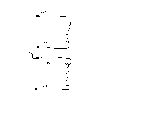

did you make it with 10k/100K feedback net ?
are choke halves in phase ?
I will change the feedback net, to 10k/100k, but what do you mean choke halves in phase ?
Jesper.

A few things could be wrong.
1) Wrong calc of gain setting resistors.
2) Temp drift on very small heatsink.
3) Not zeroed well enough.
4) Inductors out of phase.
5) Noise picked up by inductors.
I will talk it over with Lykke again later, now he is going to start out by setting gain back to 12, mount a respectable heatsink, zero it out better, and check the inductors are in phase.

lykkedk said:
And that was the key, for having a functional DREK ... 😀... Well i lowered the gain back to 100K/10K, and setup the coil, as in ZenMod's suggestion, and everything is working now.
