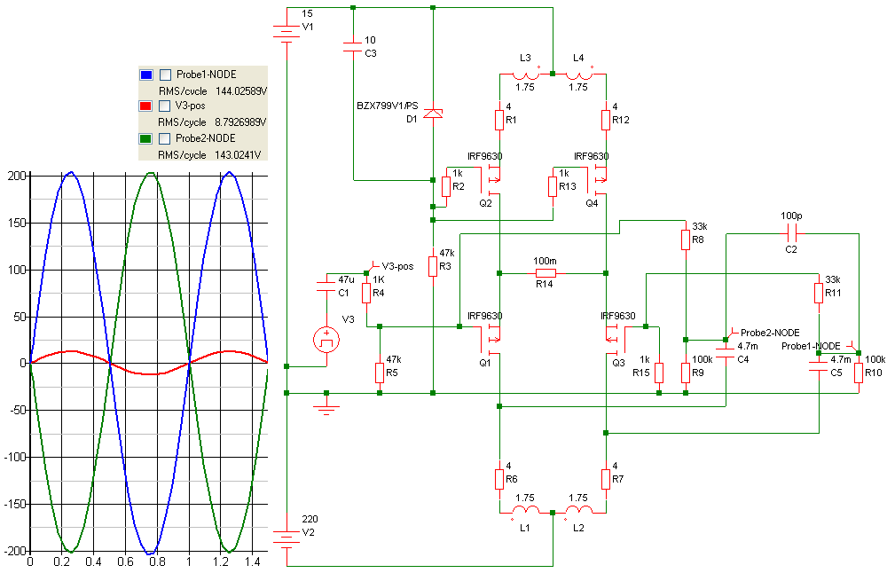

what's that? what's the output look like into a 100pF load?
"That" is me playing with a couple of transistors and chokes. I wanted to see how far I could go with voltage gain and still maintain a decent looking sine-wave...
As far as the 100pF goes, I'll load it into the sim and see.
I coupled a 100pF cap to each output and took them to ground. There is no effect on the sine-wave.
BTW, I discovered that the positive rail doesn't require more than 15 volts. It's the bottom (negative) rail that wants voltage. It's scalable--just don't input as much voltage and the output is happy. I just ran it with 30 volt negative rails and it looks great with two volts input.
I just coupled the output nodes with a 100pF cap (the 100pF caps to ground were removed) and the specs appear to remain the same.
