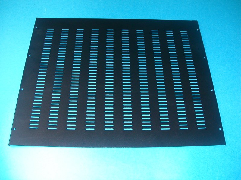

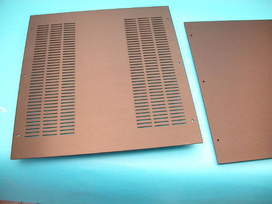

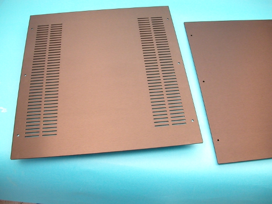

See below:
* The standard steel ventilated cover on a chassis (pictured: black)
* A super ventilated steel cover (pictured: black)
* The standard "4 row" alu ventilated cover (pictured: brown)
* A special edition "6 row" alu ventilated cover that they will do for us if we order alu chassis (pictured: brown)

FYI, the aluminum covers are 3mm not 2mm and the steel is 1.25 not 1.2.
Thanks for everybody's feedback. We have added a half width chassis, aluminum chassis (6 rows of vents as pictures above), and a solid aluminum cover as options. Please let us know specifically what you are interested in, and we will put together a final product offering.
