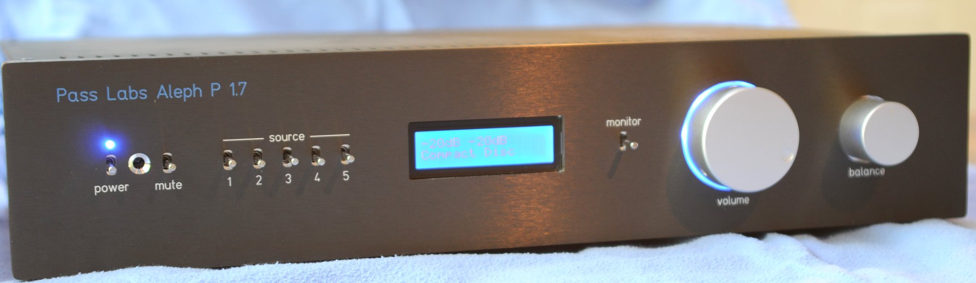

The HiFi2000 front panels are removable. I've used Front Panel Express on almost all of my projects, and have shipped HiFi2000 10mm front panels to them for processing. Here's an example.

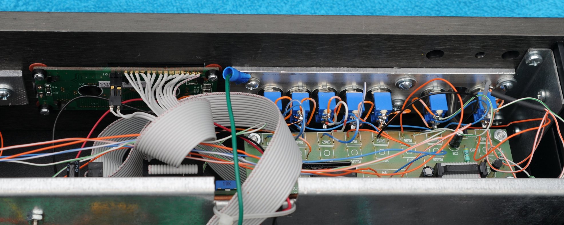

The front panel on the Slimline chassis attaches to the two side panels via L-brackets. Removal and reattachment of the front panel is easy, provided you can get access to the two bolts that hold each L-bracket to the side panel.
The switches on my AP17 are mounted to an aluminum plate. I had tapped holes installed on the back side of the front panel that are used to mount the aluminum plate. The holes for the switches themselves were also drilled out on the back side of the front panel, to accommodate the nuts holding the switches to the aluminum plate. I'd be happy to send you my FPE design for the panel if you are interested. The photo below may be instructive (and also shows the L-brackets holding the front panel in place).
