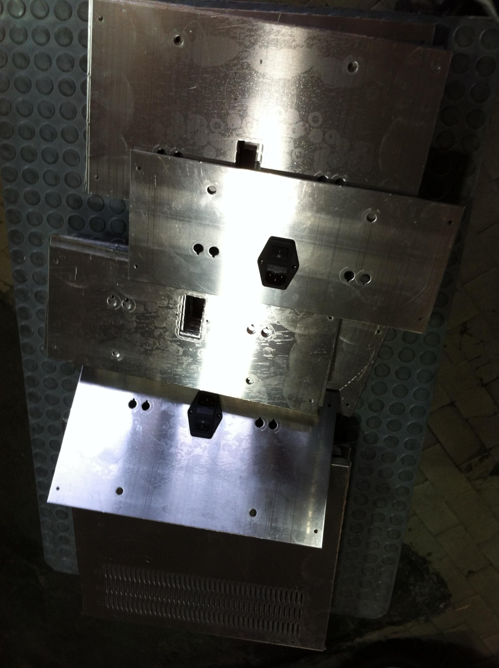

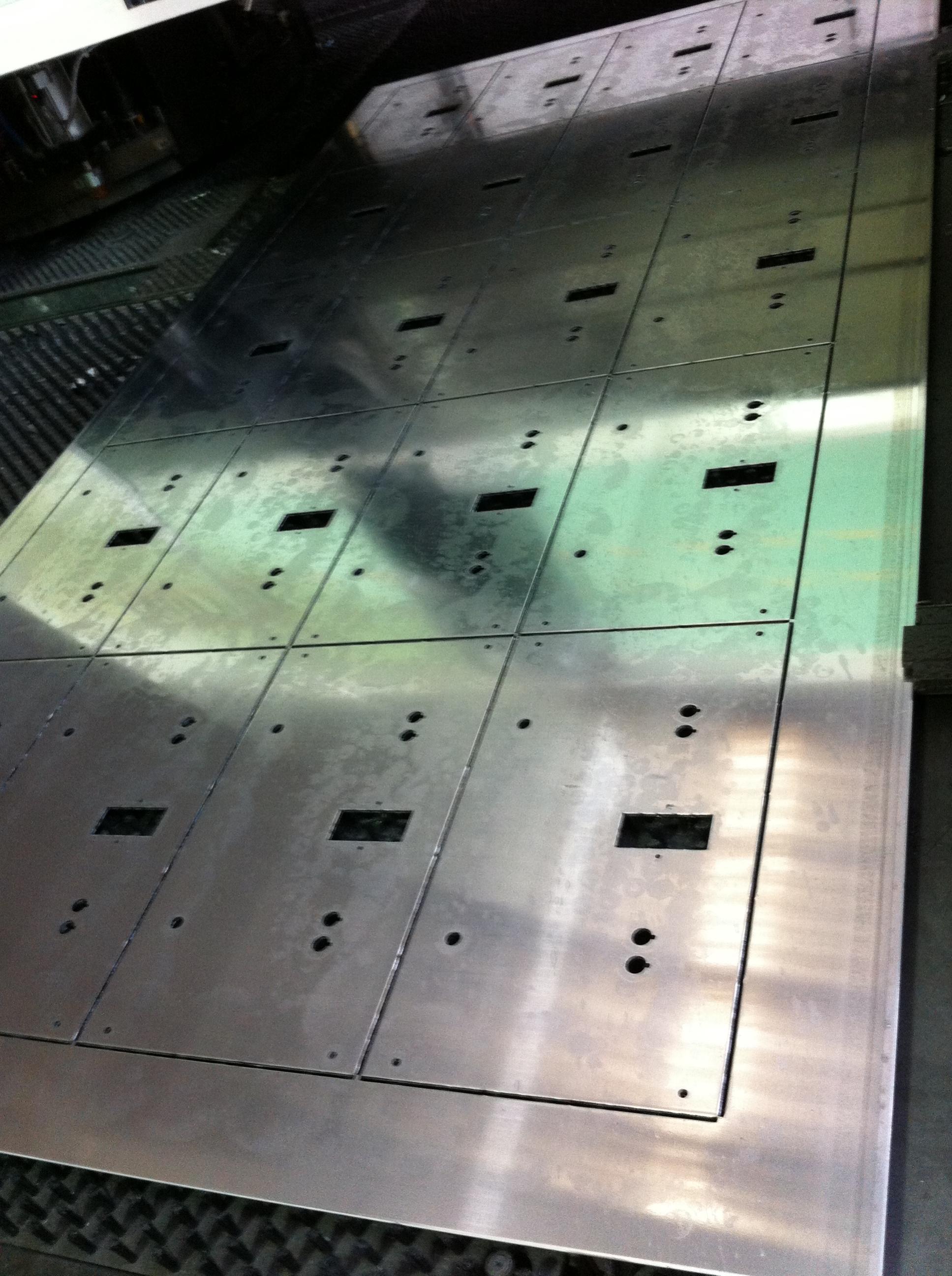

We've created a CNC back plate specification now, which is attached below.
We'll be offering a pack including a quality PEM, 4 keyed high quality binding posts and two RCAs that will all drop straight in.
We're now just a few days away from placing the order, and there will be stock in the store within 2 months.

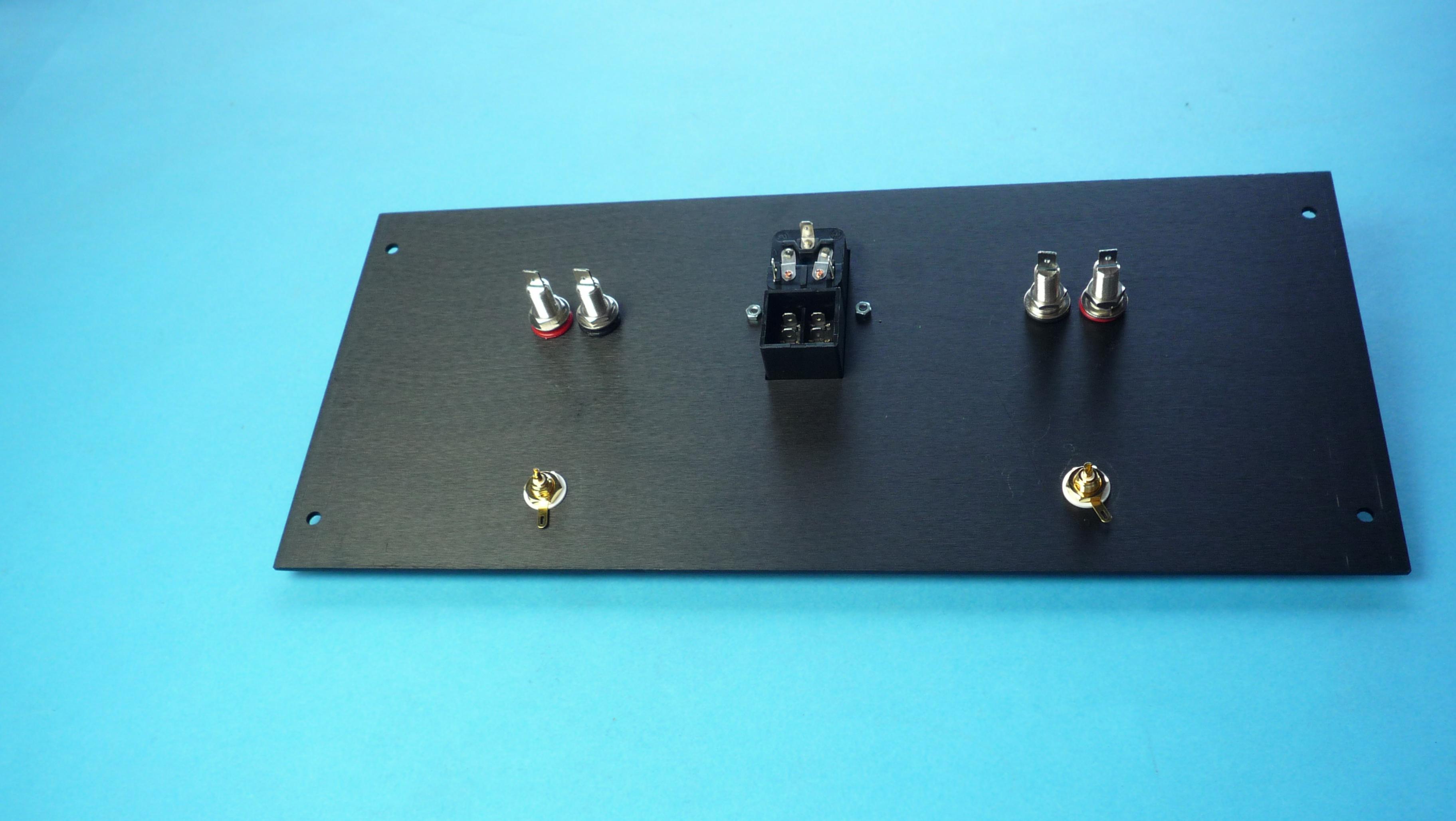

- RCAs are positioned high to avoid noise interaction from the AC lines
- RCAs are spread wide so you can install a soft start or speaker protection board on top of the PEM
- Binding post holes are 11.5mm in diameter and keyed to directly accept premium non-twisting binding posts from WBT etc.
- Binding posts are spaced 3/4" apart which is standard for most binding posts
- PEM hole can accommodate PEMs (Power Entry Modules) from multiple vendors (Eg: Qualtek, Schurter, Schaffner)
- General arrangement of holes is intended to reduce wiring clutter

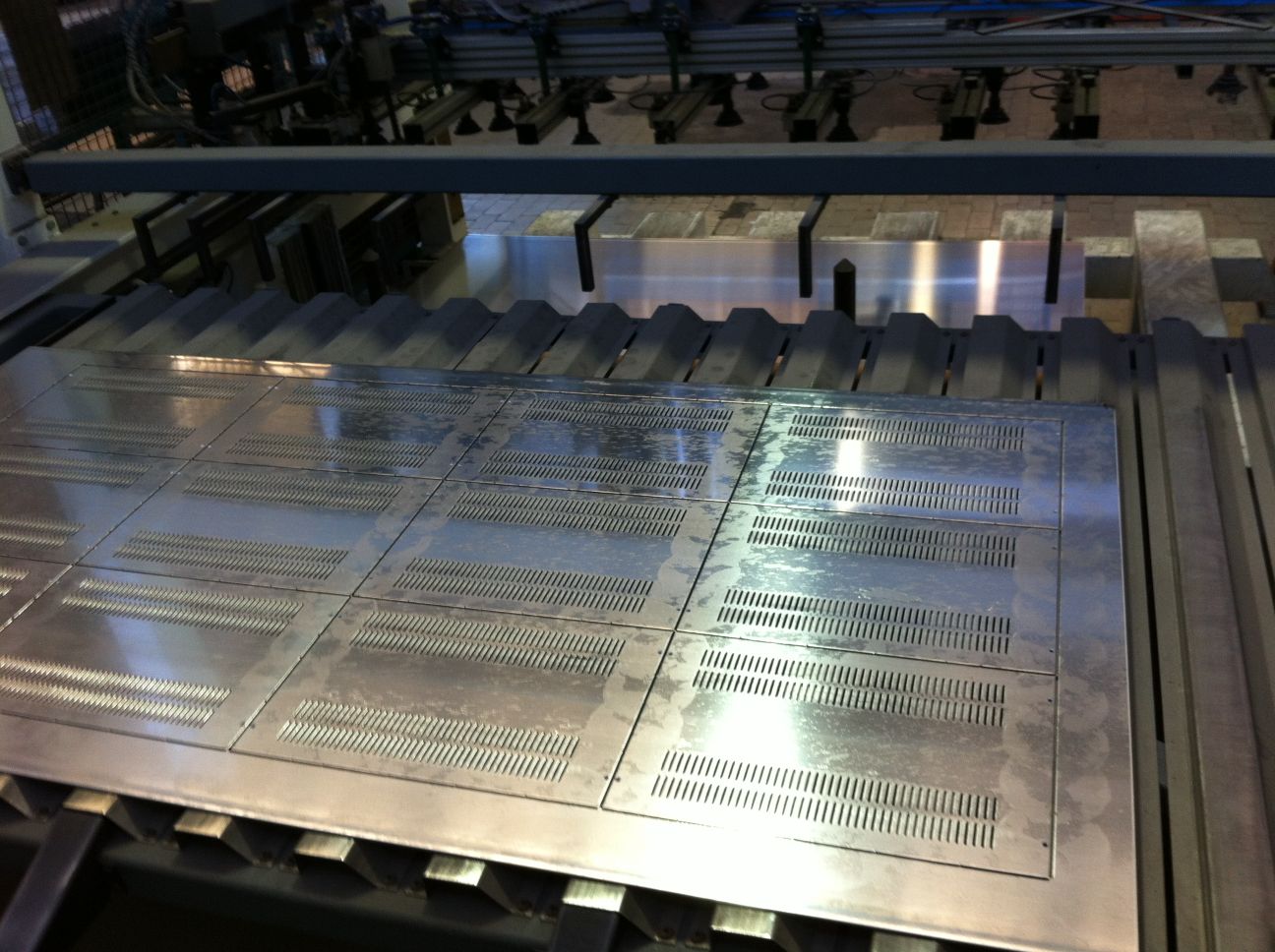

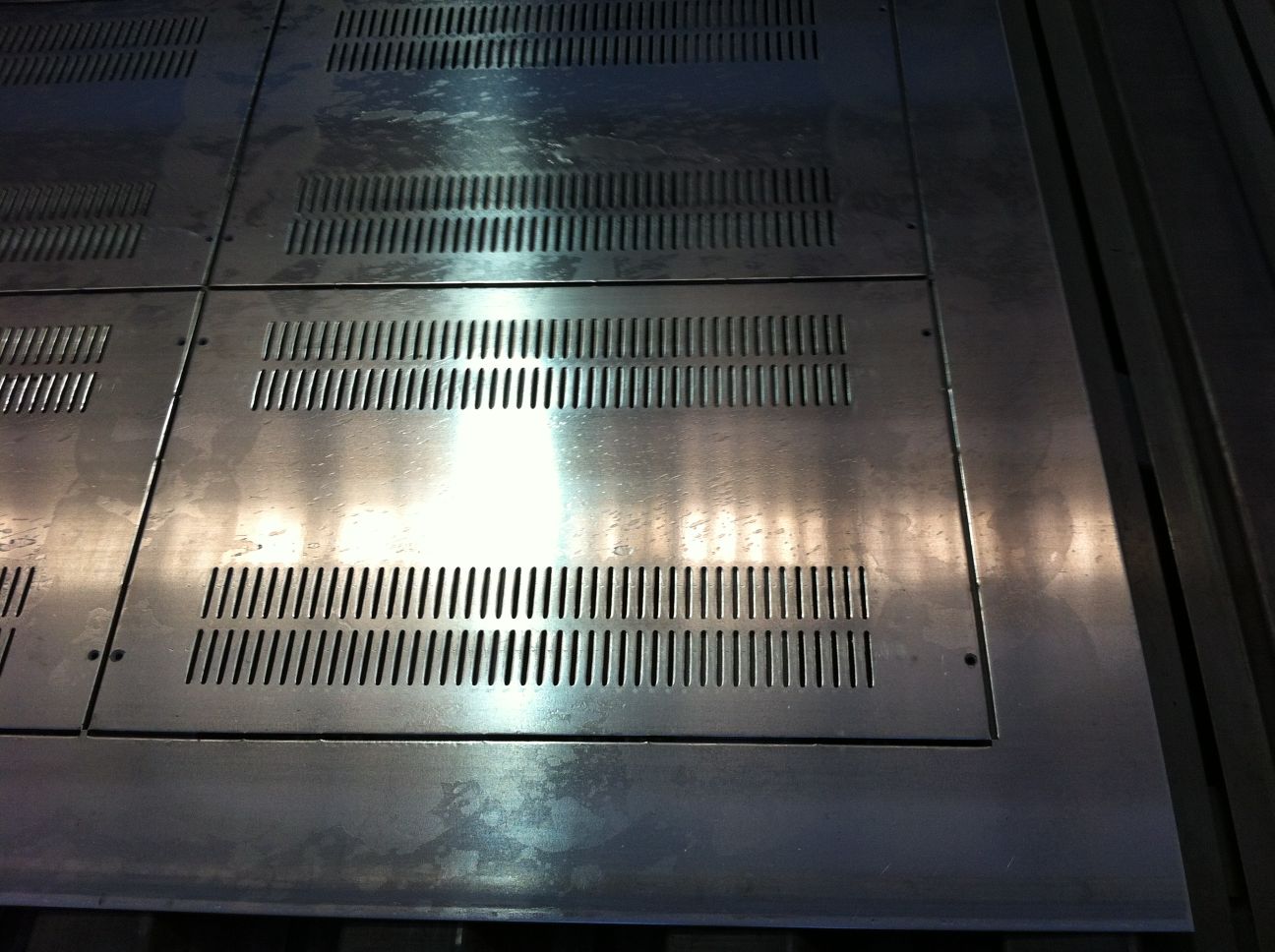

Some more update pictures. Here with fitted backplate components (these will be available as an optional parts pack) and showing the 6 row vented covers which will be on top of certain chassis models. The binding posts are spaced so that they can accept double banana plugs.
