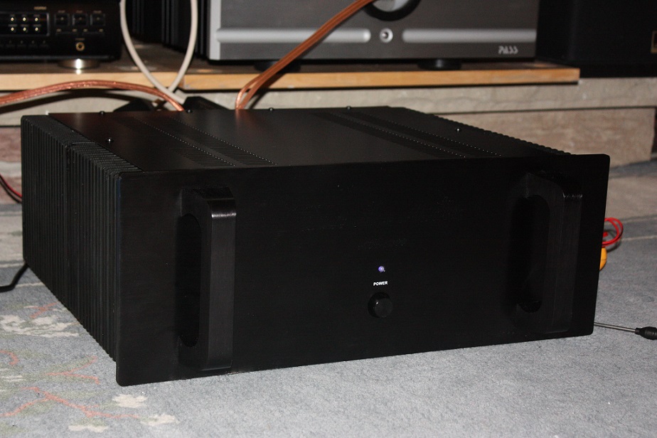

My computer box F6
It looks ugly, but it sounds good, very good.
Thanks everybody for all the helps. I don't know how to tell the sound. I like it and I like the imaging that it creates. It runs at 1.3A for almost 10 hours today with only 38c at heat sink. I love this more than my F5.

Looks pretty good to me.

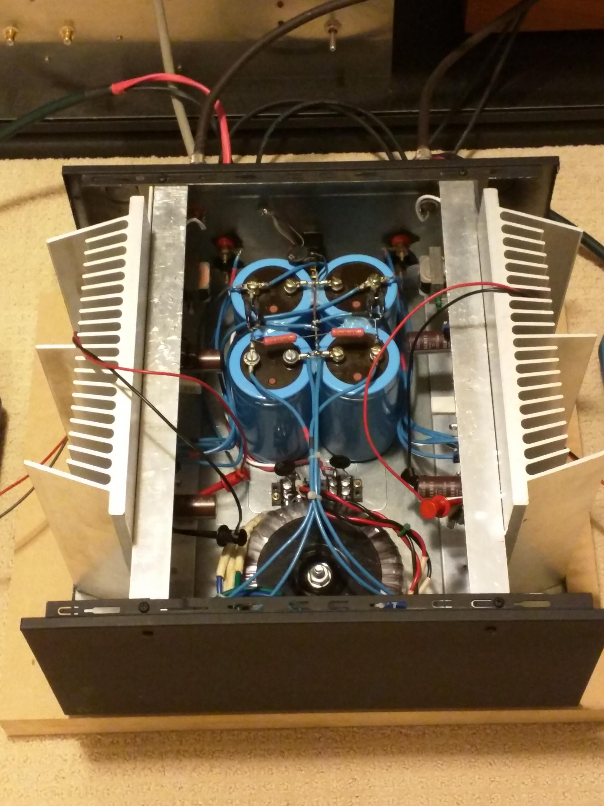

After working on and off on this for the last 5 months, I finally
powered up the F6 last night. The only problem seems to be that I
had soldered one of the on-board LEDs backwards. 😱 I don't think
I will bother fixing that.
It still needs a little bit of work; the dc offset is a bit high (20mV)
since I made the initial adjustment before the amp was fully heated up.
Anyway, it's playing and sounding pretty good. 🙂

It is not a lot of trouble removing the led and reversing it. You will probably be able to do it without removing the board. Just heat the lead from the top. The worse that can happen is you destroy the led but I have had to change many in my builds and always saved the led. Lowering the dc offset is easy too but 20mv is not a real concern either. I think you will find the bias will need to be adjusted after a few days of using as well. Wait a few days and recheck it. It is a simple adjustment.
