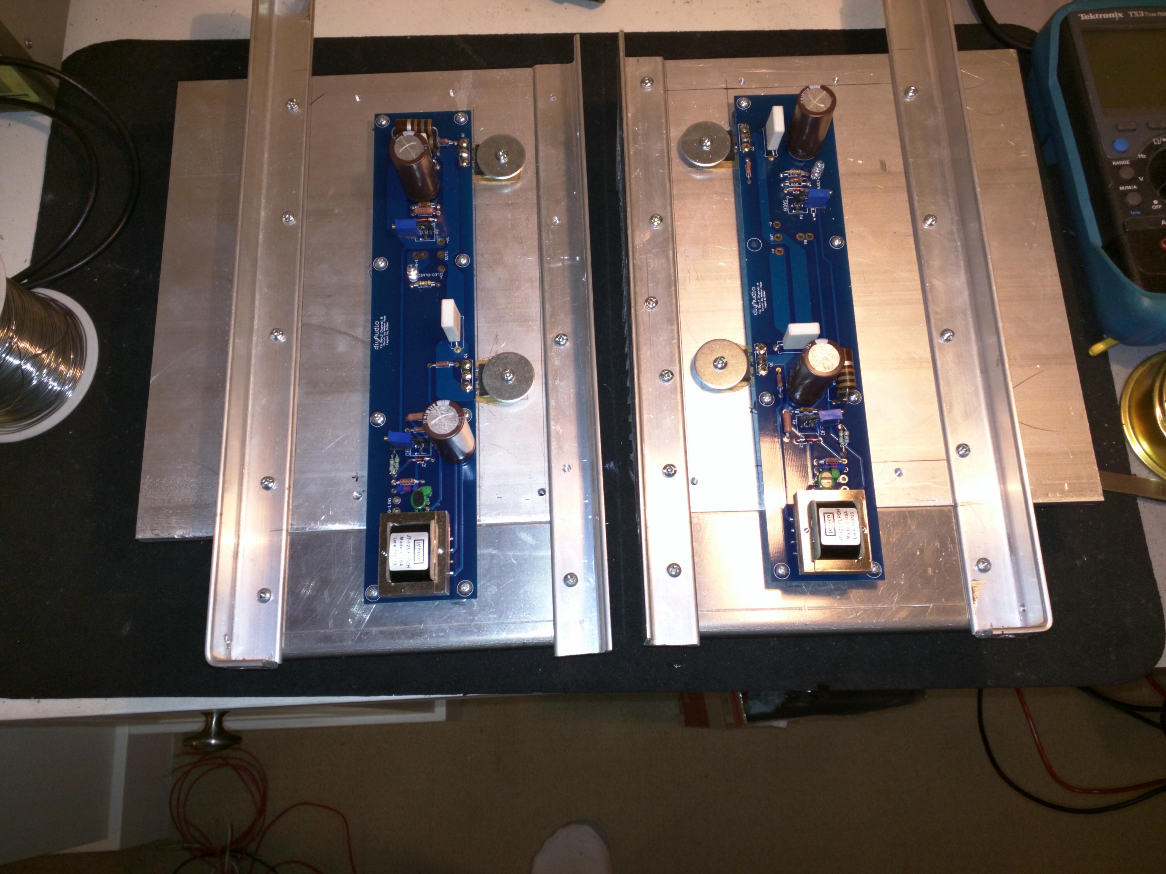

By the way, will the circuit i drawn in post #1459 work at all? Or maybe some cascode instead if possible?
I have both board stuffed and on heatsinks. Hope I could put them into the chassis tomorrow.

I thought I ran into some sort of problems. The PSU gives me good numbers and both sit at +24.74/-24.75 unload. I fired up one channel at a time and first on test was the channel on my right. I have the power turn on and checked closely on two meters. I didn't find any reading on bias, but instead the voltage at offset raised like crazy. I turned it off and back on again after serious checked. The LED was not on and again the reading at offset went over 2v but the bias had nothing. I turned off and disconnected all power so to recheck and found the LED was placed in wrong end. I took it for granted that it should be + to supply and - to ground. I turned the negative to the supply and + to ground and the LED back on.
I tried my luck to fired up the left channel by setting both trimmers in the middle and it fluctuated a bit but I could see readings on both meters. I then trimmed the offset close to 0 and let it sat at .5v for about 30 minutes. It was stable, the voltage without going anywhere.
I replaced both IRFP240s on the channel with problem and fired up after that. LED was on but offset voltage reminded the same, kept climbing and no reading on bias. What I have done wrong?? What else I should do to make it works ???
Thanks in advance
