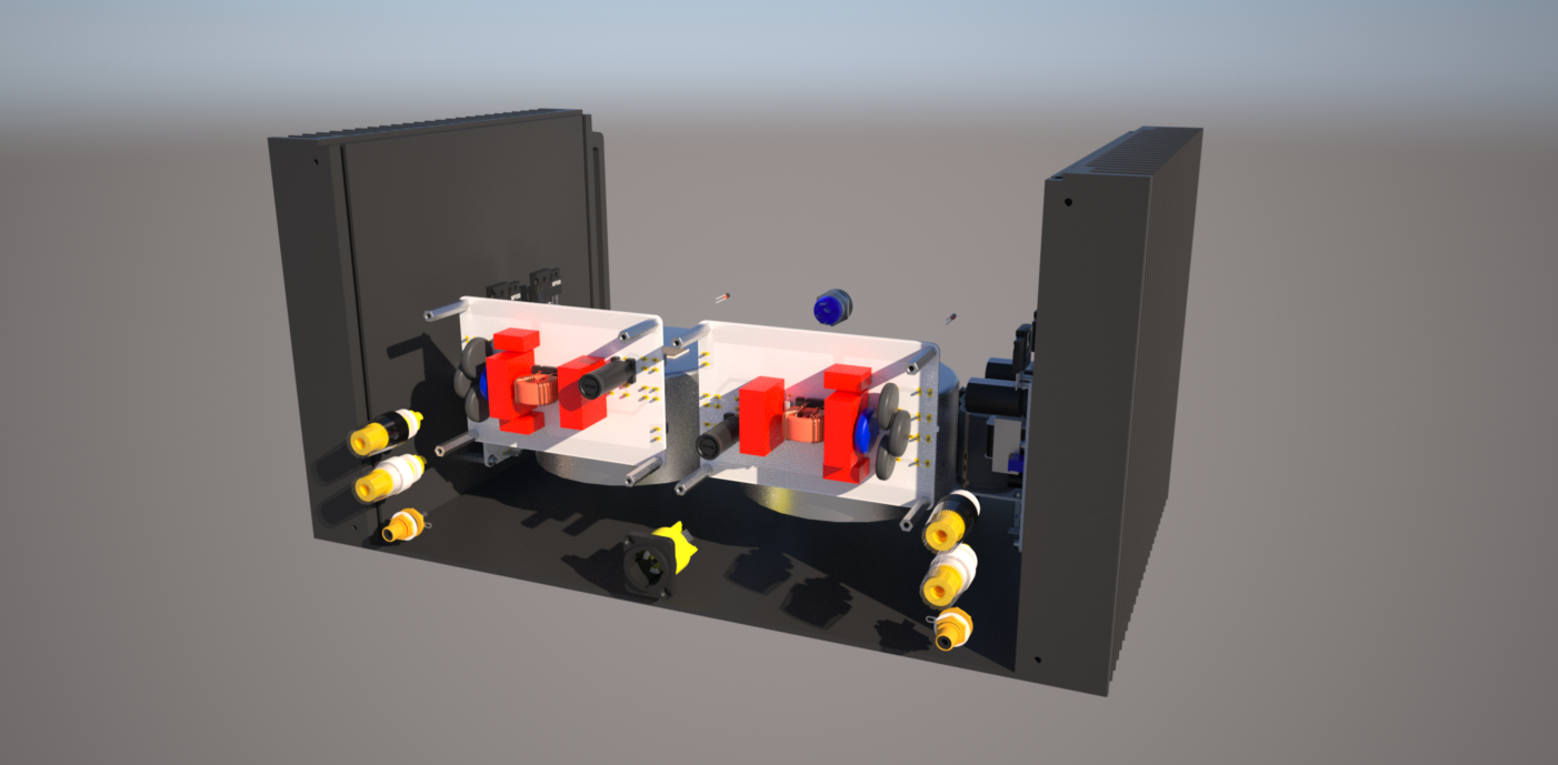

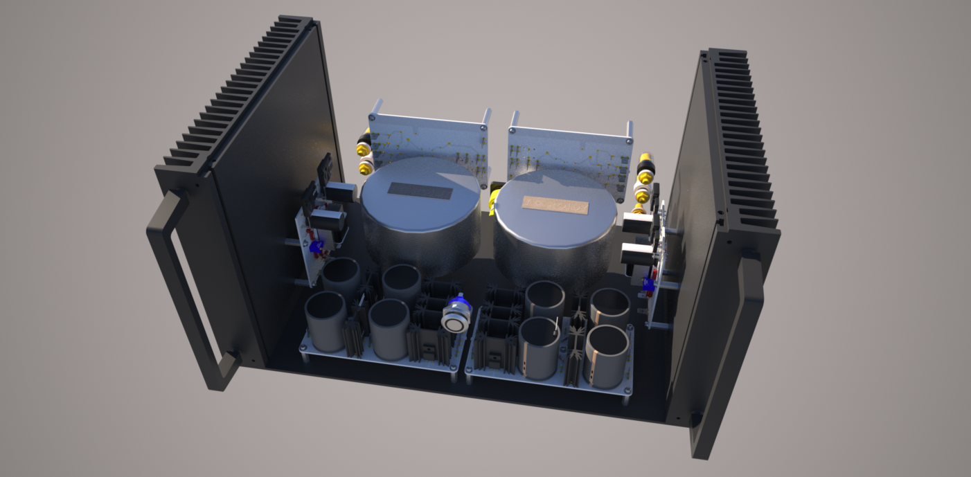

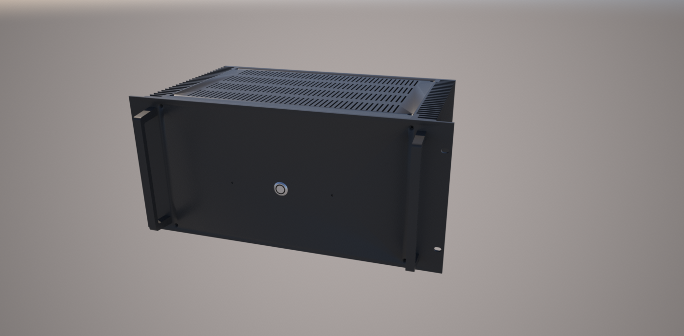

After a quick blessing from our technical, spiritual, and menu advisor, Nelson Pass, I am glad to present the preliminary discution for the diyAudio Mosfet F6.
Cool, huh? 🙂 This is made for IRFP420, or a similar Mosfet that has a Vgs in the 4V range. This is a beautifully simple amplifier!
Member Didiet78 has done some preliminary layout, (Thanks a million! It looks wonderful!!) this is the current thinking - 2 PCB, a left and a right, in order to keep the input transformer as far back as possible on both sides, and to have the Mosfet mounted low on the heatsink. The PCB will be designed to only mount the specified Jensen transformer, but I'll look into the possibility of a second set of pads, if possible, to mount a Lundhal or something... No promises.
The diyAudio store is also looking into stocking the transformers, which would make the whole process quite easy.
The other consideration in this project is the PSU, by which a shielded transformer is going to be very necessary, mounted as far from the input transformer as possible, and possible in a screening can as well. Or, of course, a separate box for transformer, diodes and first capacitor bank. Other than that, everything is straightforward. The diode, cap and resistor bank are the 'Firstwatt vernacular', I.E., look at any Firstwatt amp and use that PSU. The diyAudio PSUv3 boards will work beautifully, as will many other PCB.
The floor is open for discussion. 😀

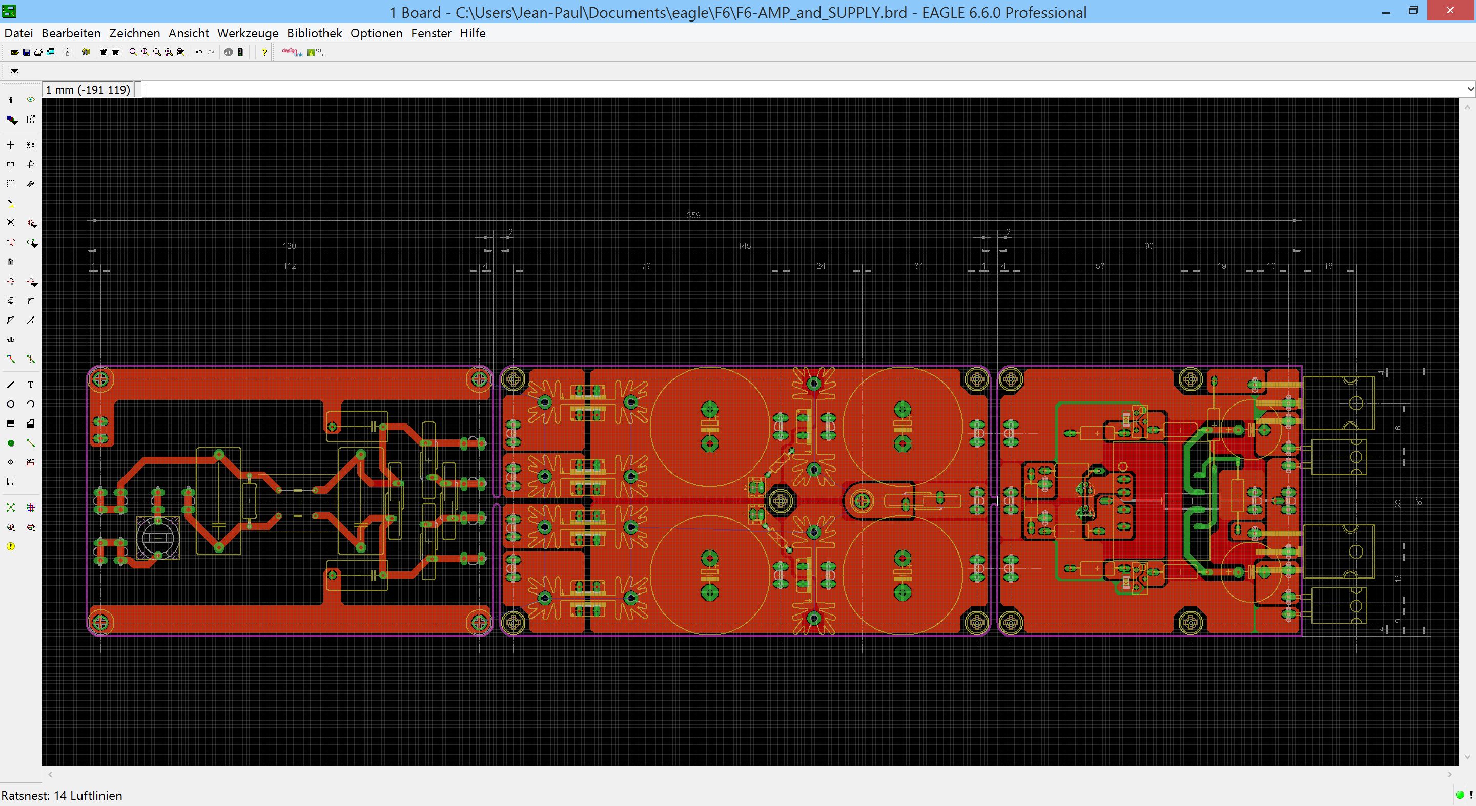

I just bought a stack of these Elna Capacitors
http://www.digikey.com/product-search/en?mpart=RFS-50V102MK9%235&vendor=604
The diameter is 18mm. Please tell me there is room for them to fit on the PCB.
Please allow for these caps. There are no substitute in my opinion.
the 1000µ has a diameter of 18mm and a pitch of 7.5mm (standard value, 10mm pitch should be nice but hard to obtain).
The resistors are type PR9372 1/2W (made in USA! no, why? I´n not in marketing! I will say a tribute to Mr. Pass?!).
The power resistor from MILLS or CADDOCK (also USA!).
Cermet Potentiometer (best one from VISHAY take a look at the Kaneda preamplifier article from Mr. Hiraga, sorry he is french!).
You can replace the CRC by wiring CLC (faston connectors supplied).
I use one 47000µ capacitor instead of 3x 10000µ for cost reasons (MUNDORF Germany supplies nice types).
PCB is constraints (primary AC to DC and PE) checked (used german VDE norm).
The routing is duplicated on top and bottom side = 140µm copper!

If you can measure the space that would be great.
I just did some measuring on one of my unpopulated boards.
I think a 18mm o.d. cap will fit without issues on the board for C1.
C2 is a different story as the cap will(or should be) be on top of R10.
I would mount R10 on the bottom of the board and I think you'll be fine.
The outside edge of the cap may be touch R10's top pad, but with the plastic sleeve around the cap I don't see that being a problem.

Yes thanks for the tip. I'll mount the resistor on the underside.

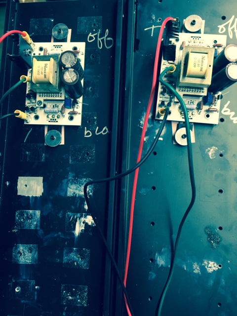

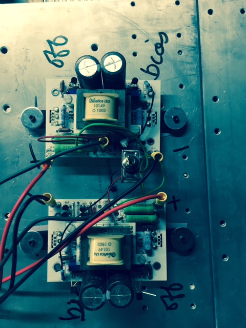

Next set of F6s ready to be cased
First is Tea Bag boards ( showing both channels) with IRFP 150s biased at 1.5A
Second shows 1 channel - 2 Tea Bag boards per channel with IRFP 240s at 1.5A. Switch allows be to change from bridge mode to SUSY mode ala buzzforbs Funny mod.
This completes my set for now. Previously showed Funny version with SS R100s at 1A on buzzforb boards.
Looking forward to comparing
Also open to evaluating other FETs
Need to put together my PSU for VFET2 this weekend
Best
Bob
