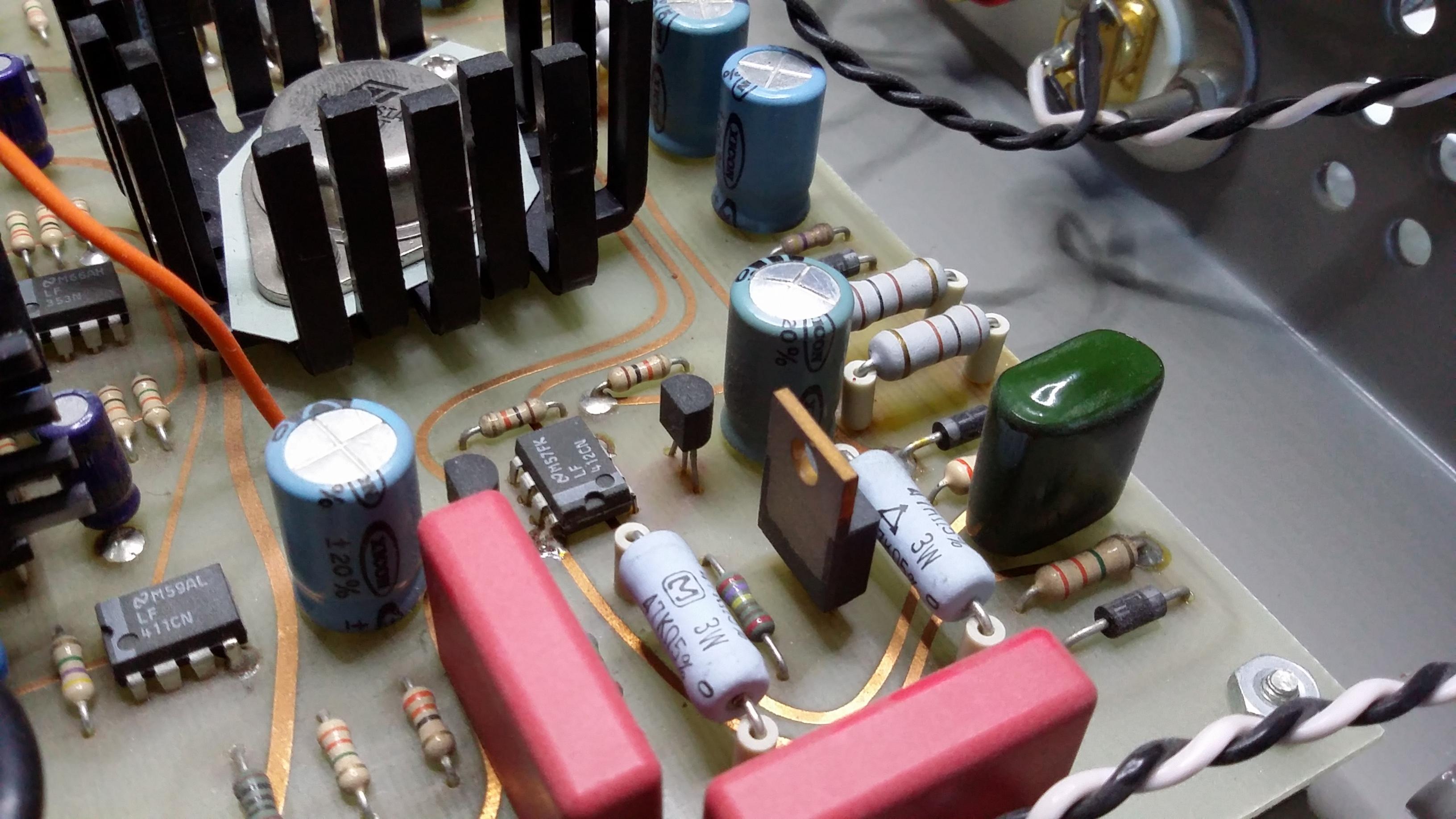

Hello Ammell,
Why dont you try the 5 watt mills at partsconnexion in Canada. I use thjem all the time when i need high wattage resistors. If i ever build a Nelson Pass amp i would certainly go for these. They are 20ppm maybe that is of no importance but they sound very good.
Just did replace some 3 watt metal oxide resistors in my Curcio Dac by these and they are way better.
Also remember using them in a Daniel preamp some decades ago.
They are a bit more expensive than the ones usually applied but you should try them asnd some other people should replace the ones thjey are using by these ones too.
Greetings, Eduard
Are you referring to these Mills resistors?
Mills MRA-5 Resistors
Thanks...
Hello Ammel,
yes,These are the ones. There is also a 12 watt model but if the original ones are 3 watt 5 watt will be enough i guess. Mount them at some distance from the board so there can be some airflow. Of course the surrounding temperature can be warm in this amp i think. But these resistors can handle some heat just take care they dont heat up sometyhing close by.
greetings, eduard

Hello Ammel,
First you could get the panasonic and then replace them with mills and tell everybody i was right. Greetings, Eduard
p.s in the photo you can see i did use them

Hello Ammel,
