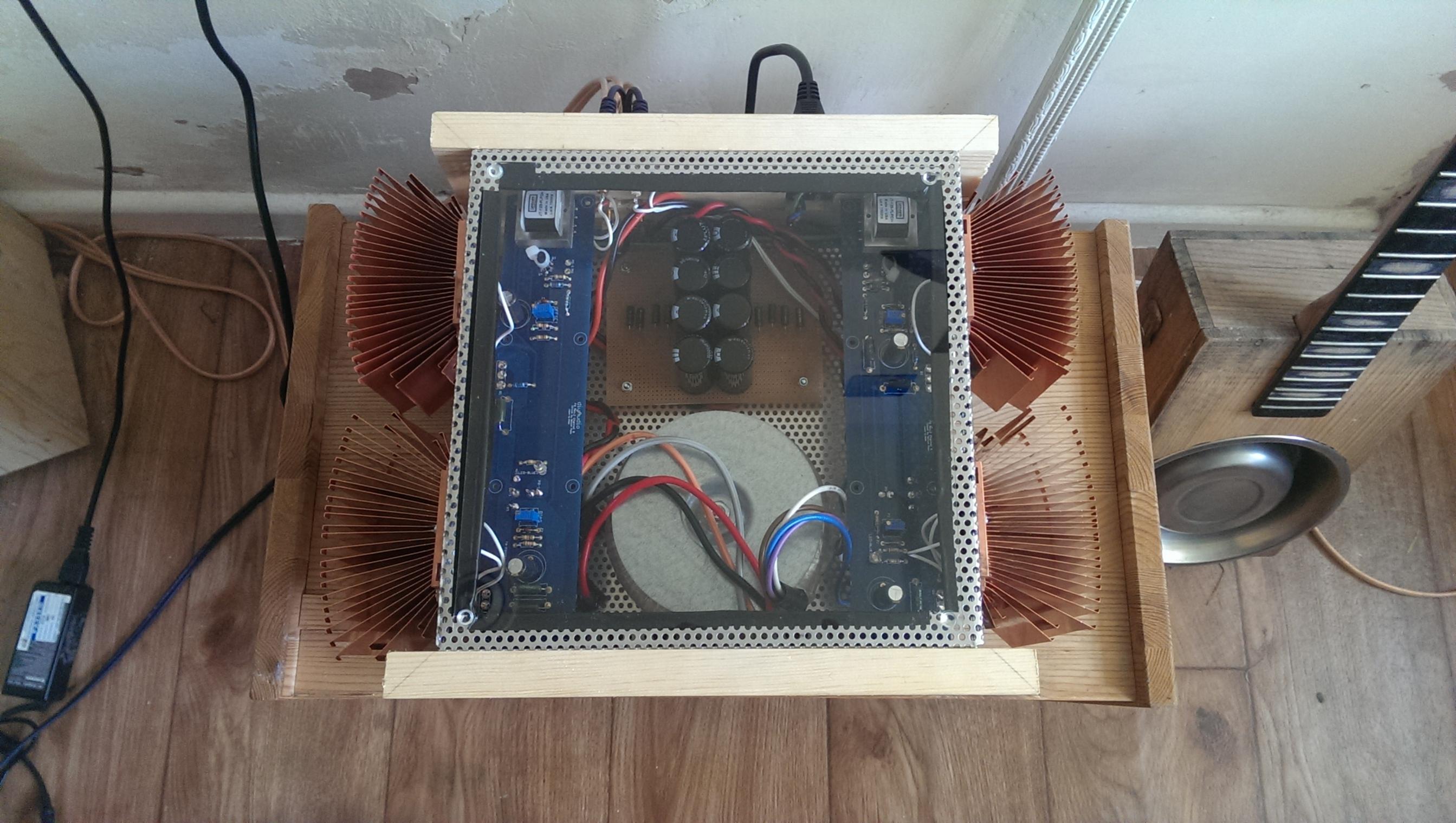

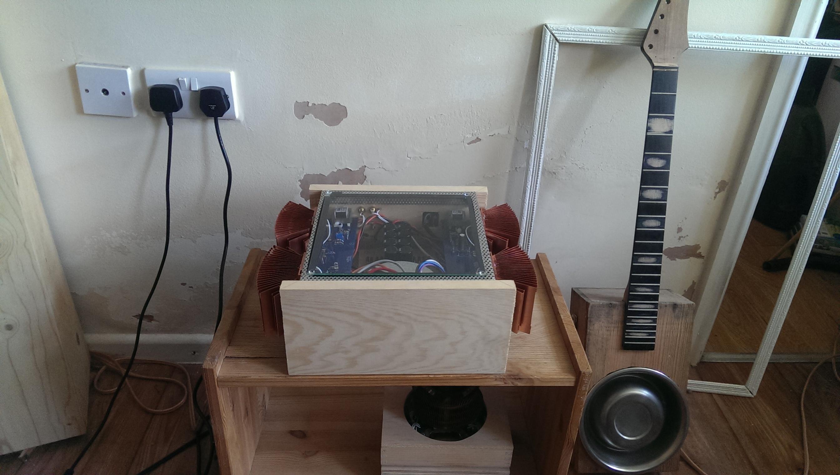

UK F6 up and running.
My F6 has come together quite conveniently. I used unconventional heatsinks to save money. At first the heatsinks I used were not adequate (ouchy hot) and I experienced a fair amount of fluctuation in bias/offset. I spread the heatsink fins out and now they run quite cool and the amp is stable (on UK mains). The F6 is driving a pair of Fostex 206EN. Only one silly mistake that I have noticed so far, I put an LED in the wrong way around. So far I am very happy with the sound! My last amp was the ACA.
I've put some photos and info of my build process in an imgur album. I'm not entirely finished yet, so I won't make a submission to the pass amp pictures thread 🙂
Thanks again for the help and fantastic diy community.
