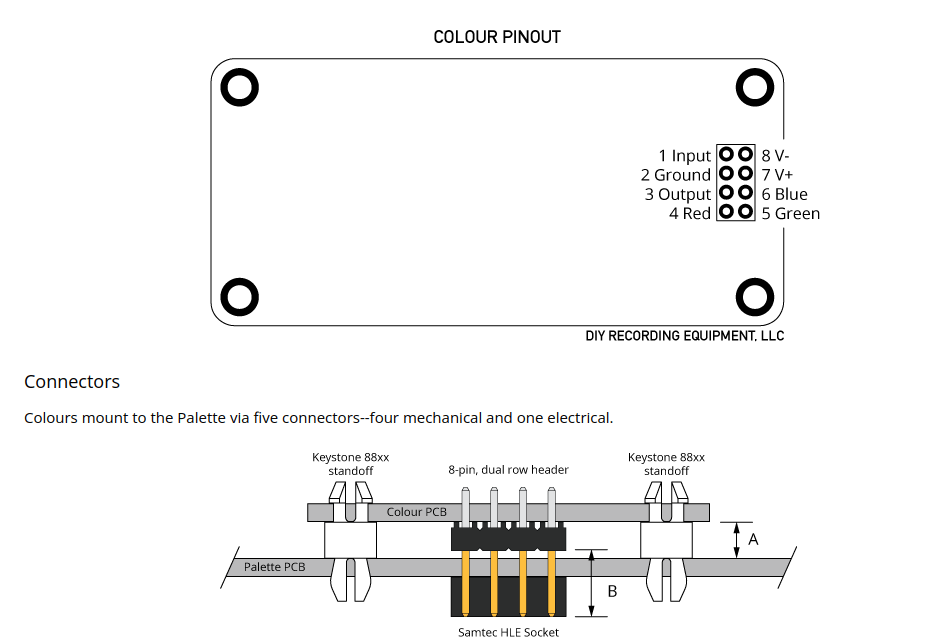

Just something i recently discovered:
DIY RECORDING and especially interesting: their "Colour Format" of small modules that can be many things.
Overall Presentation with YouTube video
Description of PCB dimensions, electrical connection, plastic locking studs
DIY Build of a Module
It feels like this forum.. but for recording equipment.
Most interesting in the light of M2X's many input cards, the connection method!
Hope some may find this interesting

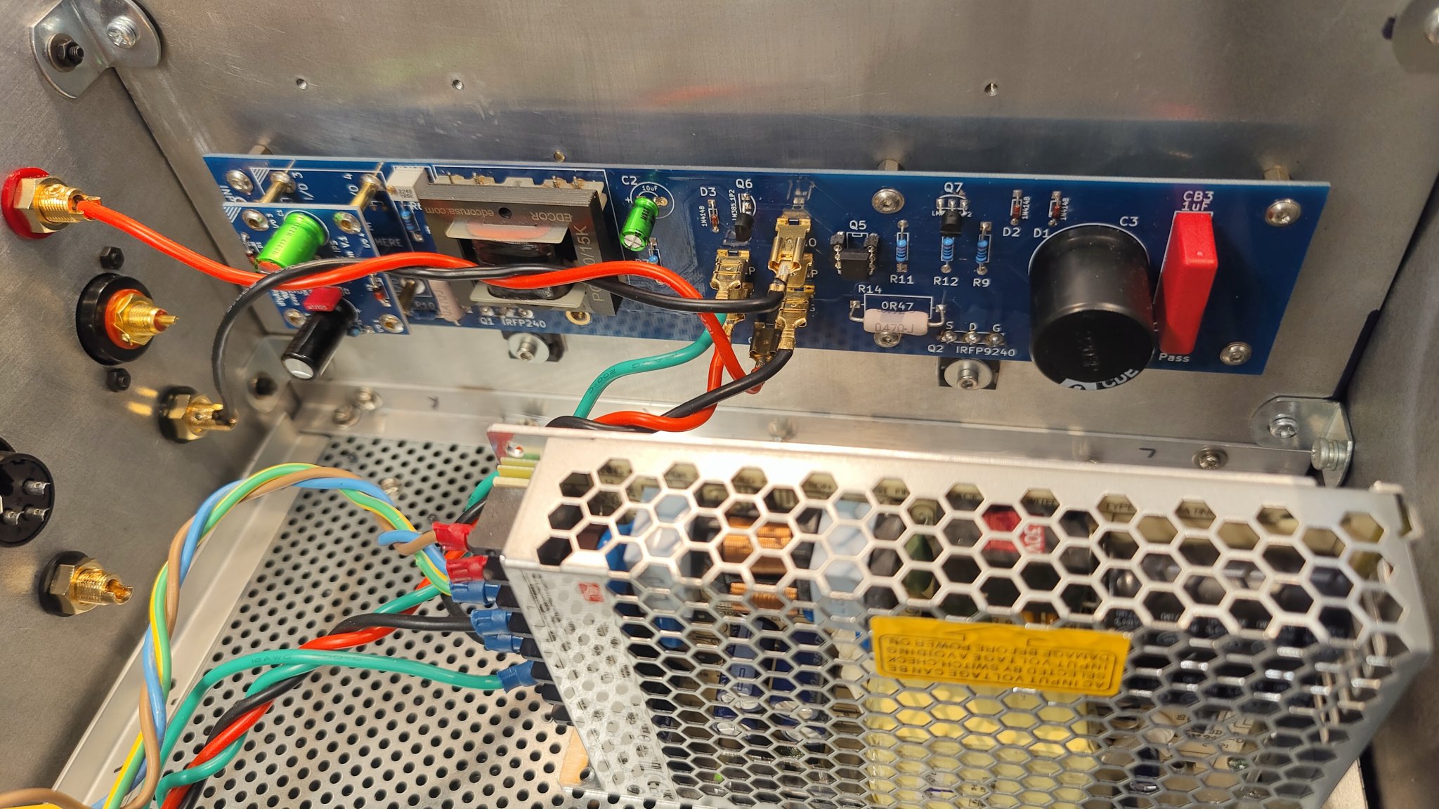

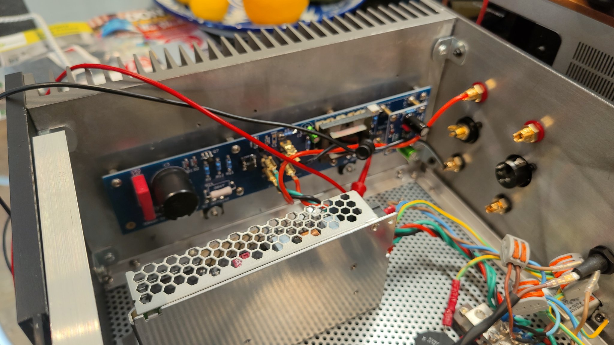

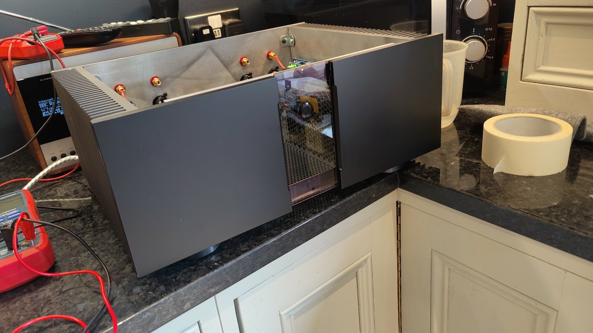

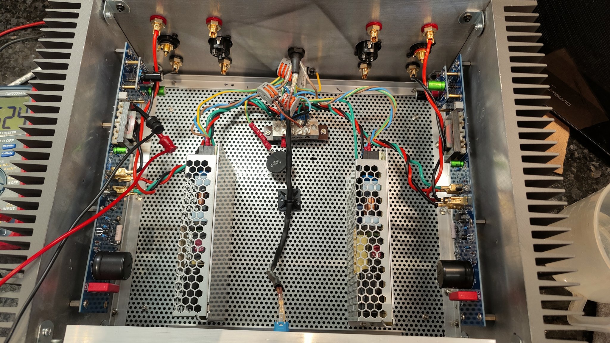

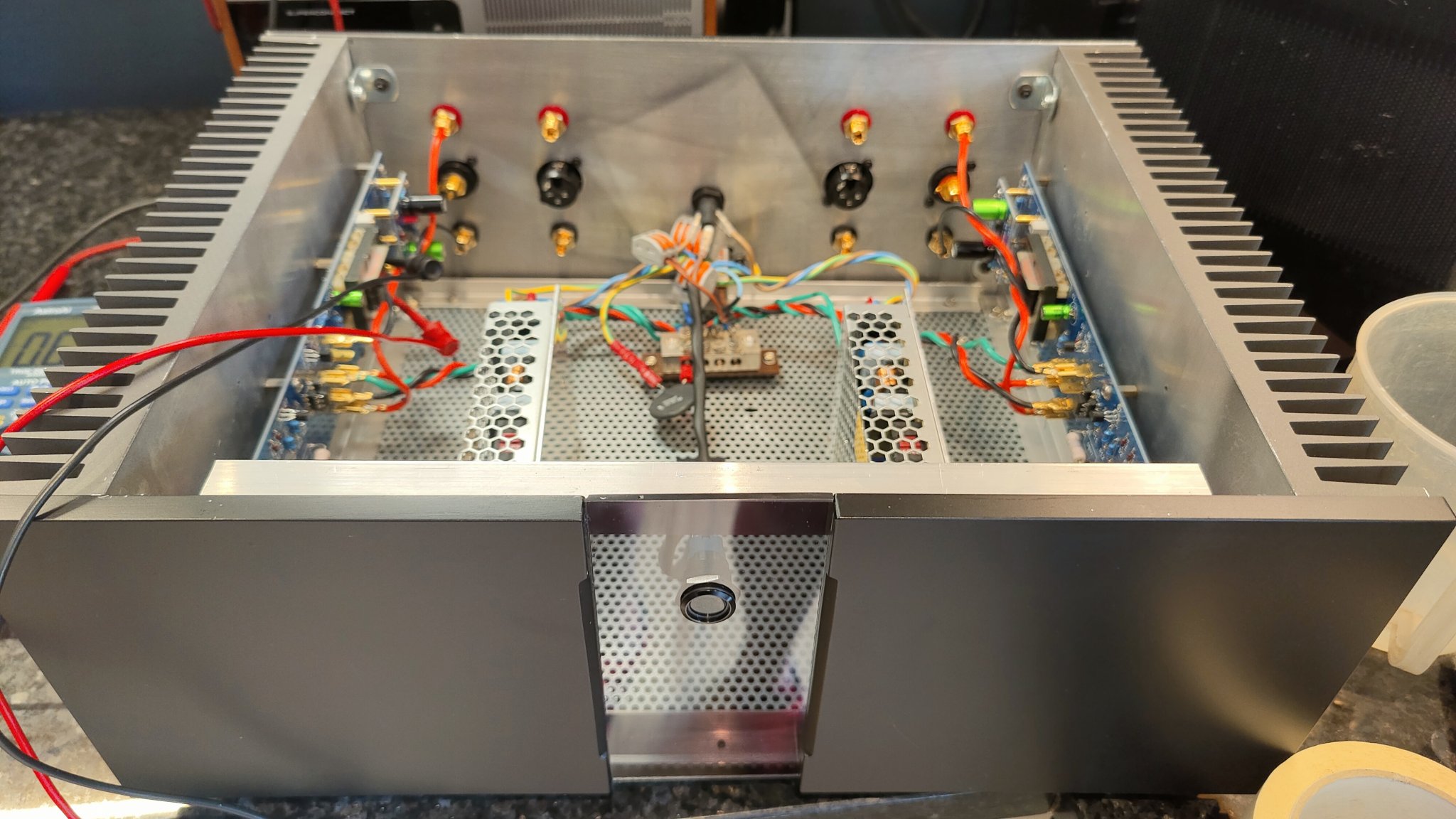

Finally got things fired up today.
Running 2 X 24v MW SMPS. May well eventually shoe horn in the big film caps I previously pictured. Got the rails nicely at pretty much band on 24v +/- 20mV.
I need to perform the blasphemy mod as I can't get below approx neg 200mV offset. Should have followed Mark's build notes from the off!
Starts off 195mV and 220mV. Lowers to 180mV and 207mV.
R13/14 voltages give 1.327, 1.342, 1.327 , 1.338 Amps. Heatsink nicely warm. Measuring about 43C with an IR, at various distances and points. My contact Thermo on my DMM seems to be stubborn to budge from 24C so I don't trust it!
Will remove the boards and do the mods to get the offset sorted.

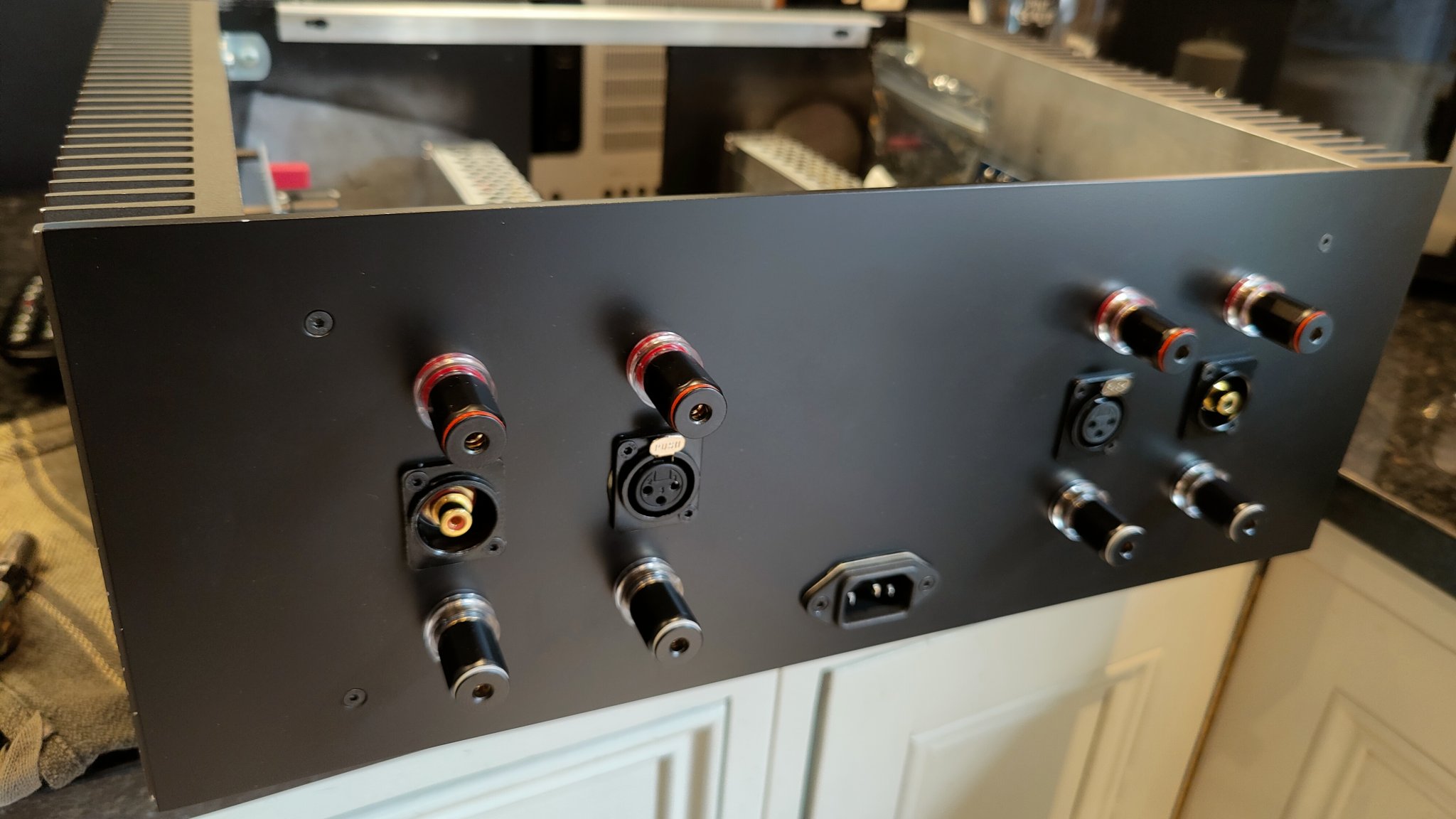

Chassis is 100pc home brew obviously apart from extrusions. Used these on an Aleph 30 and they got too hot IMHO.! Seem good here.

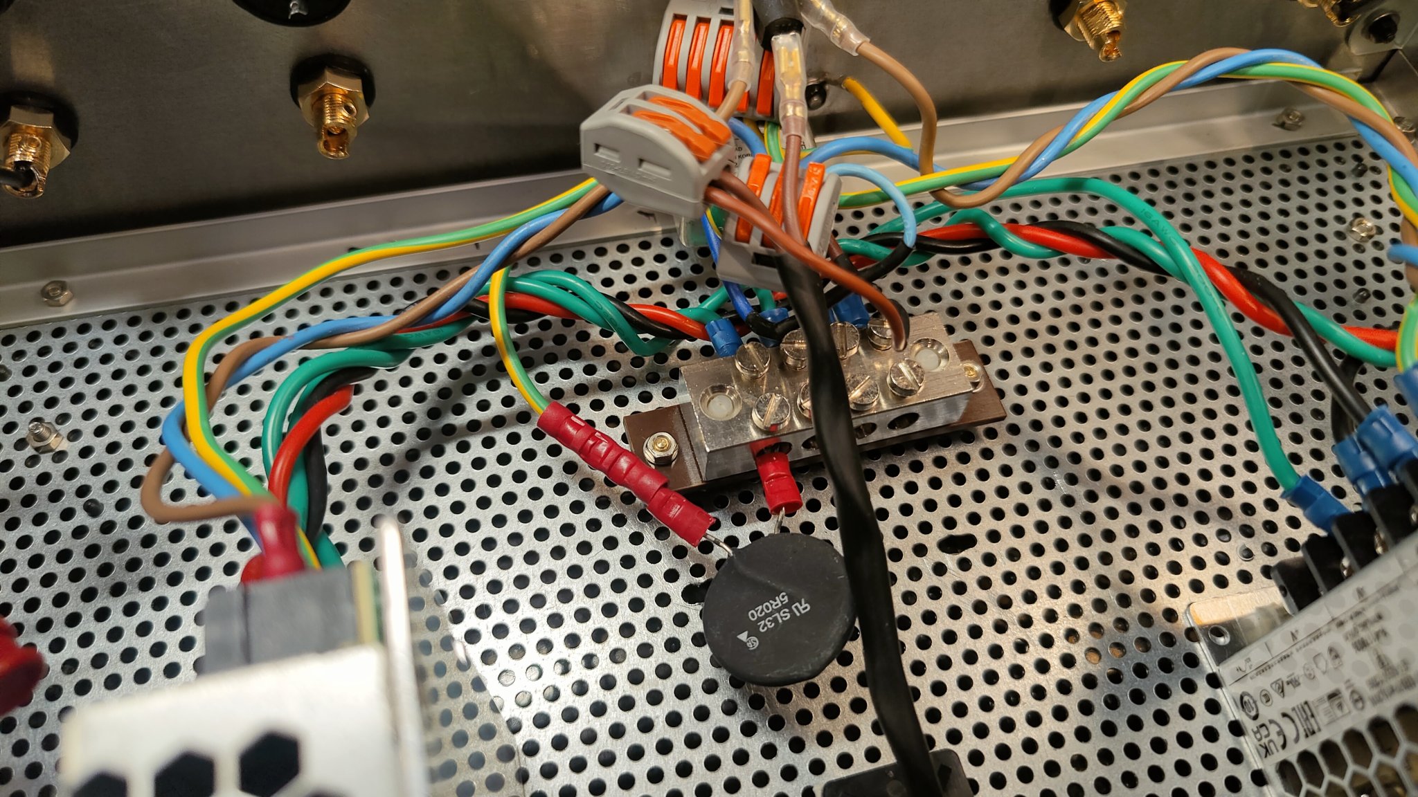

Not 100pc happy with the power wiring. Found it hard to make tidy. I know I can shorten the mains to the SMPS.
Have since added a fuse holder on the back panel.
I intend this to become a 4 channel amp with 3255 in there for bass duties on an active XO set up. Hence all the gubbins on the back panel!

What's the long term plan for securing the SMPS boxes to the amplifier chassis? Will the additional two channels require SMPS repositioning?
Hi Mark. The SMPS are screwed down to the perforated base. As I have it the additional 48v smps for the 3255 monoblocks will sit in between the LRS- 200 24.
So have swapped out the 'top' resistor network for 36k and 20k and now dialled right down to pretty much 0mv after an hour or so of warming up. Will be around 10mV cold.

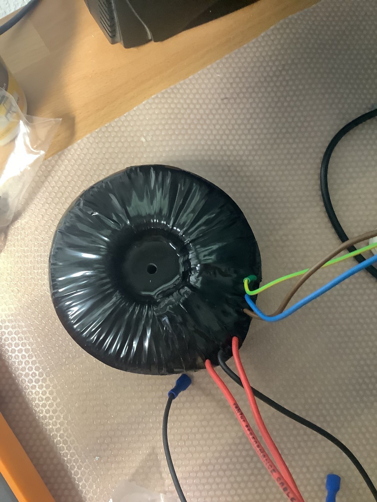

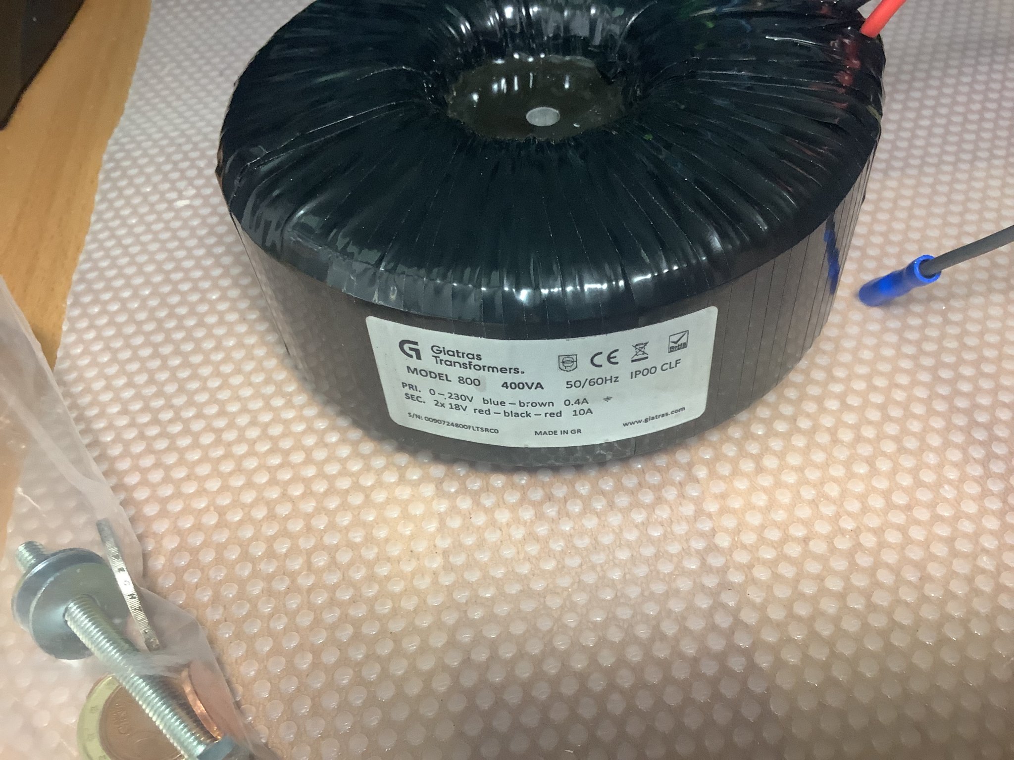

Good evening everyone. I am in the construction stage of the M2. Yesterday I received the power supply. Obviously I made a mistake and did not correctly give the details for its production to the manufacturer. I have a 230v input and 18-0-18 on the secondary with a common conductor on the negative. what I want to ask is that, first of all, I cannot use the thermistor Cl 60 and secondly, I don't know if I can give common negative to the zener rectifiers. Any help before I proceed with a new order would be greatly appreciated
So what is it you need? The sticker mention 2x 18v secondaries, which you could wire as 18-0-18v if I am not mistaken anyways.
Might help us if you describe your power supply. Is it a board you already have, or are you using a bridge rectifier and then to a power supply (capacitor bank)?
Need more info on your use case to give you specific instructions or guidance.

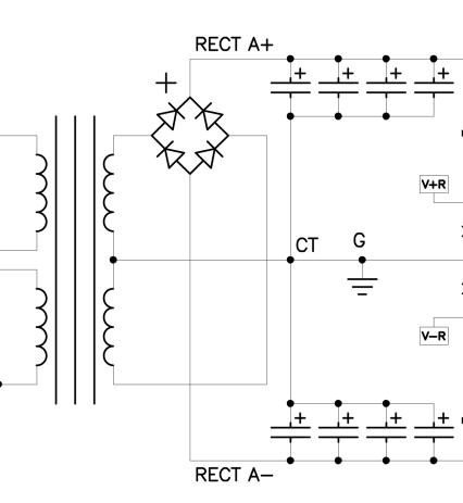

Assuming a normal Pass supply set-up - put a CL60 in-line with the Primary load (acts as a soft start), then connect the two red secondary leads to a bridge rectifier (you will have + and - DC coming out of rectifier) and using the black (0) wire, you will have your needed +24, 0,-24V to either go into a power supply board or Capacitor bank - which then you will wire to each amplifier board +/-24Vdc and a "0" Ground reference wire.
Highly suggest you wire this up and test with a DBT and multi-meter before ever connecting to your amps until you are 100% sure you have the right voltages.
@william2001 - put my words into a pretty picture.
