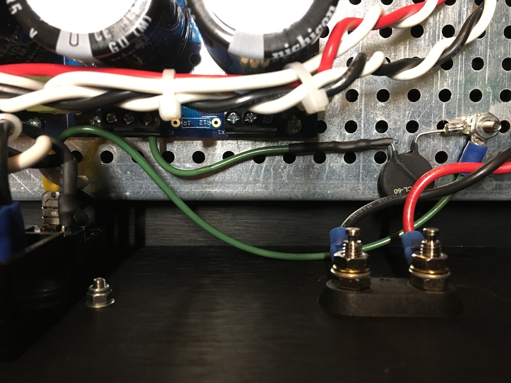

Under the speaker binding posts we can barely see the third CL60 ICL device, connected to chassis ground. What insulates the other leg of that CL60, preventing it from shorting to the perforated metal floor of the chassis?

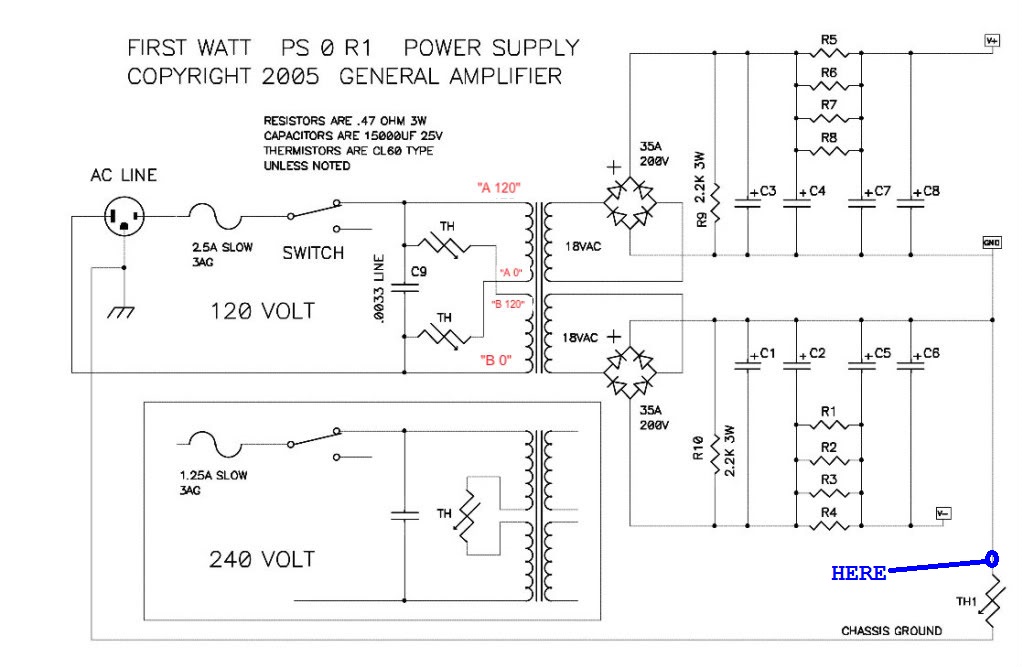

Nothing. It's connected to chassis, the other end is at the PSU GND output node. It will lift audio GND above safety earth by it's cold resistance, but can flow current if there is a fault.
Please view the attachment to #661 and find the blue text "HERE". If that node is connected to chassis, the CL60 called "TH1" is rendered irrelevant.
I can't see in the supplied photo what exactly its attached to... hopefully it's not dissimilar to this;
But yes, if the other end is also on the chassis, it's not doing much.

The PSU side of the CL60 is covered in heat shrink tubing and elevated 1/4" above the chassis. Of course the other side is bare but tied to the chassis ground via a ground lug. This is similar to 6L6's builds.
Beautiful! Thanks for the details. I misinterpreted 2 pixels of "shiny" in the photo and jumped to the conclusion that the wire might possibly be uninsulated. Please accept my apologies.The PSU side of the CL60 is covered in heat shrink tubing and elevated 1/4" above the chassis. Of course the other side is bare but tied to the chassis ground via a ground lug. This is similar to 6L6's builds.

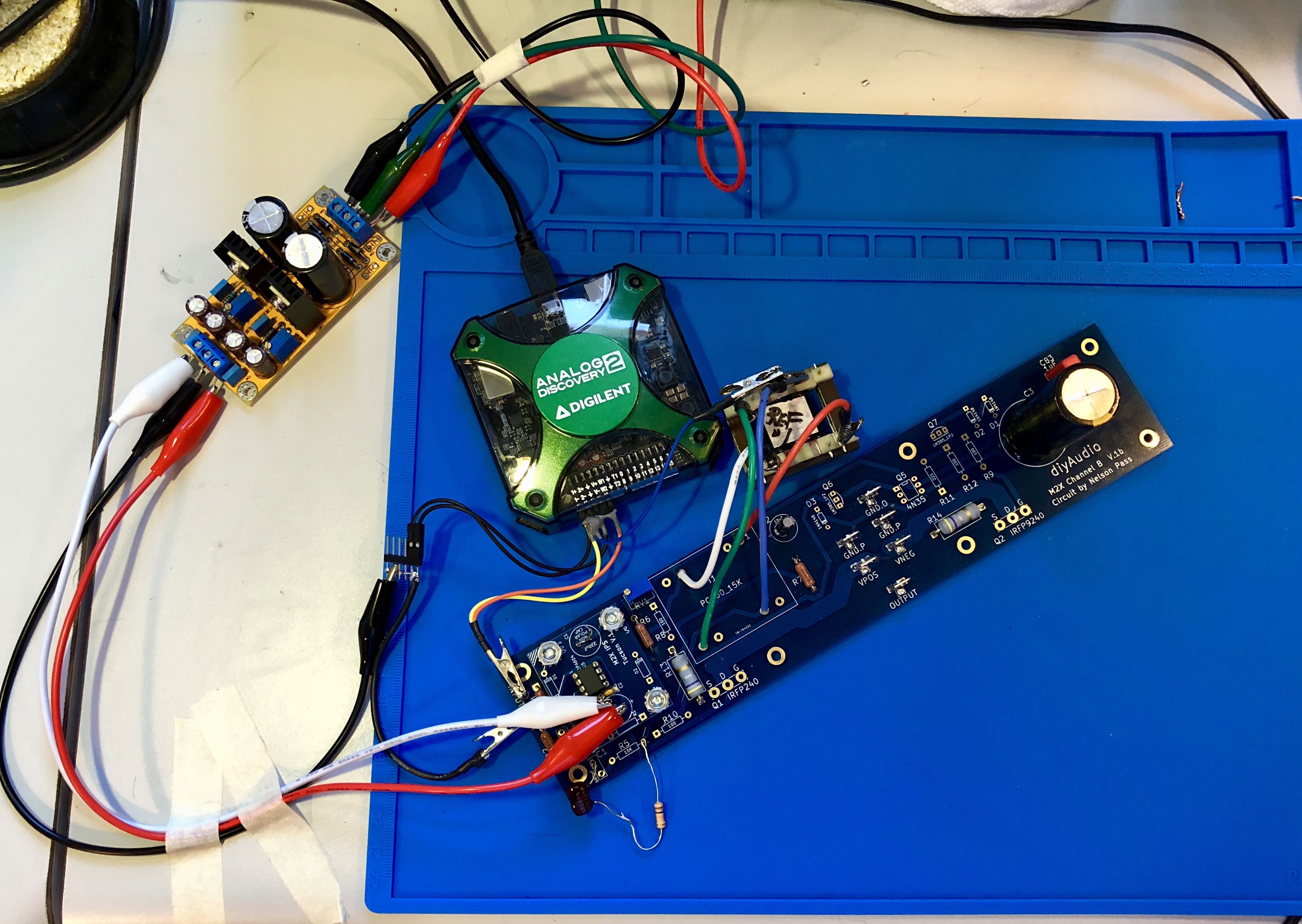

Phil, if you decide to cook up your own Zobel network to match your own Edcor transformer, I'm sure a lot of readers here would love to see a frequency response plot of your Edcor (a) using the Official M2 Schematic design and parts values of the Zobel; and also (b) using your final choice of Zobel network, that you settled upon after experimenting with the Edcor on your Analog Discovery 2, using your new optimized parts values.
You bet Mark. I built a test board using a stripped down OPA604 Tucson board powered directly from a +/- 15VDC supply and some parts (C2, C3, R7, R6, RV1) on the main board. I put test points at the ends of the R5C1 Zobel to be able to test some variations. My first measurements will be over the batch of 6 Edcors, with and without Zobel, to see what extent - if any - matching is important. Getting the data is easy but it's been too long since I've used a spreadsheet for graphing 🙁 but hope to have some plots in a few days.

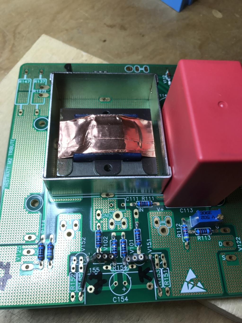

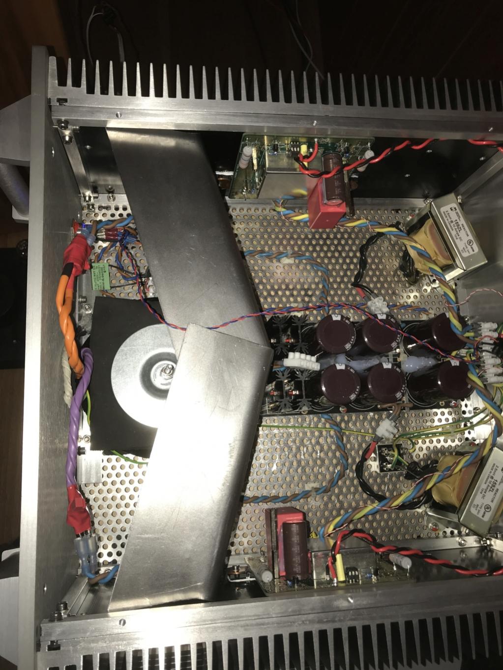

I actually had just checked residual hum / AC on the outputs of my M2 a few days ago and measured between 0.1 - 0.2 mV with my DMMs.
I have built my M2 on JPS boards, with the Edcors centrally mounted.
The following hum-reducing measures have been used:
- grounded TEKO shields over the Edcors
- oh, and I put a copper belly band around the Edcors as well ...
- mains transfomer (Toroidy 20V / 500 VA with grounded shield) rotated for minimum hum
- shield between transfomer and rectifier bridges on one side, PSU and amp boards on the other side (see attached photo). Shield is made from magnetic steel.
On the other hand, I have a CLC PSU with the chokes mounted at the rear of the chassis. That may give a bit of additional hum, though holding a steel sheet between chokes and amp board, I didn't hear a significant difference.
With 0.4 mV you would be within FirstWatt's noise spec of 500 µV.
However, I have 100 dB/W sensitive widebanders, and with my 0.1 - 0.2 mV residual hum I'm still hearing a faint hum with my ear directly at the Fostex widebander. It's practically silent with the ears at 30 cm from the driver, even in a very quiet room - good enough 😀

Hi Claas,
Thank you also for the info. For the belly band, is that some kind of copper foil tape?
Would you have a reference/part for that?
