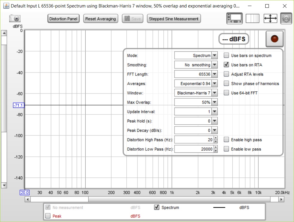

You need to use the setup to set the correct sound card interface and input channel (left vs right) and output channel and amplitude. I use Java driver rather than ASIO.
In REW, use the RTA function and click on the "Gear" to adjust settings and choose spectrum, choose other parameters like filter, smoothing etc. I like 0.88 averaging or 0.94 averaging and 32k to 64k points, no spectral smoothing, Blackman Harris-7 window function. Here is a screenshot of the typical settings I use:

Although I have not tried it personally, you can see the checbox for phase in the setup dialog. "Show phase of harmonics",
