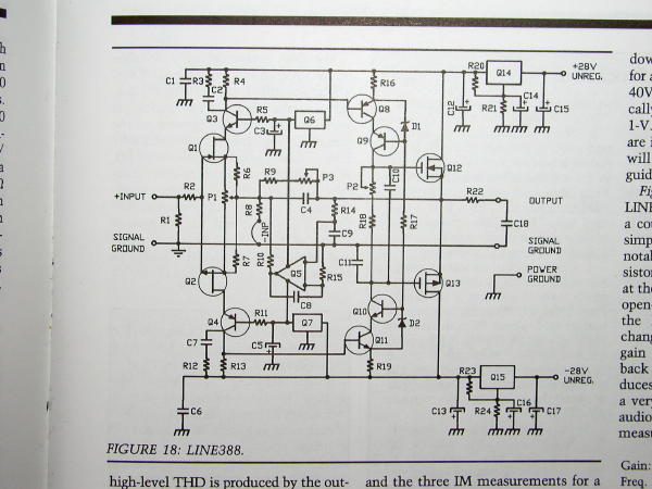

Maybe I made mistake, maybe not. It's not exactly the same circuit but pretty close. It appeared in 1990 issue of Audio Amateur.

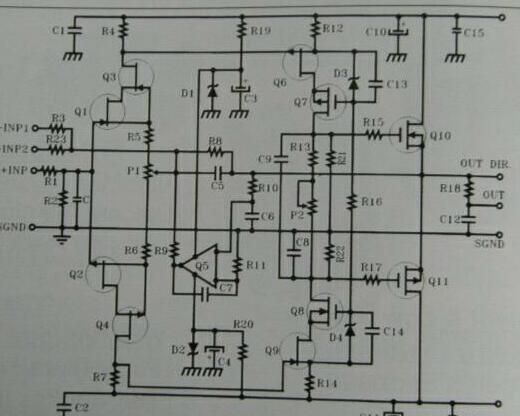

The schematic came out of May 2002 issue of Audio Electronics
Ummm..... gentlemen. These are not the same design. Look closer... No BJTs in new one. A very worthwhile change. I guess that's why he called it The All-Fet Line Amp. The devil is in the details as they say. Maybe some of you will go read Mr. Borbelys Jfet articles someday......

To me, these circuits are pretty different. Swapped FETs for bipolars, used different (newer) regulators to power the thing, different bias points, etc. The topology may be similar in principle - one could make a "BOZ" with bipolars, but no one mentions that and I don't think anyone has played with such a creature.
