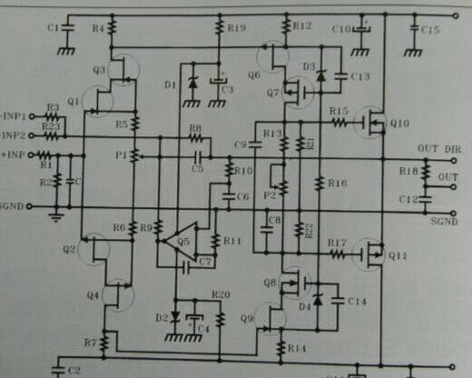

DC coupled Borbely line stage anyone.
Just a few parts.....
i was just looking at that borberly line stage...
i went hunting for something DC coupled and was just about to ask you guys about that one. it is complementary however, in fact isn't it a discrete op amp? i have nothing against either but i thought you guys were die-hard SE zero-feedback fanatics... 😉 i bet it sound pretty good though... better than any IC at least.
ok, so i guess we will NOT be using opamp-based regulators for this design... passive regulation it is... i just wish it was more efficient... 🙄
p.s. i notice borberly calls his SE stage "very musical" but he doesn't use my preferred word, "accurate." not that the word "accurate" means much (strictly speaking, neither does "musical") although with preamps i think we are in a better position to judge accuracy by comparing with passive pre's or even straight wires.
Oh really???!!!!
The schematic came out of May 2002 issue of Audio Electronics! I have been following Mr. Borbely's work for longer than 15 years.
THIS IS NOT A 15 YEAR OLD DESIGN..... maybe we need to sign you up for GRollins sensitivity training course. I posted it to show how rapidly a design's complexity could increase when you want everything included. It actual is not a bad design and Borbely is right on up there with the lastest parts and semiconductors. I watch him just as closely as Mr. Pass.
