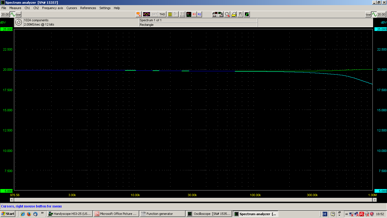

While waiting for the Beta tester to build (he already has all the parts from us), I thought I would make an update.
Quite some time ago, we were challenged to make a High Power DAO to drive the Hifiman HE6 :
http://www.diyaudio.com/forums/head...lass-zgf-headphone-amplifier.html#post3293956
Well, we took on the challenge, and I tested the DAO HP today.
It has 2SK1529 cascode, +/-35V rails and 330mA bias.
Works first time. Almost boring.
It is unstable without load, so I used a somewhat heavy handed Zobel at 600kHz.
It is still -2dB at 1MHz as is, and hardly changes with a 27R load.
I could have use less Zobel to get even higher bandwidth.
But with so much power on hand, I think I'll leave it as is .....
Patrick
PS Green is input, Cyan is output.

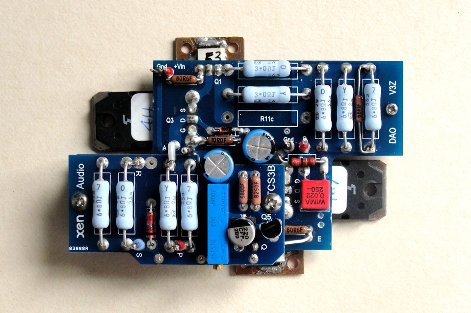

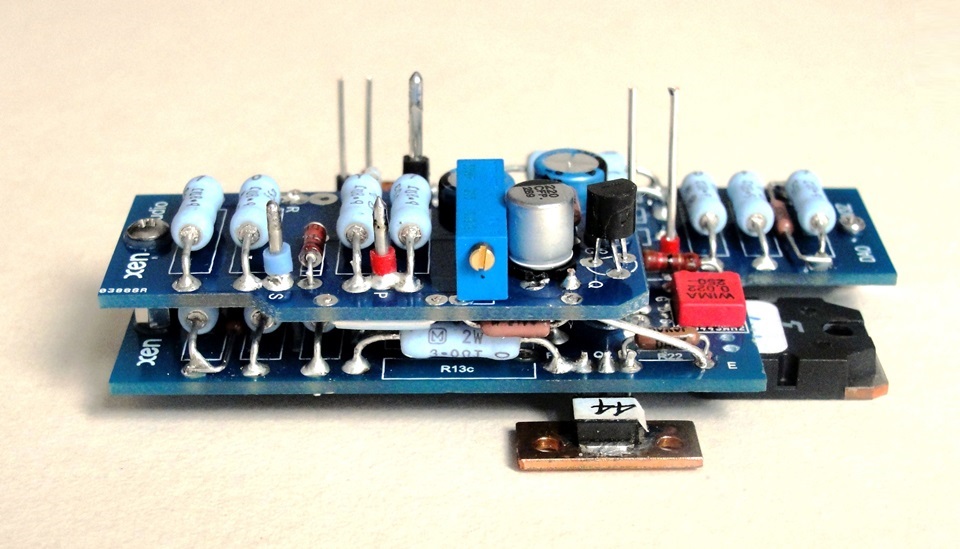

Couple of photos.
Patrick
Patrick

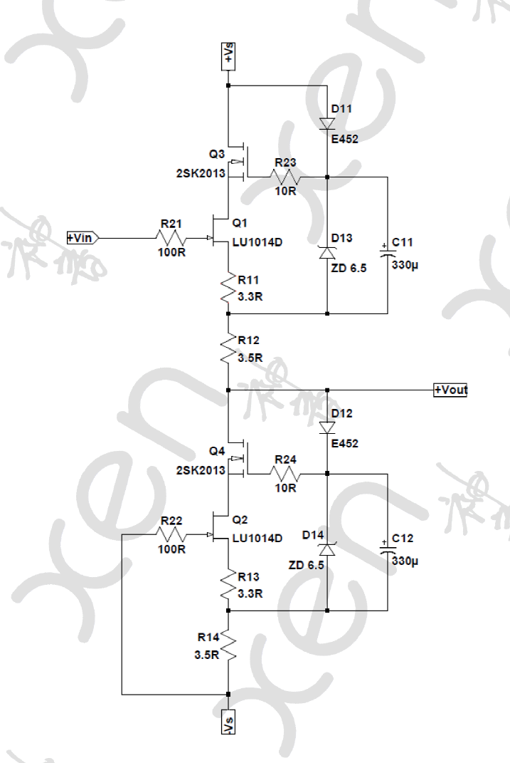

Is there any alternative N-Channel misfit that will work in this circuit? Obviously 2SK2013 is getting hard to find these days, especially matched or in the quantity needed to get a good match.
Would FQP3N30 work? Or even IRF610 or 510?
I have not tested others, so cannot guarantee the same triode cell characteristics.
But if you were to try FQP3N30, you need to change the Zener to 9V1.
And you might need other Zobel values for stability without load.
The exact value you need to test (with a sweep sine func gen and a spectrum analyser).
Patrick
Patrick
I wish to refer to post #205 and point out a small change which is at least necessary for any public build.
My apologies for not mentioning earlier.
If you look at the photo carefully, the TCS daughter board has been changed to TCSV3B.
B stands for bipolar transistor (unfortunately).
The reason for the change is that in the schematics shown in P.3 of :
http://www.diyaudio.com/forums/head...ss-zgf-headphone-amplifier-2.html#post3297425
the 2SJ74 ued for Q5 will see more than 40V.
This is above the rated Vds for the JFET.
One solution is to cascode it with a 2SJ103, but even that gets marginal for the standard DAO.
For the DAO HP it is still no go.
Hence the need to change Q5 to 2SA970BL, also for the standard version.
This will be revised once the Beta Tester has finished his build.
Patrick

Hi Patrick,
I'm studying a version of this follower for an 8 to 25 ohm, 110 dB/W compression driver, and plan to compare it to a DAO using the ZV9 triode cell. Do you recall the values used to make the 500 mA cell described in Part 2b? You mentioned experimentation and simulation brought you to some values, I'm hoping to use those as a staring point.
Adam
