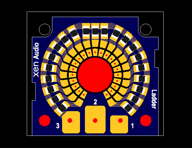

Just an update.
While waiting for WK to organise parts for the Beta tester (he is 150% loaded till August !!!!!!!), I have been looking at one aspect of the DAO SE specifically, namely the attenuator for volume control.
One of us has done a comparison recently, between a pot with carbon tracks (e.g. ALPS RK27), pot with conductive plastic (e.g. Vishay P11A), switched attenuator series type, and switched attenuator ladder type. The switch used for the experiment was no fancy ones, just 6P4T 2-deck selectors.
https://www.monacor.ch/itemcard.php?itemno=RS-246
The clear winner was switched ladder with Dale resistors.
There is a very comprehensive explanation of different types of switched attenuators by Gold Point :
Stepped Attenuator Types
There is also a large selection of both the series and ladder type attenuators on the market, starting from 10USD and ending somewhere over 1000USD. Or you can just buy a 4-deck, 24-position rotary switch (ebay, Elma Shallco, Seiden, Grayhill, …….) and a bunch of “audiophile” resistors and make your own. The chances are that you will end up with spending about 100USD+ and a volume quite a bit bigger than a normal ALPS RK27 or TKD CP2500, which Mark uses for his DAO. And the major cost driver is of course the 4-deck 20-position rotary switch, unless you go for one of those from ebay.
But then I found these, and I like the idea of using the mechanics of a normal pot as rotary switch:
WiredState Audio Community • View topic - Need advice on a TKD stepped series attenuator
°ëÔ²±ú·¢ÉÕ¼¶RH2702_A100KÖ¸ÊýÒôÁ¿µçλÆ÷27ÐÍË«Áª²½½ø¾«¶È³¬ALPS-ÌÔ±¦Íø
Dact Type SMD Stepped Attenuator 21 Step | eBay
The second one BTW is not from ALPS, but a Chinese invention using (probably fake) ALPS RK27 wipers and mechanical parts.
Actually a clever invention.
The trouble with all these solutions is that they are all of the series type. It is already a squeeze to fit 21 SMD (0805) resistors into the space available, and a stereo pot has only one wiper per channel to offer. If one would accept a series attenuator solution, then the easiest way is to buy a RH2702 and change all the resistors to Susumu 0.5% thin film.
Alps RH2702 Audio Potentiometer - Boards | Kits | Components | Modules | Tools
Susumu Dünnfilmwiderstände - SMD | Mouser
This also allows you to choose the tracking accuracy, thermal coefficient, total impedance, maximum attenuation, pot taper, …. yourself. How nice. 😉
But luckily, you can also build a ladder with one common wiper shared between two contacts :
http://tubecad.com/2011/04/26/Ladder Attenuator.png
And there are two sides on a PCB to mount resistors, right ? The tricky part is to find 0.7mm of space on the backside of the PCBs, which is still possible but requires machining of adjacent components. 🙁
We’ll see how far I can get in a few months from now. An ALPS RK27 is on its way.
Patrick
