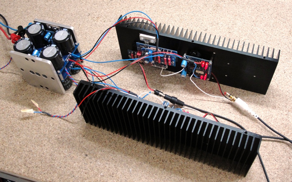

A few more images:

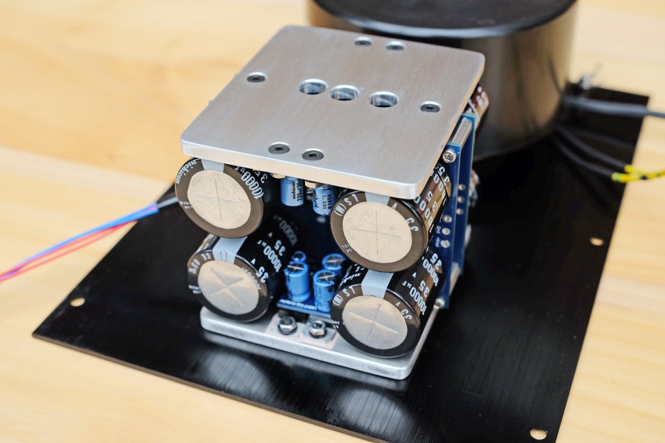

'Da Bomb', the capacitor bank with integrated cap multipliers (four of them!)

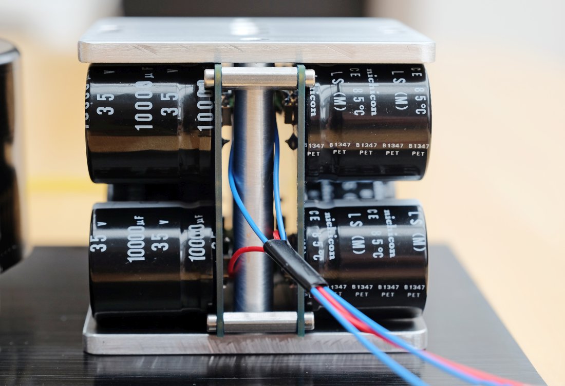

Heat spreaders top and bottom connected with aluminum rods to transfer the heat to the bottom plate of the case.

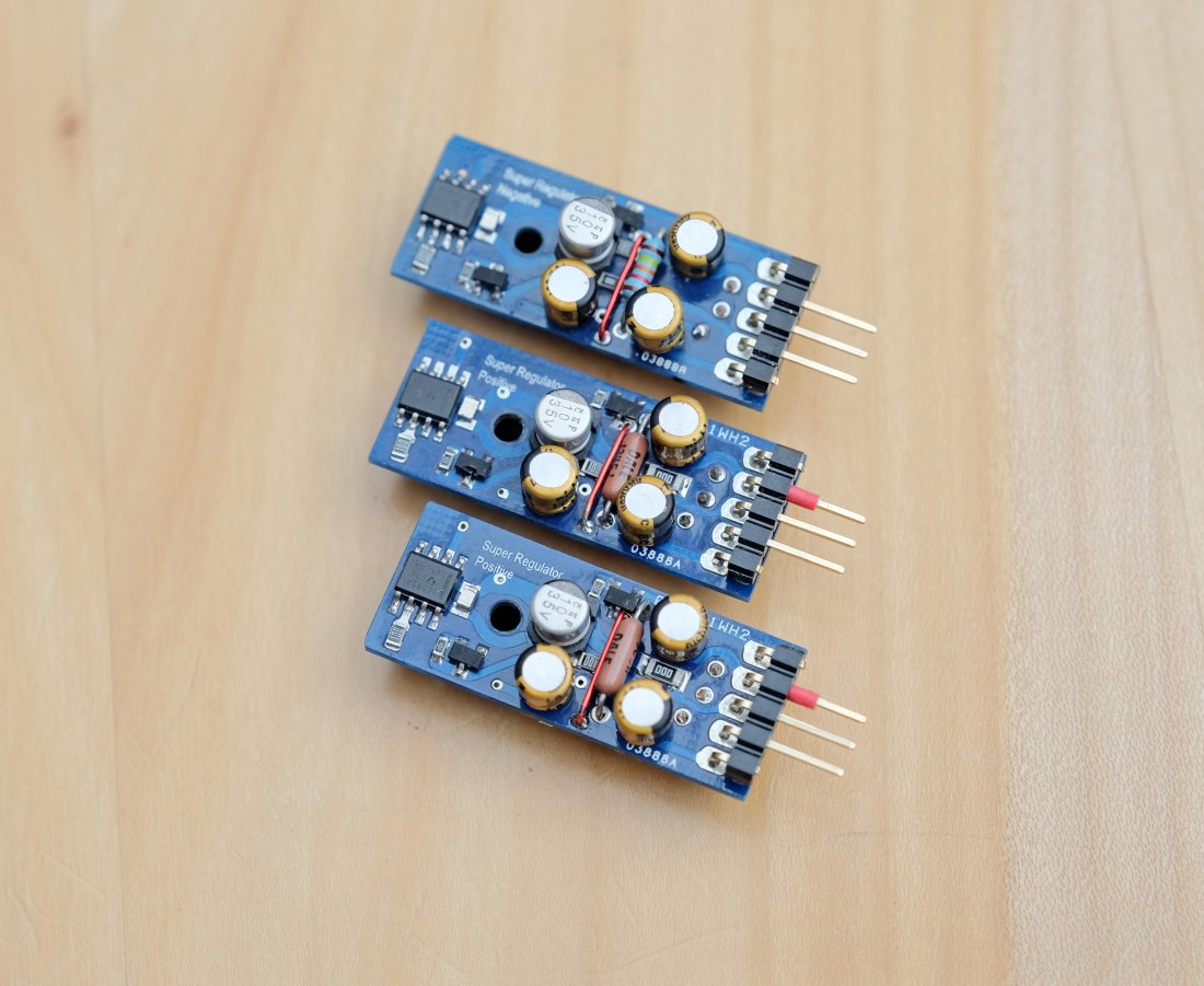

The cap multipliers are 317_337 based as used in the F5-HA.
The Didden Regulators are not the standard version but a XEN modified version.
Jan was given the first ever pair a couple of years ago to measure / treasure. 🙂
The pin out as shown by Oliver is 78xx / 79xx compatible, with two addition optional sense pins.
Overall size is ~ 13x35mm, with a TO220 power device which can be mounted to a heat sink at the back.
You can see the mounting hole clearly on the PCB.
It uses degenerated 2SK209s for the two CCS, and a JFET input opamp such as OPA1641.
The LM329s are replaced by 3x SMD red LED in series.
And the power supply to the opamp is decoupled at HF from the regulator output.
This, IMHO, enhances stability greatly, so that it has no issue with low ESR output caps.
The audio caps I tried such as Nichicon KA or Elna Silmic II are all fine.
Patrick

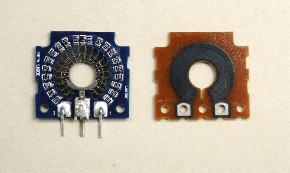

XEN modified RK27 Ladder
The idea was described one year ago.
http://www.diyaudio.com/forums/head...ss-zgf-headphone-amplifier-4.html#post4347276
Now finally the real thing, shown next to the original ALPS carbon track wafer.
The build was actually much easier than I anticipated.
And only one word for the result ..... transparent.

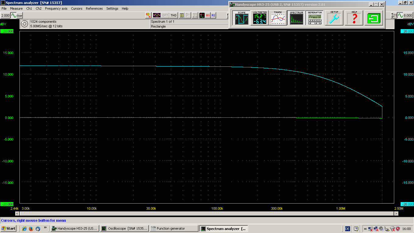

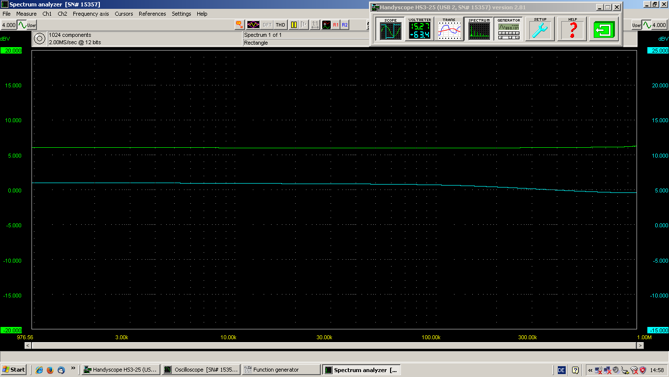

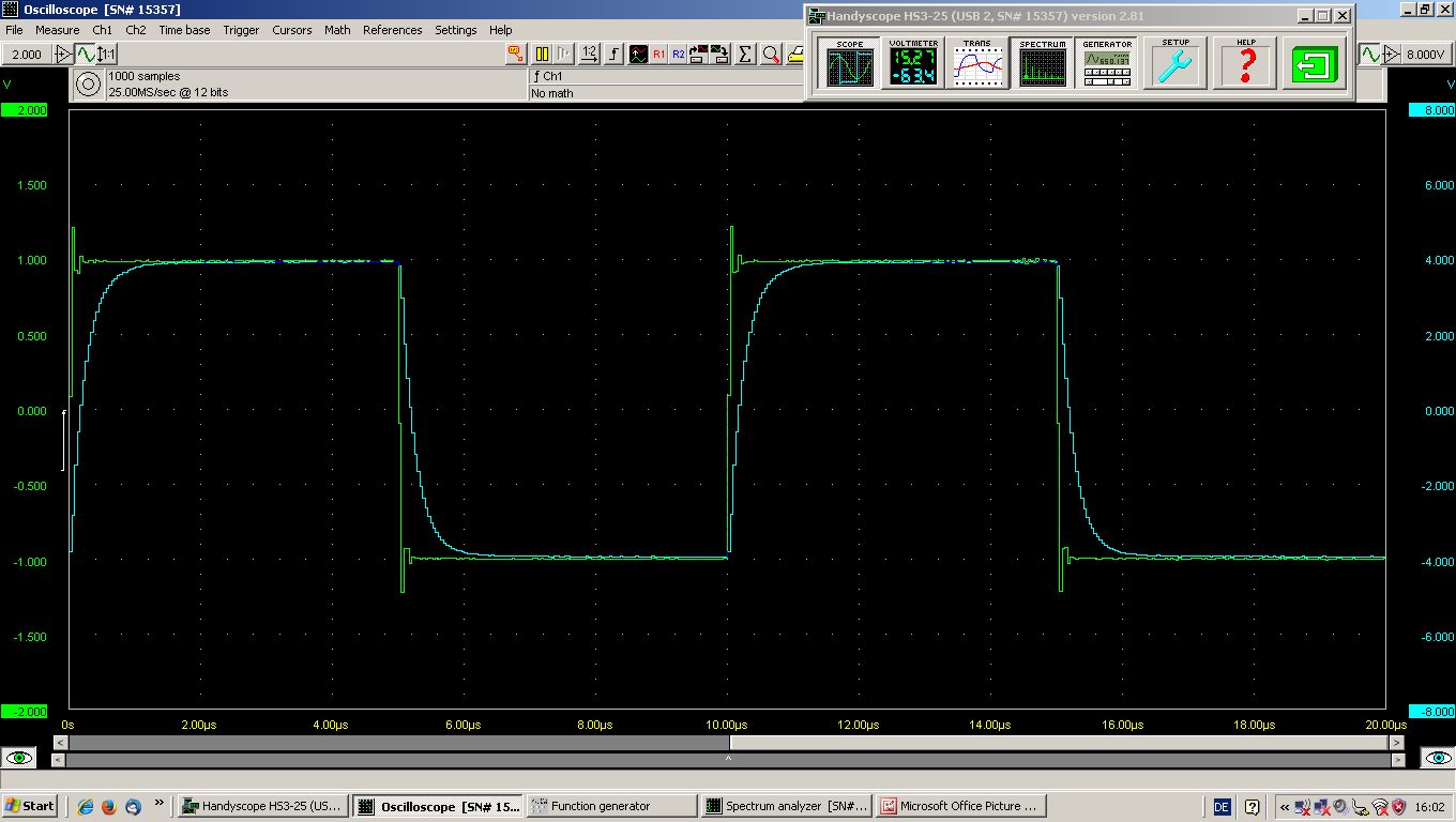

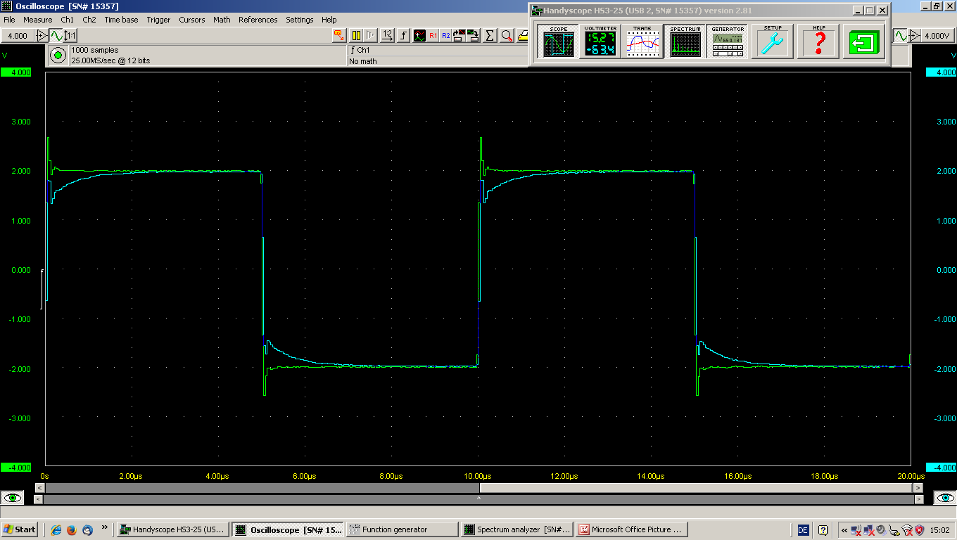

Stixx's proto is singing.
Noise issue with the HAGS now completely solved.
Background totally dark.
HAGS bandwidth is 700kHz -3dB, nice first order drop.
DAO TCS has 400kHz bandwidth at -1dB.
(My func gen cannot go much higher without large overshoot)
So everything works as planned. 😉
Patrick
