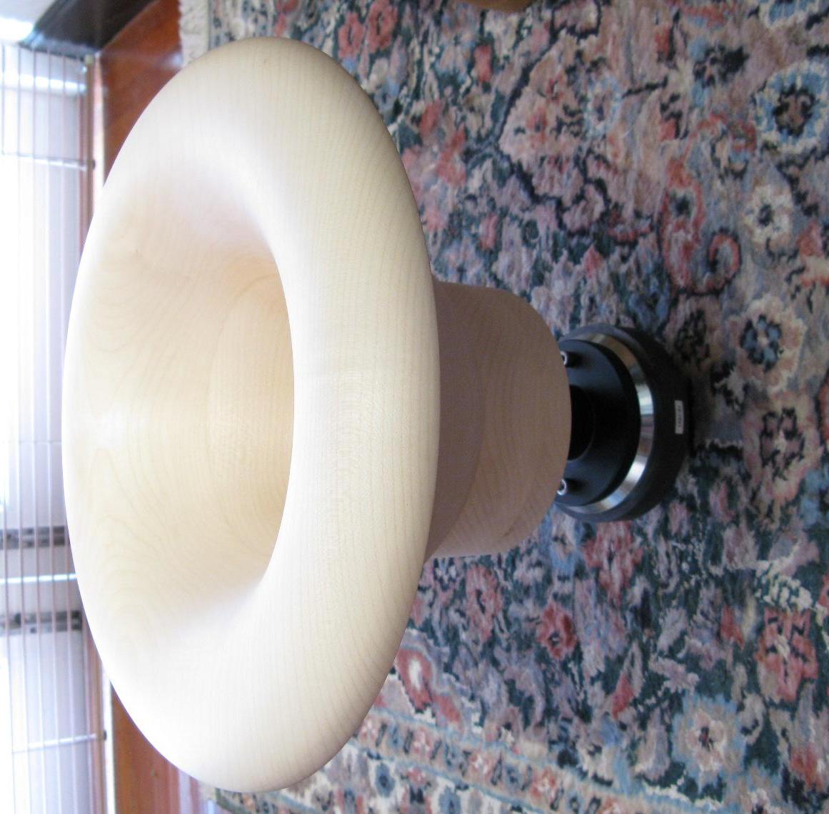

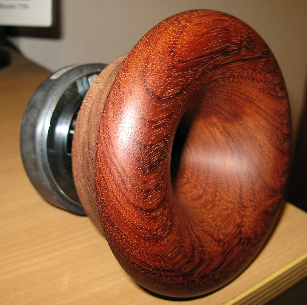

I like BMS drivers, the BMS 4550 is a 1" driver.
Can you help me with more details how to connect the drivers to the Multi Cell Horns?
Last time I use a round horn with 2" but BMS 4550 is 1".
I use a adaptor from Beyma.
No problems with that.
Sounds also good.

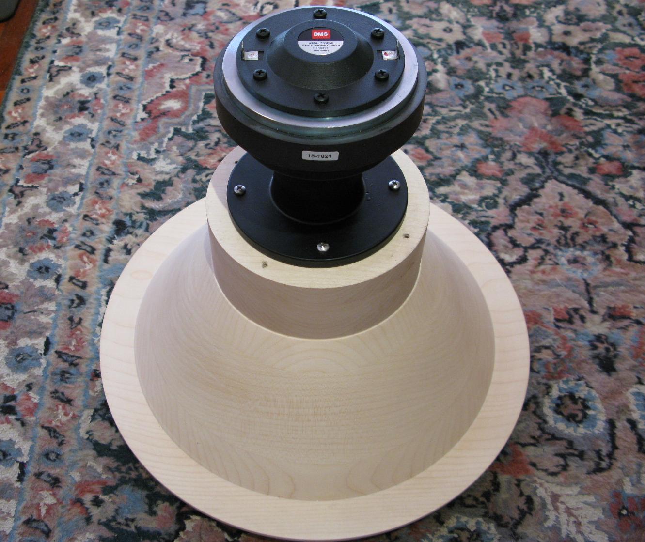

Thanks Petter,
for your technical advice.
So, I am looking for a 2" driver.
What is the frequenz bandwith of the multicell?
500 Hz to 3 Khz or can I go even higher like 10 Khz??
My wood horn goes from 800 Hz to 20 Khz with the BMS 4550.
Any comment??
Thank you.
Thanks again Petter,
Okay, now I understand the system.
So, I can use a midrange compression driver.
There is a good 2" BMS 4591 midrange driver - 200 Hz to 9 Khz.
Use best arround 400 Hz to 5 Khz.
With a crossover I can go 400 Hz to 3 Khz.
Than add horn tweeter like you.
I also have a very similar horn tweeter like you.
Made by a friend.
Also uses a BMS 4524 driver.
I like BMS because, it sound really great, for much less money than the "big boys".

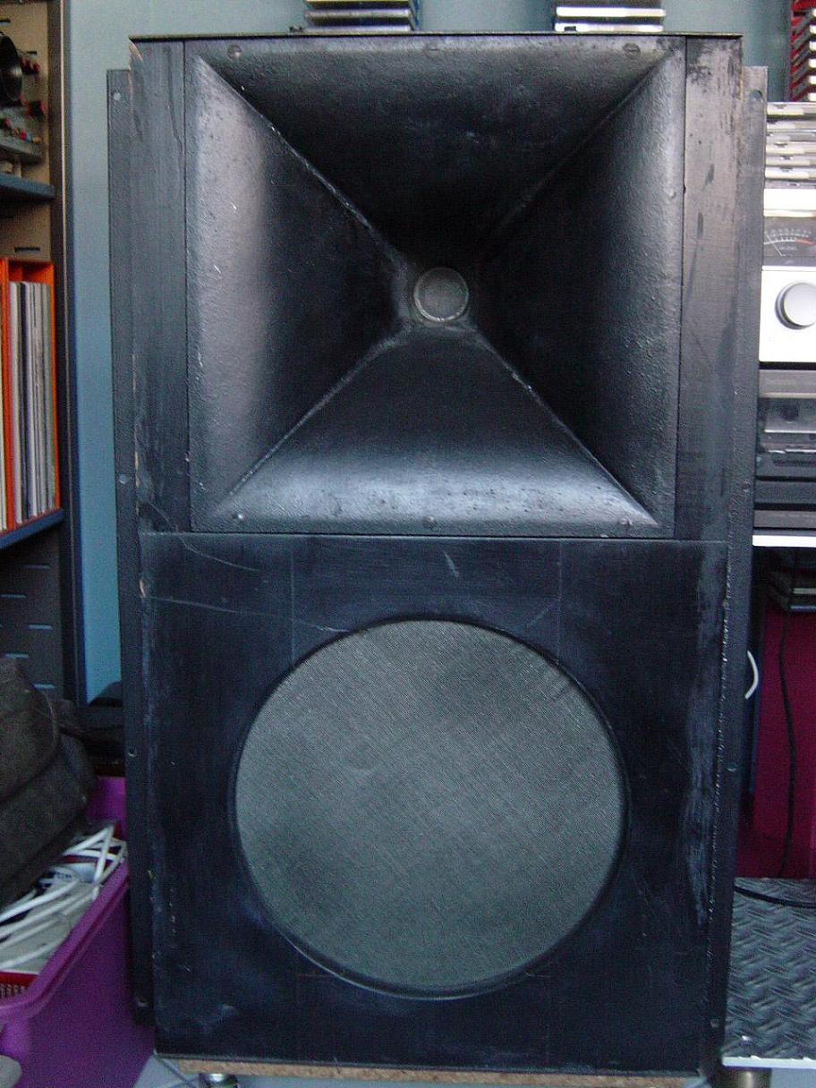

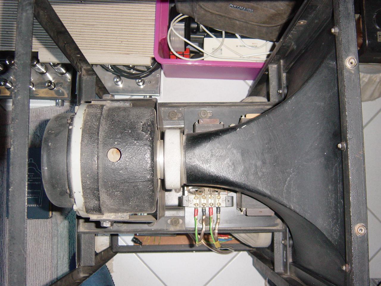

Hello Petter,
is it possible, that you can help me with the spreadsheet for a "single" cell horn?
I have long time the idea, to build a horn like the Klangfilm horn.
As sample see the horn at my Klangfilm KLL 430 speaker.
The horn in the front is arround 400 mm x 400 mm.
I hope you find some time.
