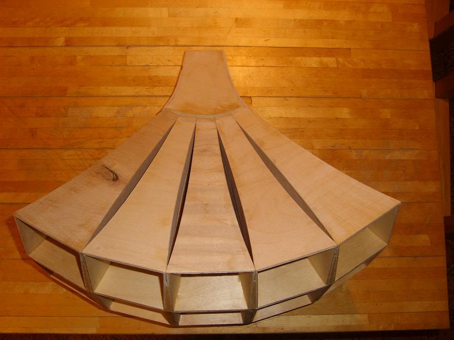

I´m almost done with my second multicell build, this time it is a pair of 15 cell 285Hz horns with 2" throat. Built the same way as Petters but with a slightly different throat construction, this time I filled the voids between the cells with polyester resin and covered the exterior with resin and fibreglass instead of trying to damp the walls with the stinking bitumene/asphalt goo that I used on my old 1" horns. This made a major difference in damping out vibrations.

I danged three nails through the mold, sticking out about 1-2 mm, this is not an issue since the markings will end up on the back side of the cells.
It is really simple to calculate a multicellular horn, just divide the cross section
area with the number of cells. One has to bear in mind that the sides do not
get as long as for a single cell horn because each cell do not bend as much.

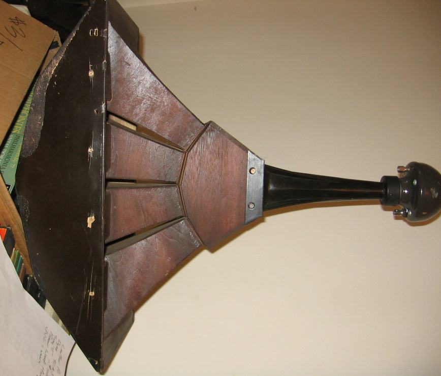

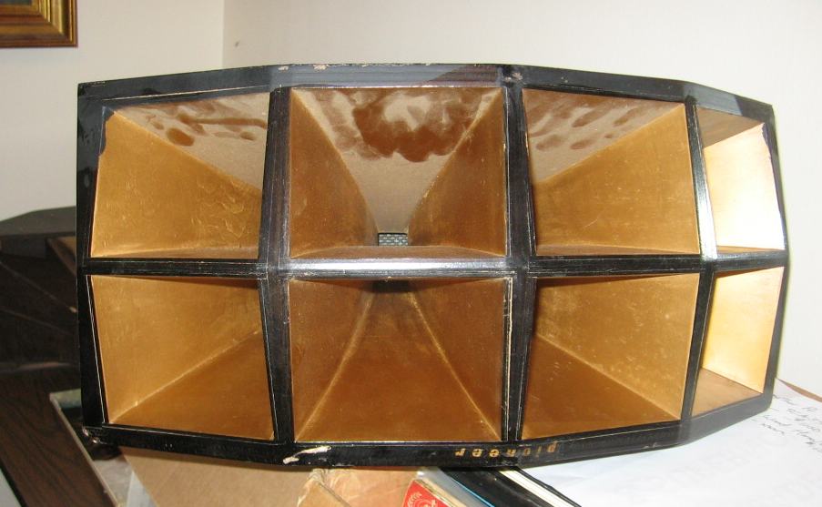

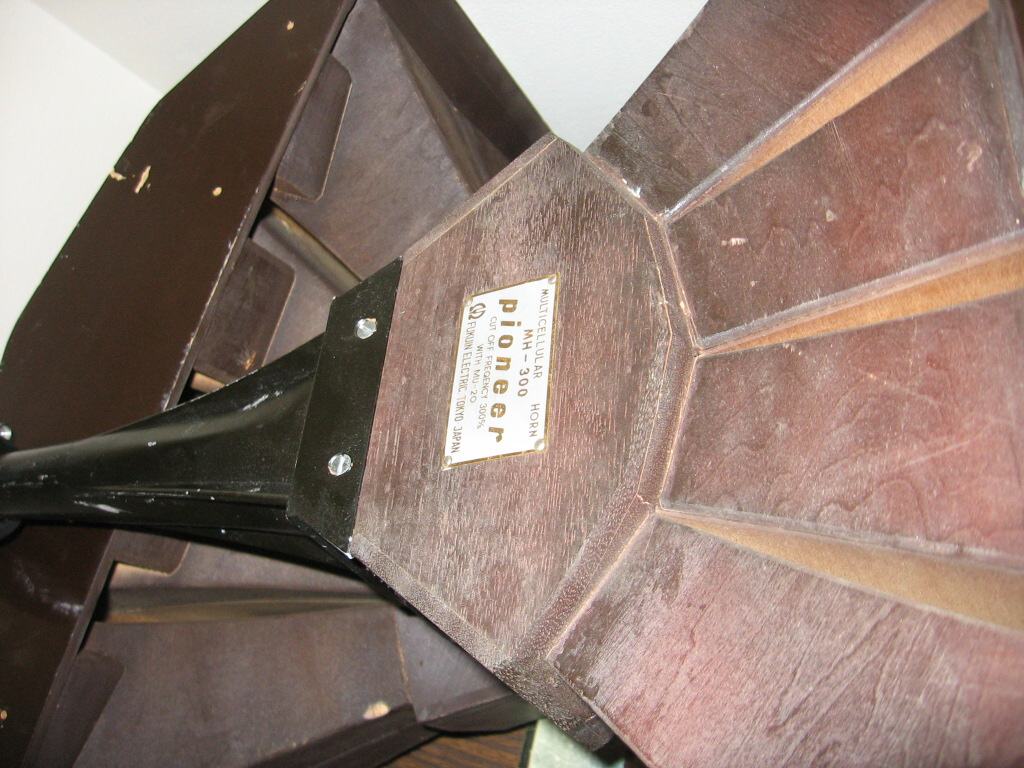

I hope you don't mind - here are 3 photos of some old Pioneer multicells I saw last year. I should have bought them. They are so pretty I thought you might enjoy them.

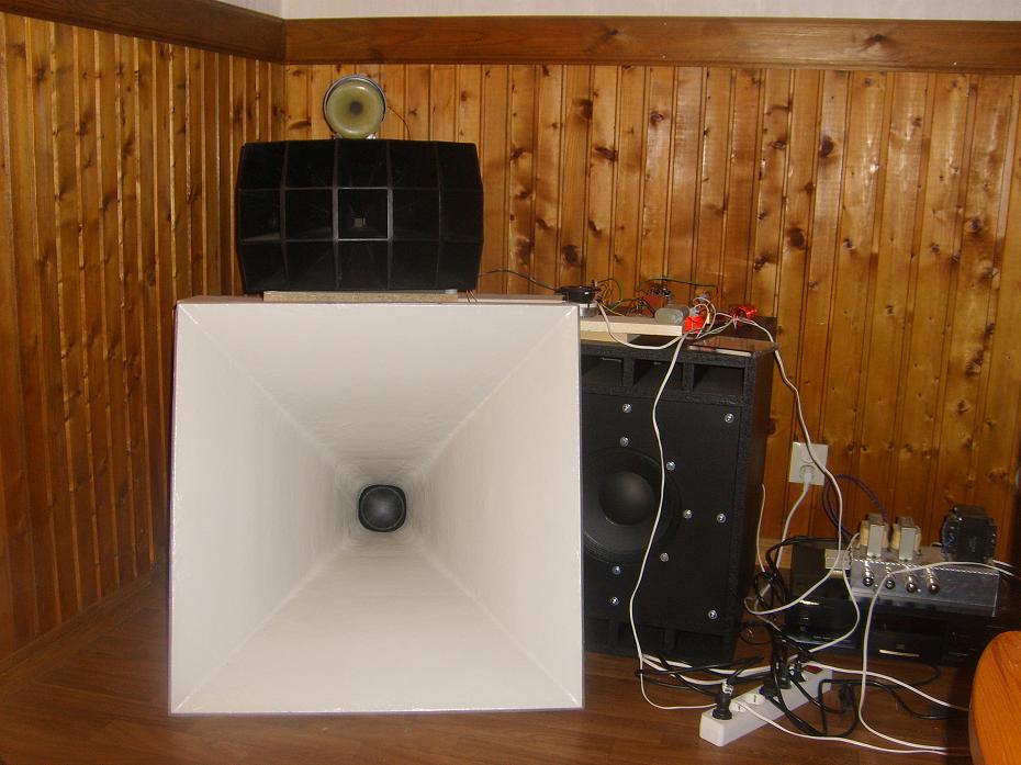

I forgot to mention that I have another multicell horn under construction (the last one, I swear...), a single 10 cell 240Hz unit made of masonite. The plan behind this project is to put some odd drivers, tubes, transformers and such stuff to use in a mono system for my bedroom. I´m also drawing a corner loaded horn/BR hybrid to cover 60-500Hz.
