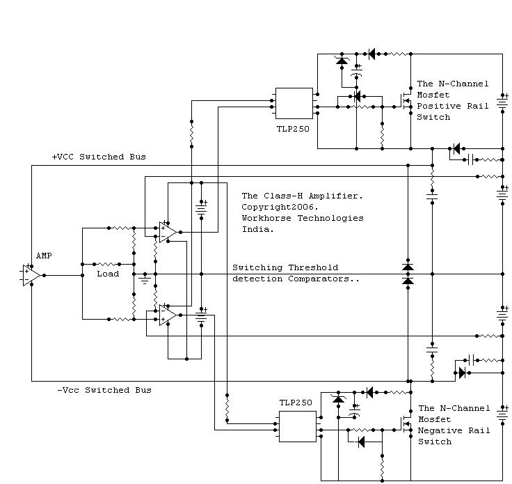

Hi Folks,
I have just figured out that in Class-G amp[both in simulation and real world lab tests], if the Upper and Lower Tier devices are connected in parallel rather than series , then the Glitches are much less than with series combination.....
Is there any patent with parallel connection of class-G amp...
for reference MX1500 from QSC uses parallel connected output devices rather in series....
http://www.qscaudio.com/support/library/schems/mx1500.pdf

QSC has a patent on the current limiting circuit on that amp, but not the output stage (I think).
Yamaha did a parallel output stage with progressivce drive about 20 years ago.

Hi DJK,
After some searching i found that QSC has a patent on "Time Based Output Short-Circuit Averaging protection"
Whats your view regarding parallel stage...
K a n w a r

Hi Anatech & DJK,
I just made the switching threshold detector much simpler just by eliminating the comparators and driving the LED's from the VAS directly for Tier Transistion.......much simpler and low cost as well.

Hi Folks,
Just 5 Pairs of IRFP360 were enough to Pump out 2.2KW in 4 Ohms with rails sagging 10 Volts below idle state.....

Hi Folks,
PCB Designing is undergoing for a 2 Tier Class-H Bipolar version[Lower Power] and All Vertical N-channel Mosfets version[Higher power]:
BP Version:
Dual Differential Cascoded Frontend+ Classic CE VAS but might be with EF buffer all trannies A42/92 @1mA VAS MJE340/350 @ 5mA
Triple EF output Stage ->MJE350/340->C5200/A1943 & using 5 Pairs of C5200/A1943 at output targetted for 1200W @ 2 ohms only
NVMOS version
Dual Cascoded Dfferential Front end + Rush-Cascode VAS + P-P Mosfet drivers + 2 pairs of APT20M18LVR at the output fo 2.5KW @ 2 ohms .. All Trannies A42/92....
IRFP260N/APT20M18LVR as Rail Switchers+TLP250 opto Gate Drivers...
STPS150C20 Schottky's for commutation diodes....
NE5532 dual opamp configured as complementary comparator for switching threshold detectors.
after completion ,I will post some pics
