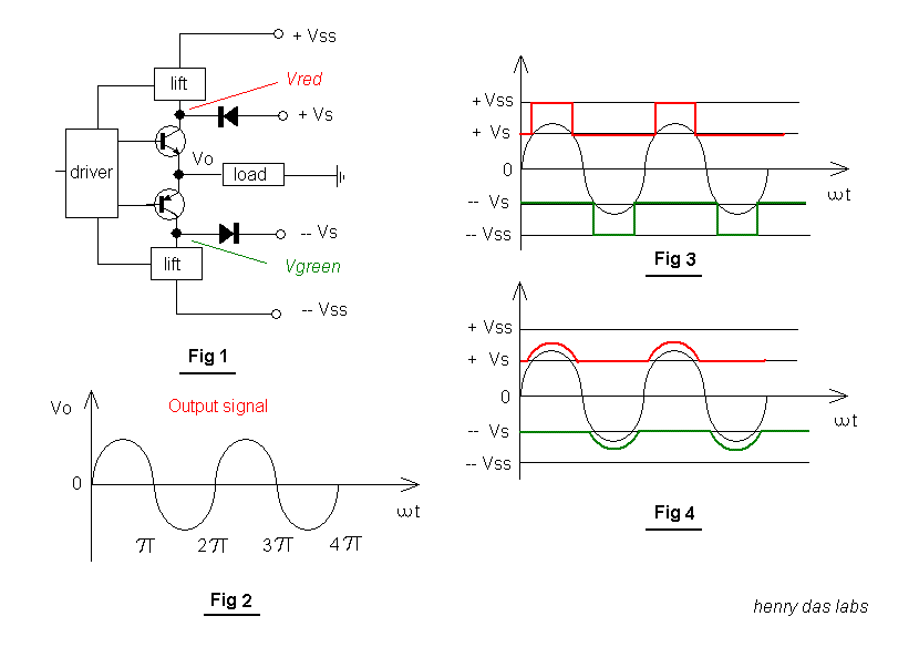

Hallo 🙂
Why the switch calls class H and the regulation class G ?
It sound me more natural call G-Class a switched psu Voltage lifter
and H-class a linear psu v.lifter
have This web a mistake ?

Hi Folks,
Class-H and Class-G both switch the Rails, but Class-H uses PWM with Step square waveform, whereas Class-G uses elevated linear waveform...
Class-H has efficiency around 70% and Class-G has 65%....
Donot Mix Tracking Power supplyRails[Carver, Bash, LabGruppen Class-TD stuff] with Class-H, Class-H isnot a Tracking Supply amplifier....
The Answers and references you got on the famous search engine "Google" led you to wrong conclusions.....

this is right ?
http://en.wikipedia.org/wiki/Electronic_amplifier
This is a G class amplifier...
at the collector of AB class the voltage is..
but in H-class i have a PWM lifter for class AB transistor.
have I something understood ?

Yes thats the version of Douglas Self's Class-G amp....
Yeah Mackie uses Class-H in their new M-series
The reference on Wikipedia for Class-H was Wrong, but I have edited it and made it correct....check it out

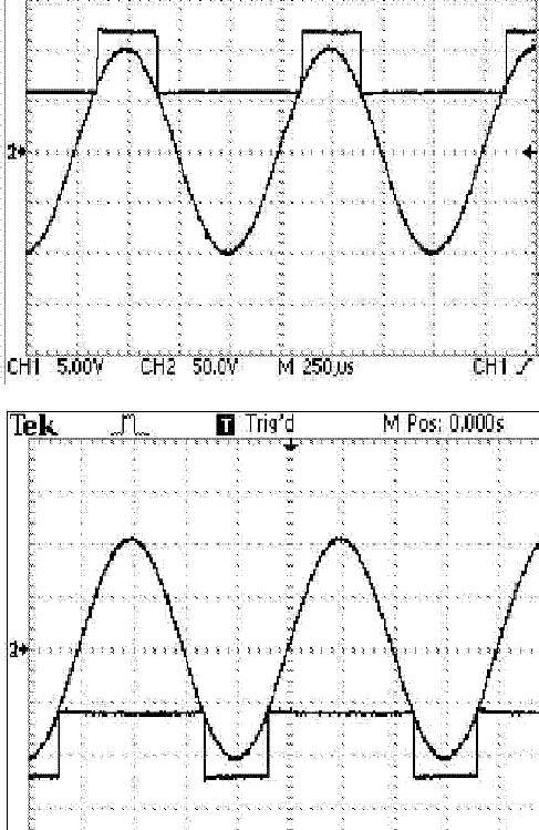

Soundcraftsmen describes their class H amp as a signal-tracking rail switcher...

Yes there definitions are very well correct....As all Class-H, Class-G, amps Tracks the output signal and switches the Rails accordingly, whereas Tracking Rails Class-TD amp does Track the output signal and but it doesnot switches the Supply Rails as in Classs-H/G but the Supply Rails actually Track the output signal and there are no Tiers in Class-TD Tracking Rails amp....Lab gruppen amp has its Rails 6 Volts above the output signal voltage...i.e. when no output signal the rails are at +-6 Volts and when output signal is at 100V the supply rails are at 106 V....

so the fig.3 is when the voltage lifter work in switching mode.
when the voltage overcomes the threshold the lift switch on
+/-Vss supply. I do this mode call H-class.
and in fig.4 is when the voltage lifter work in class C.
when the voltage overcomes the threshold the ago a linear
regulation from Vs up to Vss. I do this mode call G-class.
on many sites it seems to say the contrary one..
see also http://www.qscaudio.com/support/library/papers/amptalk.pdf
bye 🙂

Souncraftsmen class H appears to be tracking the signal and the text says it increases the B+ voltage proportionally until it hits the maximum of the second supply...
