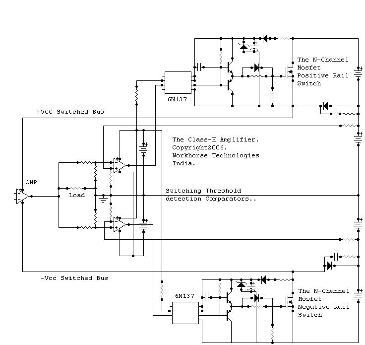

Hi DJK & Anatech[Chris]
Just managed to optimise the switching circuit to perform switching with input/output signal frequency at 30KHZ...without any sort of Rail locking.... Continuous dutycyle loads.....
regards,
K a n wa r
regards,
K a n wa r

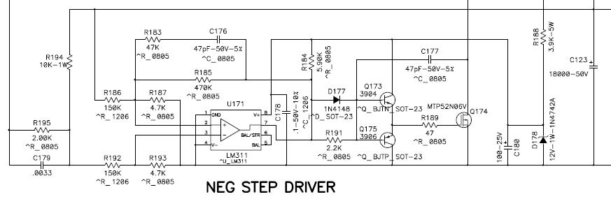

The diode in parallel with the gate resistor looks like it is drawn backwards.
I get clean turn-offs with 6µS pulse widths from that circuit. I use P-ch devices on the positive rail though, I don't need that much current(no bootstap cap needed either). I use a common-base level-shift transistor, no opto stuff.

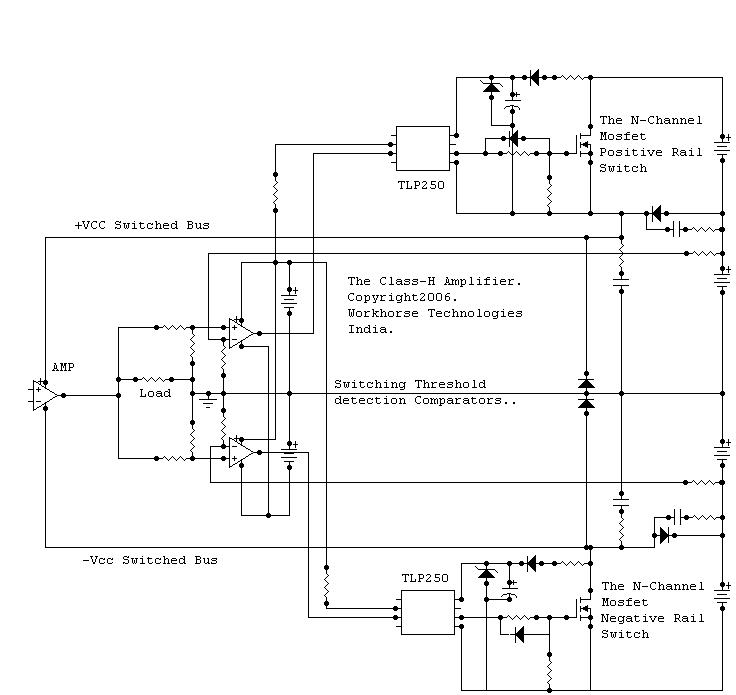

In previous thread i think you were talking about the amp not class-H circuit....
In this Class-H ,
The diode is use to Turn-ON the Mosfet Faster , to eliminate premature Clipping...and the Turn off is kept slow to get seamless transfer.....QSC/Crest all uses faster-Turn-ON for the Switch...
The optos makes the circuit less prone to Switching artifacts arising within the circuit and also makes the Level-shifting much easier
For High power amps, P-channel switch doesnot hold good due to its High I2R losses due to Higher RDS and also they cost higher as compared to N-channel ones.....
K a n w a r
In this Class-H ,
K a n w a r
I wouldn't like to disappoint you, but I think that there are better ways to do it, particularly, there are (softer) ways to do it with minium disturbance to the main feedback loop as TIM may arise...
Also, you are going to get quite bad distortion and terrible global feedback loop disturbance by changing the supply rails of the whole amplifier, so what you should change are only the drain voltages at the output devices (while keeping the rest always on the highest rails). That in turn is going to be a bit difficult to implement properly in the lower bank of your N-channel topology.

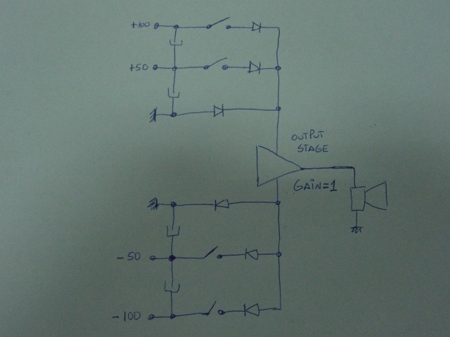

Hi Kanwar,
Eva has an excellent point there. If you look at the Carver designs, you will see they run off non-switched supplies. Only the output stage gets hit with variable voltages.
I think varying all the supplies will upset the amplifier dynamically. Best to avoid doing that. It does mean that the dissipation goes up in some of the small signal stages.
-Chirs
-Chirs
Well, Carver uses class G output stage series stacking for the transition to the second tier and class H rail switching with controlled slope for the transition to the third tier. That's indeed a quite clever approach taking the best of the two worlds.
Anyway, controlled slope is what I was talikg about.
BTW: Chris, do you have schematics for AB international 1100 models? they use +-50V and +-100V rail switching, and they allow the rails to fall to ground to improve reactive load handling, yet their switching circuit is quite simple. I had to repair one of these some time ago but I hadn't enough time to draw an schematic. I only remember that they used zener references and fully discrete switching with bipolar transistors.
