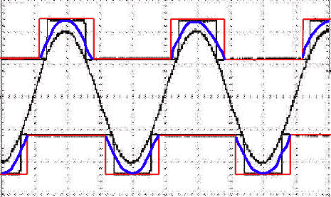

Hi DJK & Anatech,
I have seen some QSC models which uses 3 Tier = 3 positive steps and 3 negative step supplies in Class - H...which increases the complexity of both the switching circuit and power supply...and the transformer utilization factor is quite low, as compared to Crown MA5000VZ amps......
What are your views regarding 3 Tier Class-H ?
regards,
K a n w a r
regards,
K a n w a r
The transformer utilization really isn't any better on the Crown.
The Crown is a two-tier supply with a very clever rail switch.
Most Carver were three-tier:
the M400 was ±25V, ±50V, ±80V,
the M1.0 was ±25V, ±50V, ±100V,
the M1.5 was ±37V, ±75V, ±125V
The M2.0 had four tiers, the top being the same as the M1.5 (IIRC), it had a switching supply, the others had the triac supply.
I never heard a M2.0, the others all sounded good.
I never heard a QSC I liked, the ones I heard were all two-tier.
AB International makes a different breed of three-tier:
the 1100 was ±0V, ±50V, ±100V (I explained previously how the 0V tier worked).
All the Crest I have heard are two-tier, some are class G, and some are class H. I own eight of the CA series, which the larger ones are class H, the smaller are class AB. The class H models sound better than the Crown, the class AB models sound better than the class H models, the class AB from AB International sound better than the class AB Crest (probably the limiter stuff).

Hi DJK & Anatech,
I have recently checked Crest CA series Class-H amplifier....upon checking the waveform at the PS rails..lots of Spikes are seen when driving with HF content....isn't this adds coloration to the music ...
regards,
K a n w a r
regards,
K a n w a r

"I have recently checked Crest CA series Class-H amplifier....upon checking the waveform at the PS rails..lots of Spikes are seen when driving with HF content....isn't this adds coloration to the music ..."
Yes, you can hear it for HF use. They're fine for bass.
Crest does make some special amps for driving HF drivers that are not class H. I use some AB International amps for HF use that have about the same topology as the Leach amplifier, they sound better for HF use, but are bigger (3H vs 2H) even though they are less power.
Hi DJK,
So the big Height corresponds to Class-AB amps with large heatsinks.....rather than class-H amps with small heatsinks...
K a n w a r
K a n w a r
