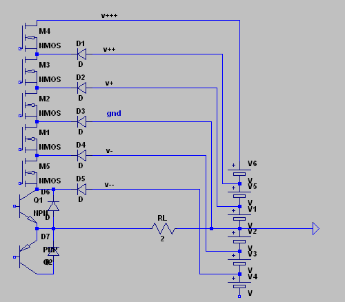

maybe a question, which shows, I have no clue about class H:
How big the actual CE voltage of the output Bipolar transistors can be in a class H circuit? (worst case, real word data)
Could it be somehow limited to only one voltage step voltage? (40-50V)
is there any way to apply voltages to the - rail of the amp even some positive voltages? (when the +rail =150V-->then the -Rail gets for example +100V)
that would mean, that you track the needed output voltage within say 40-50V, which is still not as good as with a class TD, but not bad at all...

It could be limited like that but there isn't much point really. The transistors used can take the voltage and the phase angle of current for a loudspeaker load isn't really big enough to warrant it.
A 50-100-150 stepping amplifier would see max ~200V over an output device. (for example, output at -150V and positive rail at 50V)
You could add in 0V as a step and then the max voltage would be 150V and have a little less heat with highly reactive loads. If you start to add opposite polarity steps too then maybe the class TD or D amplifier is starting to look like a cheaper and simpler solution. 🙂 There is no amp I know of that does this. It is possible of course, but are there any real benefeits?

what do you think the issues could be, when switching even +100V to the - rail of the output section while the +rail is at +150V?
this way, when you chose more steps like 4 to 6 steps, even higher output powers are easier to reach with the common 230-250V Bipolars.
Just considering 40 V steps x 6= +/-240V max rail voltage while the max Uce could be less than 100V....
is it a bad idea?

I think the extra complexity would be a real pain in the rear. Especially because of the way reactive loads behave. When the signal voltage swings negative, there can be positive current flowing - which is why the NPN side can have a high VCE with significant current. In order to switch the negative rail with positive current - the switch needs to turn both on and off bi-directionally. The body diode of the hexfet will complicate that.
If a 3-step class H and the BCA give similar efficiency with sinewave or real world signal, then you're at the point of diminishing returns dissipation-wise anyway.
BTW - the biggest amps out there only use +/-195v. You could do a 4-step class H with MJ21193/4 on that no problem. No one said the rails all had to be the same increment - the low one could be 25V with the balance between two or three more steps. Mine tend to be the same, but that's because I cheat and stack identical lower voltage trafos in series.

There isn't more complication than usual, see attached picture.
But you are right in that it's probably not worth it. 🙂 Letting it drop to 0V might be worth the extra FET and diode but I seriously doubt that any more is worth doing. The more FETs used the more series resistance...
It's possible to rearrange them a bit to get around this penalty but then you would need higher voltage FETs which have higher resistance...
