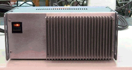

My "Almost Blameless" amp is now packaged, and the bias is tweaked up. I'll take some pics and try to make it sing for me tomorrow.... Schematics to follow, too. The look is stark/functional/proletarian.

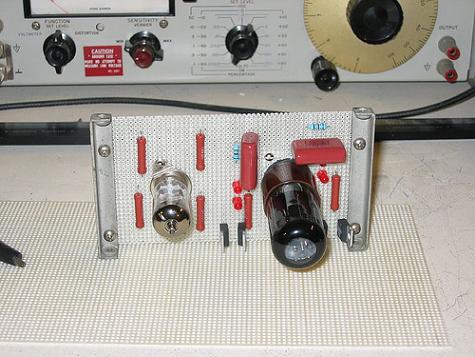

Hi SY,
Is that the "Perf Board Palace"? 😀 MK1 of course.
Could that be a 334A in the background? Certainly looks like it. I think the 333A was identical except no AM detector (not normally required for audio work).
-Chris
-Chris
Re: The ImPasse preamp
SY, how did you make an anti-slip mat into a circuit board?
😀 Please describe design. Very nice. What's with the name?
SY said:Bench tested and ready to be mounted in the case.
333A. Some Canadian guy insisted that I buy it.😉
Perf board doesn't get enough respect. It really is (as regards strays and leakage) closer to point-to-point than it is to PCB. The other modules (raw PS, regulators, output cap board) are also on perf. It's lousy for production but perfect for one-off.
It's designed specifically to drive the F4. So I couldn't resist the pun. (Zen Mod would have been happier if I called it "Smashing Pumpkins")
As you can see, it's a very simple design. No loop feedback. Gain of 20. Surprisingly low distortion at the 20V output needed. It will only drive balanced loads, but it's not supposed to be universal. Input tube is a CV1988 (British military version of 6SN7) from Morgan Jones's stash. Output tube is a "Bugle Boy" ECC88.
And surprise, surprise, active regulation, CCS loads, and LEDs. My design work does tend to follow a pattern.
Unlike Jan's amp, it will NOT be beautiful.

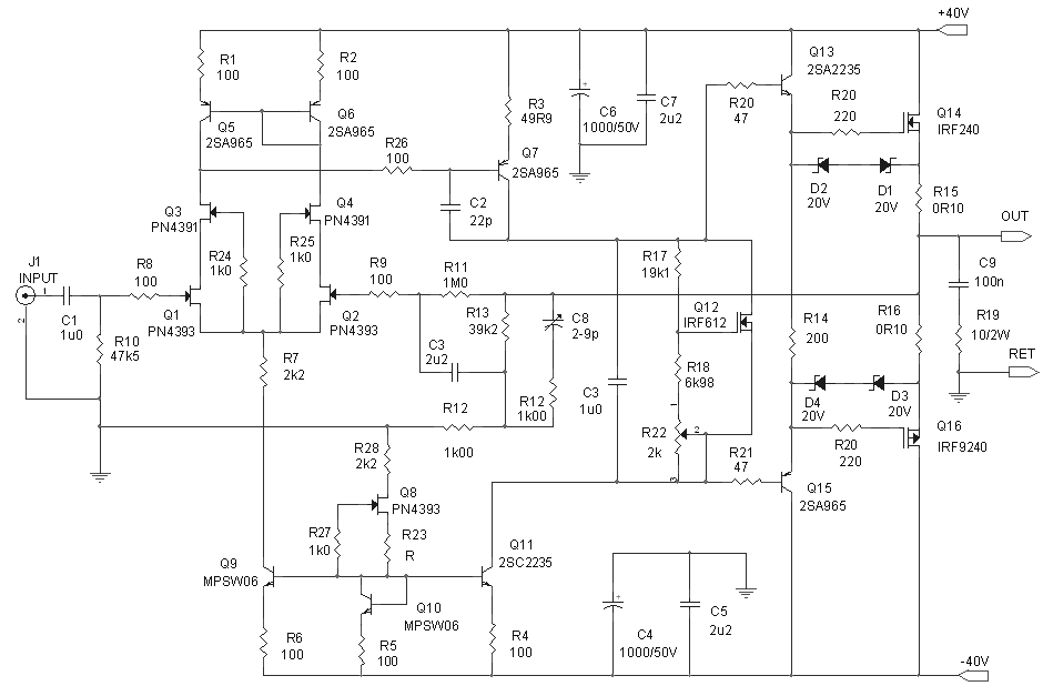

Attached is a picture of the "Almost Blameless" amp I'm bringing. This started as a training exercise in analog simulation I gave to a new guy at work. I gave him a back-of the envelope schematic for a basic amp so he could do some Orcad simulations and get a feel for a simple design and see what some changes would do to the operating parameters.
It started out as a simple JFET differential input stage, VAS, and darlington outputs w/VBE multiplier. I got hooked by the design myself, , added some buttons and bows, then decided to build it with what I had at hand, since the simulation results were very attractive. The design originally called for +/-30V rails, but the only transformer I had on had gave me a +/- 40V supply, and the darlingtons available (TIP142/147) had a pathetic SOA at 80V, so the output was changed to MOSFETs, and the VBE multiplier to a VGS multiplier. The amp was packed into an LMB box, and the result is shown below - plain but functional.
