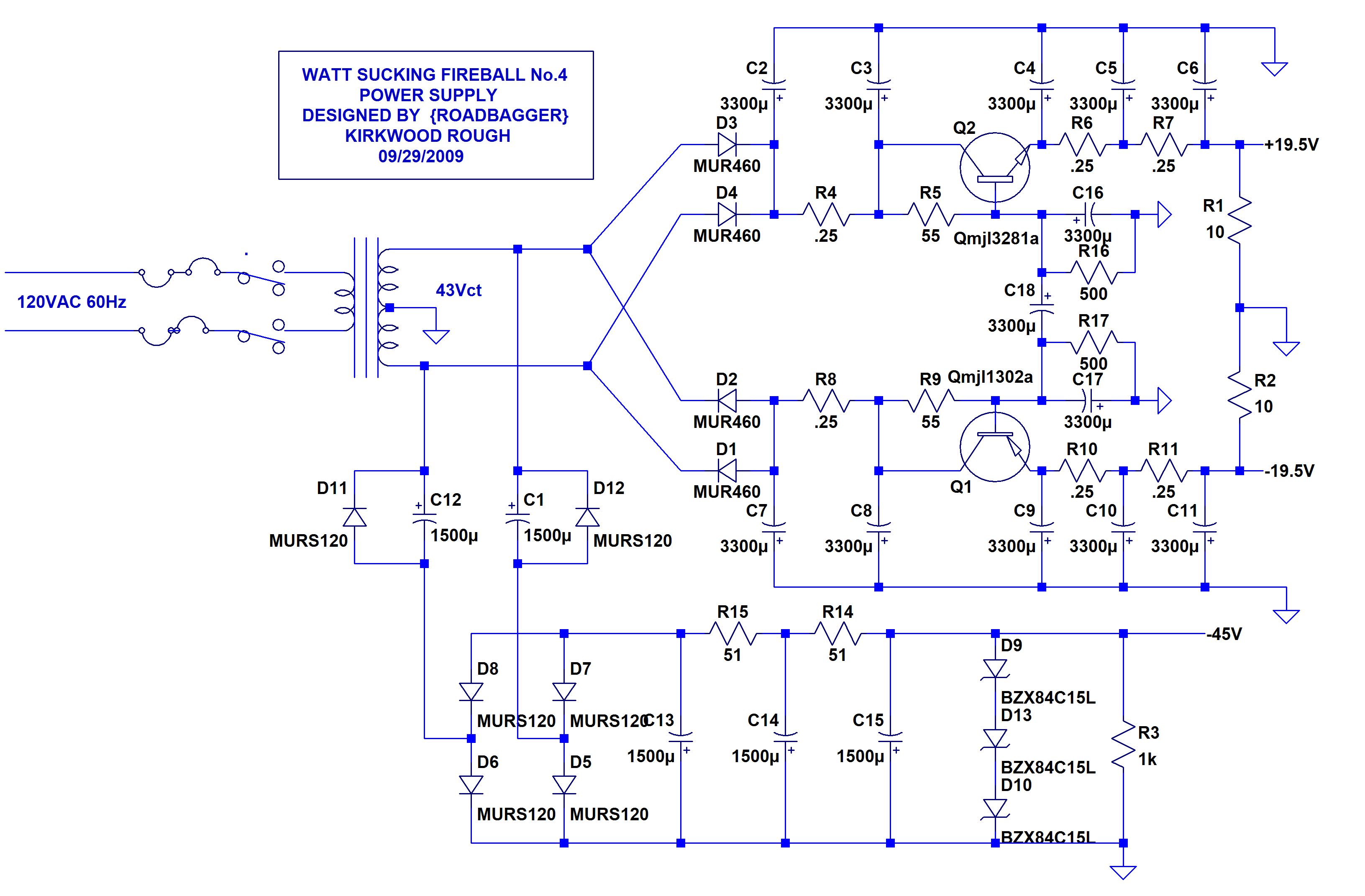

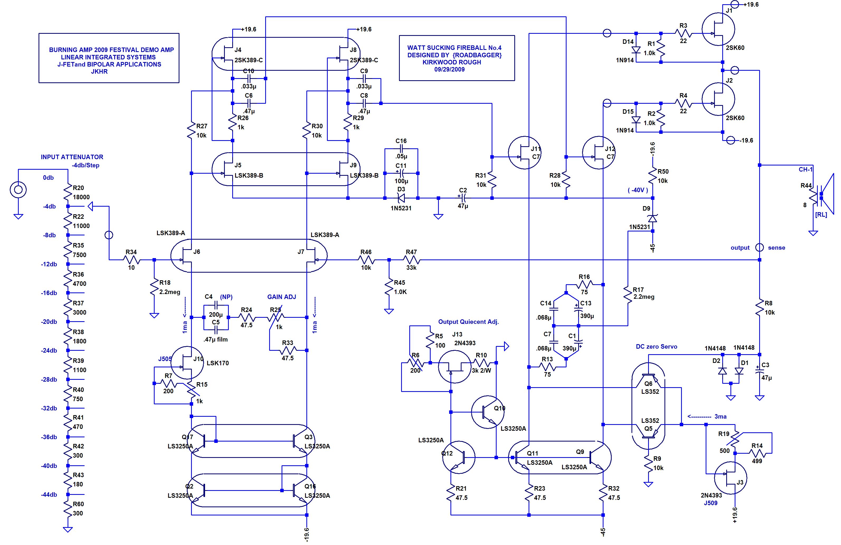

WSF No.4
The thread about this amp is here:
http://www.diyaudio.com/forums/solid-state/154070-watt-sucking-fireball-series.html
Thank you for the very motivating event this year. For those of you who saw and heard the Watt Sucking Fireball No.4, and asked for a discussion of the circuits, here is the schematic for the power supply and one channel of the Amp. It is a simple application of J-Fets in a minimized gain chain of linear gain stages. An input stage that I call a differential-cascode-transimpedance amp is used to generate the initial amplification and convert the single ended input to a full differential drive that continues through to the P-P output stage. Being new to this forum, I'm posting these by request of people who were there and discussion if warrented will follow if wanted. Again, Thanks for a great first event
ADD: The 10 ohm and 1K ohm loads on the power supply are really the effective load of the amp components and are there only for the circuit simulation of the PS.
