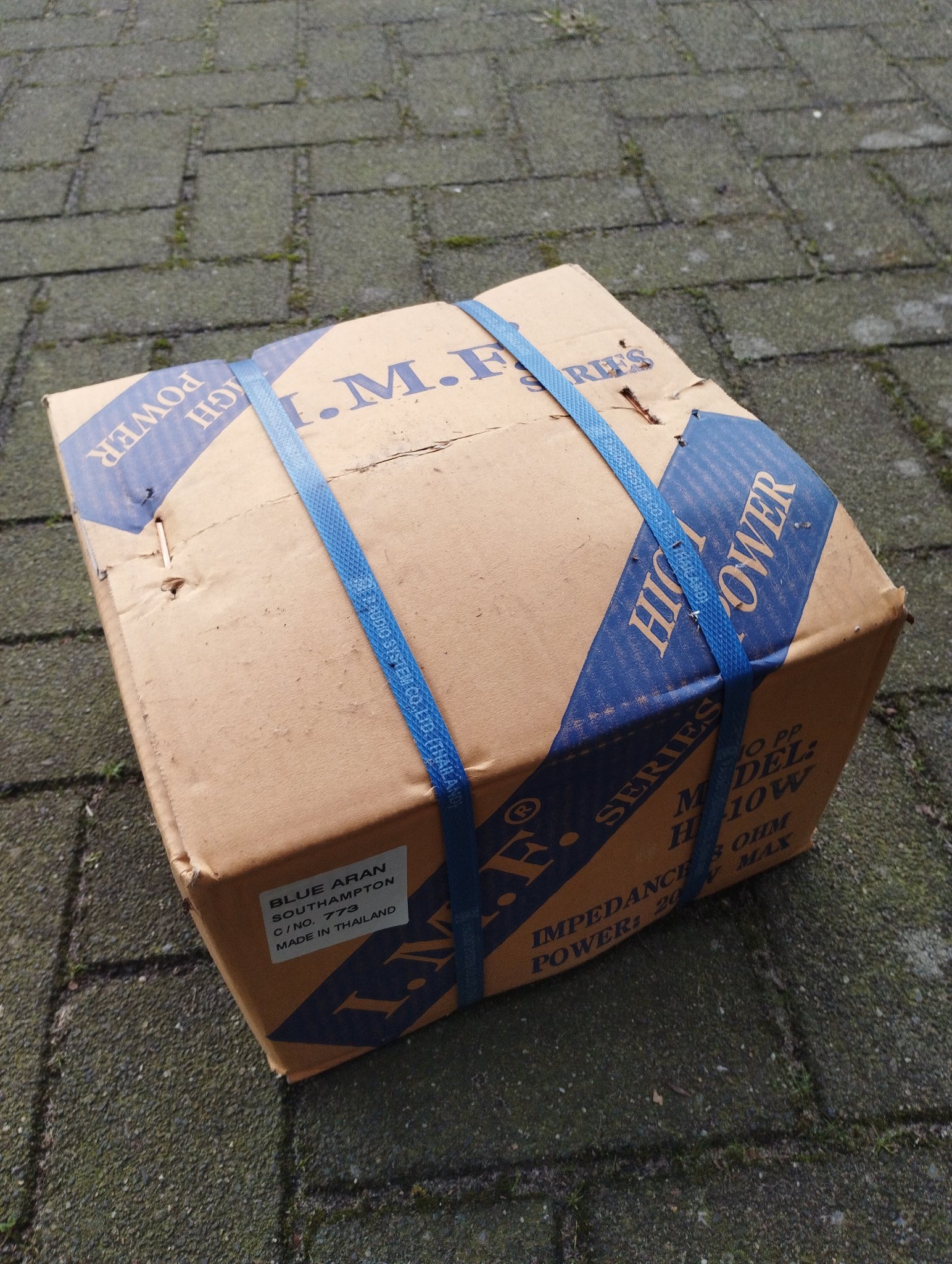

I have 12 pieces of P-audio HP10W in original packaging for sale. Shipping from the Netherlands. 30 euros per piece. Send me a DM if you are interested.

Thanks to lutkeveld i will soon get 4 pieces of HP10W drivers.
