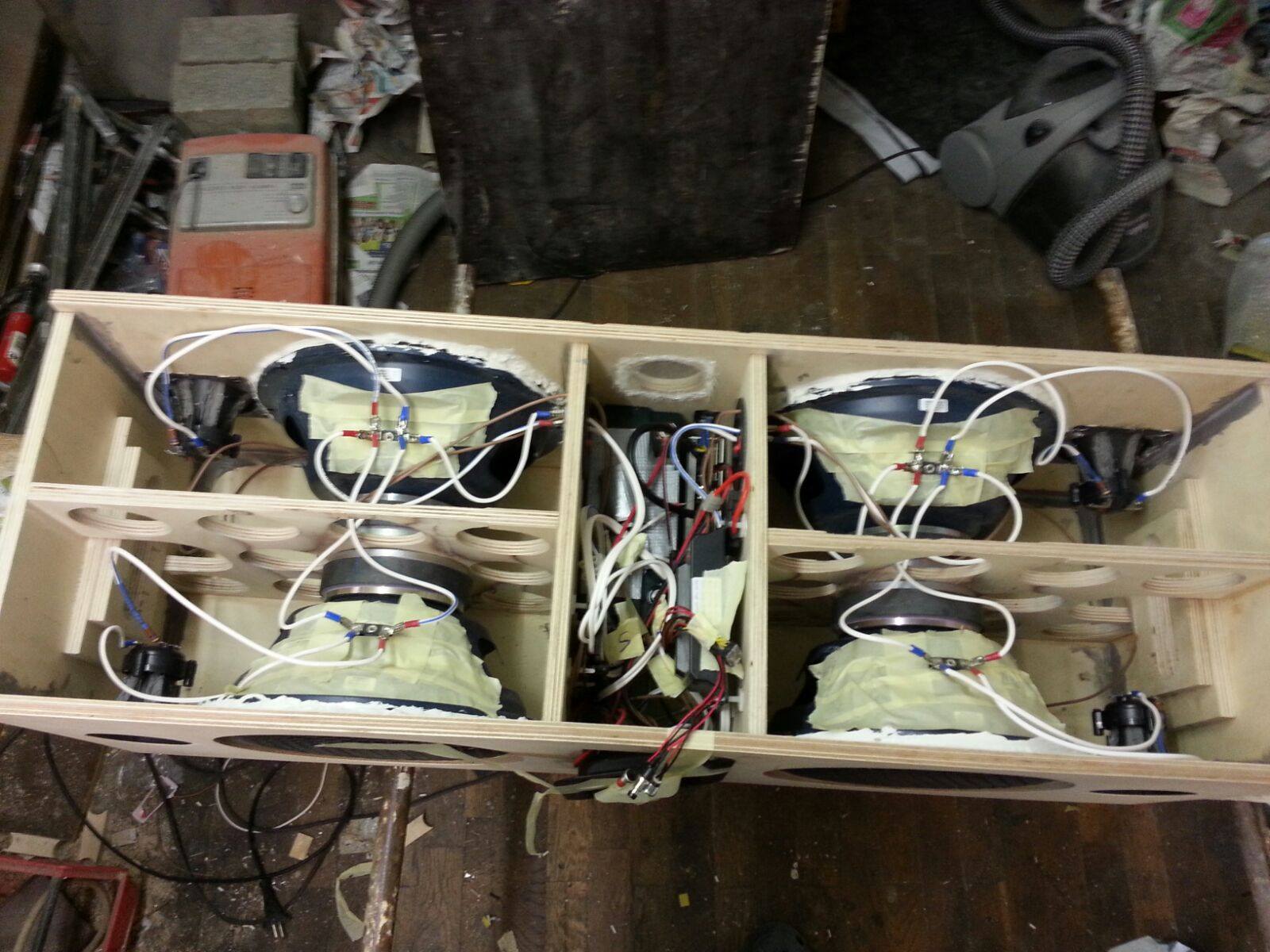

Hey Guys!
Massive thank you for your hints and tips until now. Right now we are painting our boominator.
Like I wrote a few pages before: we changed the measurements a little bit. we cutted each board (the ones between the HP10s ; with the holes in it) for 2.5 cm to gain more space for the electronics. The other thing is that the second layer of wood in the grips (bass reflex) does not reach till the outer boards (SHOULD have no effect to the sound).
We have got the MaxAMP20 (with two capacitors each side, just as lutkeveld)
NOW, OUR MAIN PROBLEM IS THE MISSING (WEAK) BASS! Will the bass and the whole sound as well get better after some hours of playing music (to "brake" in the woofers)? Or are the missing 2.5 cm responsible for the missing bass (SOME BASS FREQUENCIES are not even played - they are not weak, they are simply not there). Our music source are modern mobile phones.

check your wiring.
maybe there is something wrong so that lower frequencies are eleminated by interference.
looks like all the woofers are connected in phase.
the idea of the boominator is to have woofers on each side 180 deg out of phase.
you could keep the polarity of both woofers which are on the lower part of the pic as it is,
but change plus for minus on the top part.
....wow that is hard to describe in english, especially when i know i'm talking to fellow german and it could be easier...
can you please explain this? I have never heard this and when people specifically asked about push/pull configurations in the past, I thought they were told that they were supposed to be wired as push/push, which I took to mean In phase.
My fault, i think steveeboy is right.
But still CrazyLegz's problem most likely has to do with phase inversion.
Which amp are you using.
Have you checked wiring at the amp outputs?

Thank you again guys for your response, i uploaded a picture where you can see the wiring, maybe you can find a mistake, i looked over it so many times but maybe i'm blind :/
If you can't see a wiring fault then connect the woofers progressively, that is, one woofer, play bass note, connect second woofer, play note, if there is more bass, they are in phase, if there is less, then polarity is wrong, then the other woofers.

Hey Guys!
horst303s tip to connect the woofers progressively is amazing. Unfortunately , a few days ago we glued the whole case together. Right now we are painting our boominator. We wanted to finish the device for the upcoming "rock am ring"-festival.
Is it possible that the MaxAMP20 is not able to play some bass frequencies?
Conceivable, very unlikely.
Try playing one channel at a time from your source. If you've got something like a bad/loose audio signal ground, your speakers will only play the stereo difference.

Have you tried without the volume potentiometer on the maxamp? I may have I made the misstake once to connect the Potentiometers legs to the wrong pins and as I recall there was a big difference in sound when comparing wiring the right way and the wrong way.
@euforia
What did you do wrong? We ordered our Potentiometer from accusafe and it was completely wired, but we have to turn it to the wrong side...we looked on their page and it seems that it is manufactured wrong... Will it make a difference? Is this the mistake you made?
The pot in the max amp is not within the signal chain, it has a dedicated readout channel. When you have to turn it in the opposite than normal direction it is just wired the wrong way, but this doesn't affects audio quality. For the Chassis, i highly recommend to remove the masking tape from the backside at it affects audio performance (to some extend).
