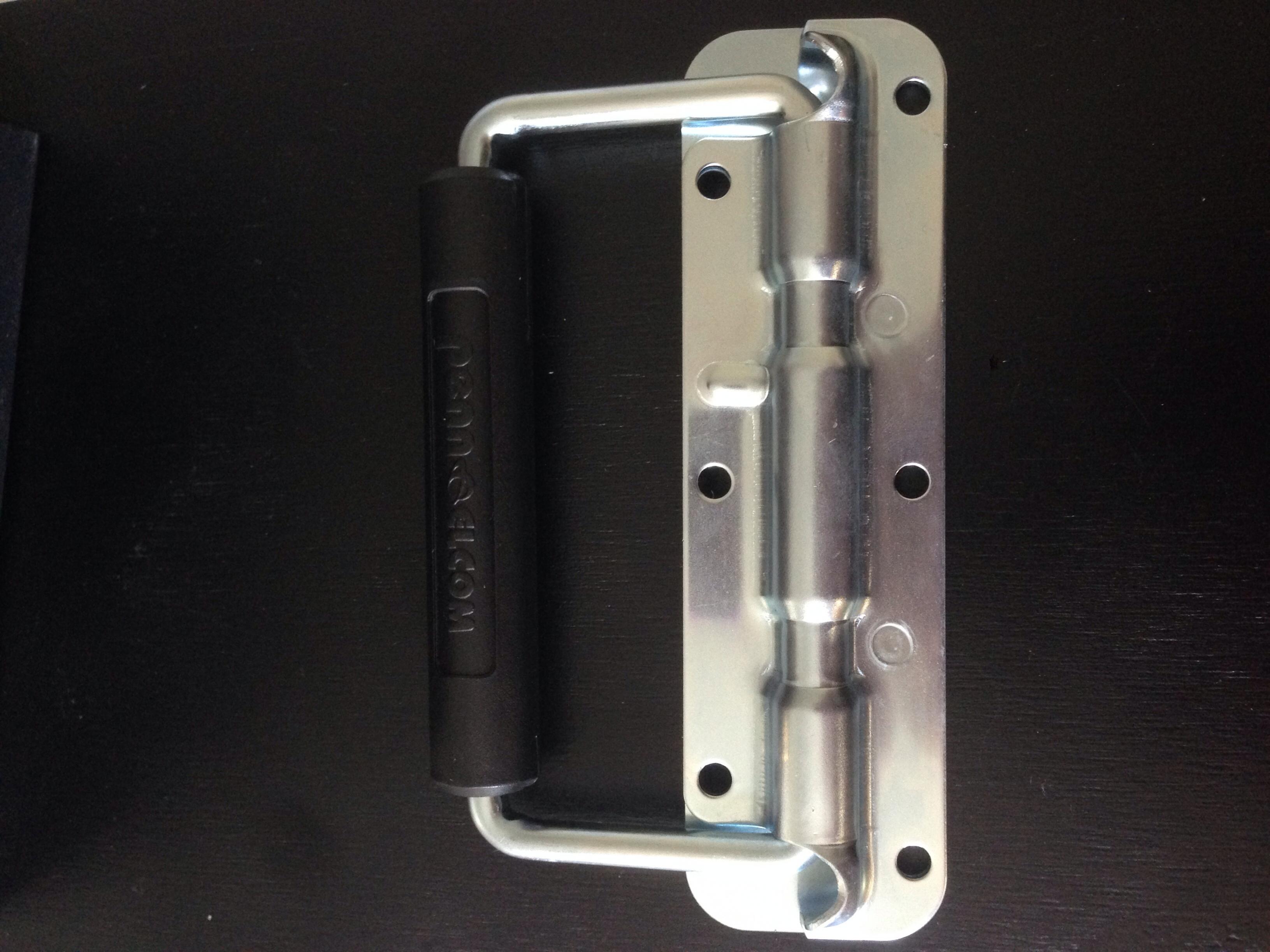

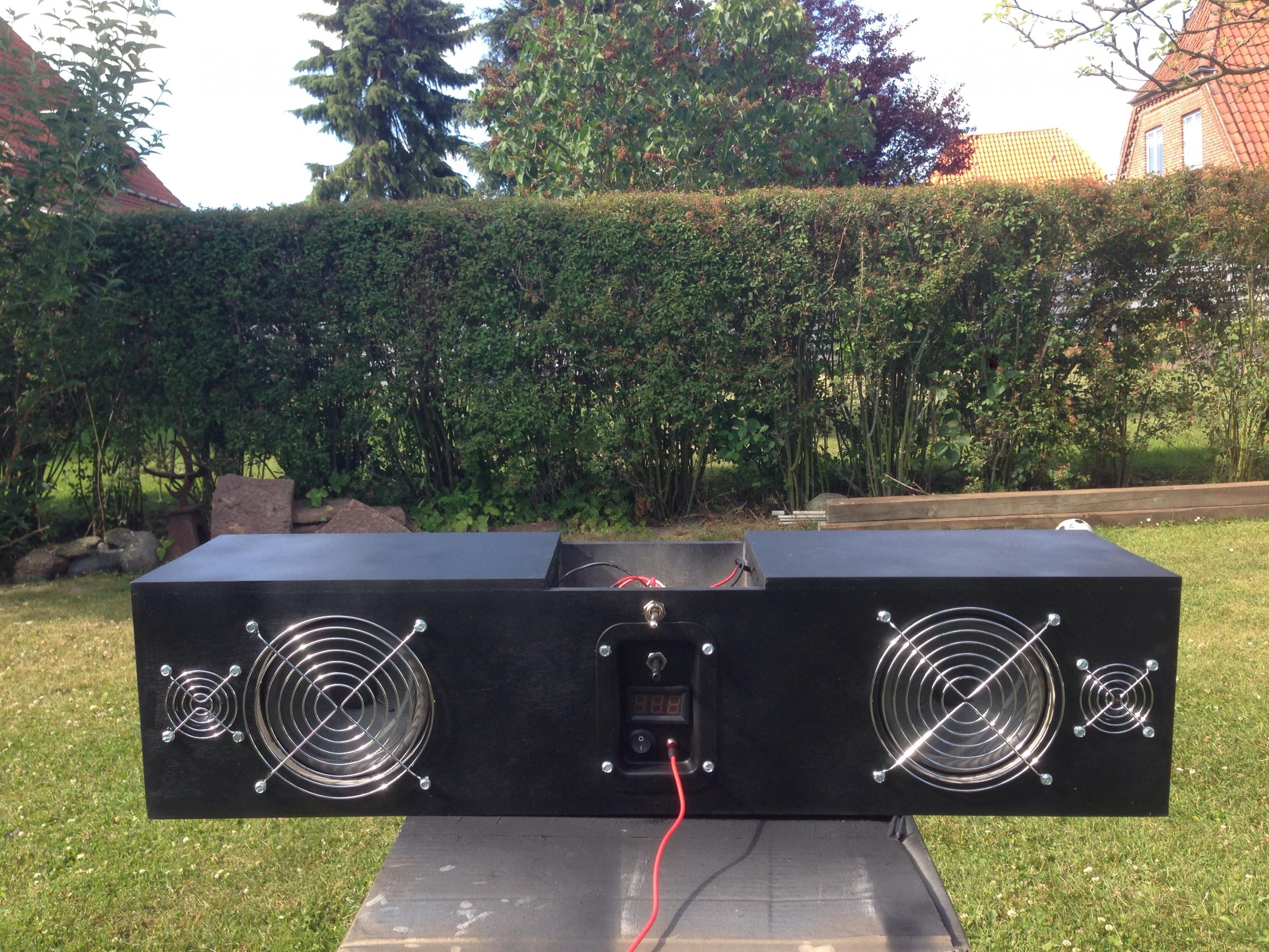

Okay not exactly finished!
Still need the lid! Handles in each end and corner protectors! !
Why not just a long handle down the middle?
And good job btw.
