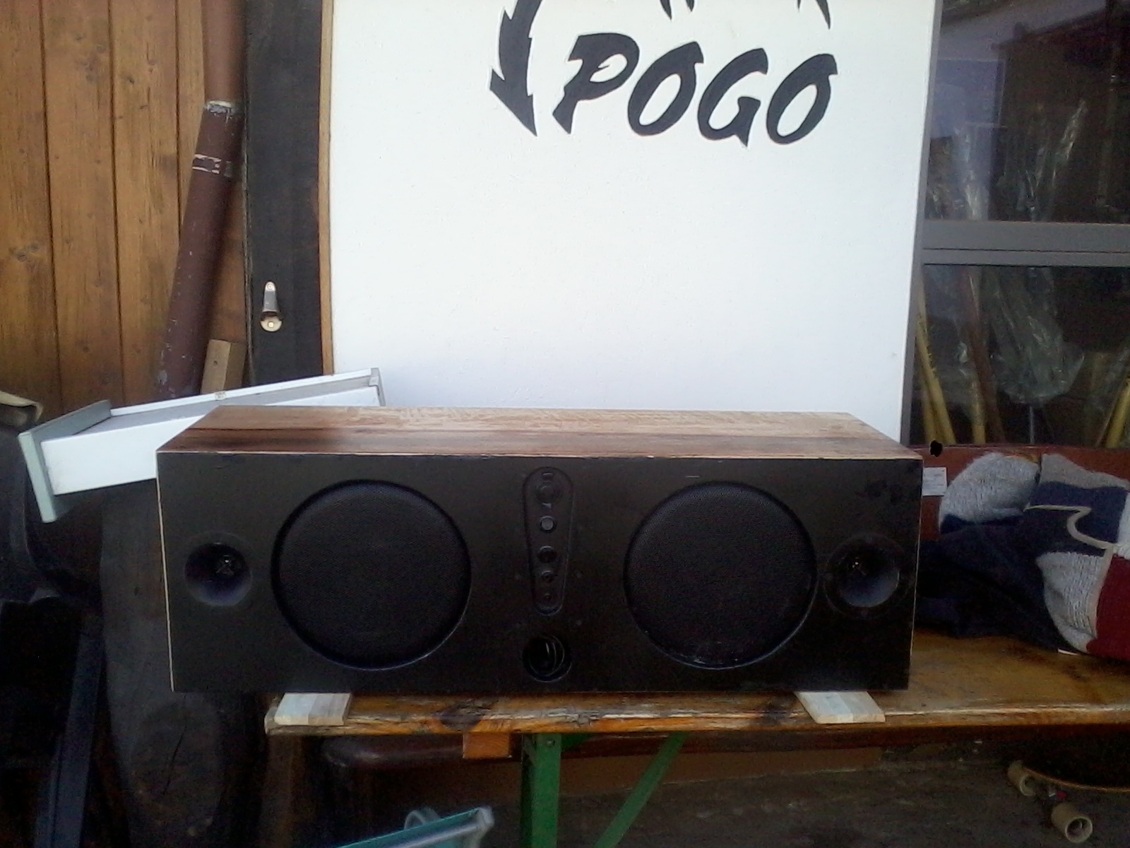

Just finished my Bluetooth Boominator
Yea yippi, thanks Saturnus, and my friends at POGO Snowboards !
I just finished my Boominator and it sounds amazing. I have been using it for 2 weeks and have not yet charged my batteries🙂
I used 2x 9 Ah LiFePo4 and a solar charger. Bluetooth is very nice.

Thanks again everybody i am hooked, just love this machine 🙂

Amazing workmanship. Very very nice allround look and details, inside and out. Thanks for sharing. 🙂
I bet you like me just want to hug it and never let go. I also bet the guys at POGO didn't believe the monster they just unleashed.
Again. Kudos. Sincerely.
Saturnus thanks again, yes they were quite amazed when i cranked up the volume 🙂 No distortion just beautiful sound.
