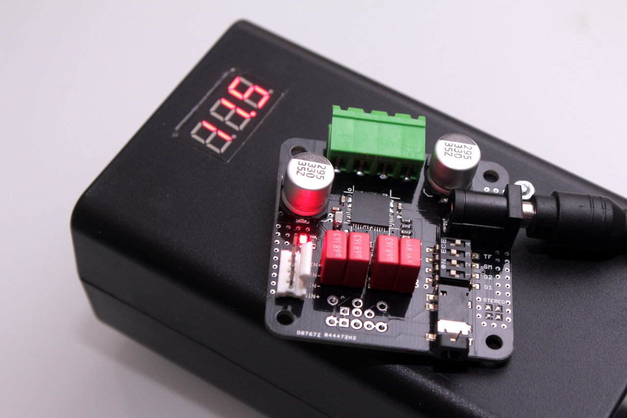

Until now, i have not had any problems with my MAX-modules (MAX9709 / MAX9704) concerning the audio-quality, but i would recomment to change the input capacitors of the MAXAmp.
Even if ceramics arent that bad (min. X7R, high voltage rating compared to audio level), you may run into problems by their piezoceramic effects. They tend to be "microphonic".
Ceramics tend to do:
Change value my vibrations (microphonic)
Change value by voltage
Change value by temperature
Change them for i.e.
WIMA MKS4 680nF 63V
or
MKT 470nF 63V
When the MAXamp boards are build straight from the Datasheet (MAX9744), the input resistance will be 20kOhms, thus resulting in a -3dB (lower end) frequency of:
17Hz (470nF)
12Hz (680nF)
The MKS4 i use on my MAX9709 board looks like:
You may also try a 22uH inductor in series (only) with the tweeter, resulting in a lower idle power consumption and less "noise" on the upper end.

Mornin lads.
It looks like I've found the problem that was leading to the poor sound quality.
The 3.5mm Jack socket on my front panel has an intermittent fault that was adding a load of noise to the input signal.
I feel like a bit of a dick getting ye all involved with what is actually a simple problem!
Thank you very much for your patience, I learnt a lot along the way.
I'm still only getting peaks of 96-98db before distortion but I can live with that as the sound quality is back.
