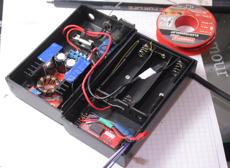

Hi Saturnus,
im using a self-configured Liion-Battery-Pack for my small 25/50/100W (Peak Power) amp-modules.
3s1p Sanyo cells (2400-2600mAh) in series (11.1V), followed by a 150W step-up module set to 19V. Primary fused by 2.5A (medium) and a 65°C (149°F) temp switch. Charging via IMAX B6 charger (cells get balanced). Pack inludes "fancy" battery-monitor-module.
No problems so far.

What problems should occur in this setup? Any hints? (ICR chemistry?) Those cells are 2C classified, giving roughly 50W continous power (which normally wont occur in a mobile setup).
I will maybe upgrade for some NCR18650PF (3C, 10A).
Regards.
