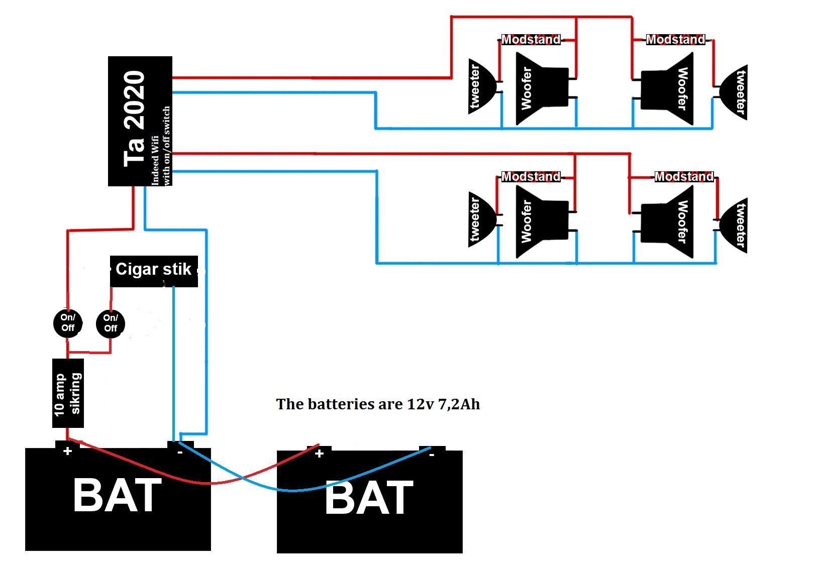

Hi, thanks saturnus for the idea and all the answears. Ive just gotten my boominator pakke from canopysound for my first build and everything looks great! Although I have a couple of questions, I would be greatful if they could get answeared.
I've used someones diagram and made it my own, thanks...
1. Is all the diagram ok? Im kinda unsurtain about the on/off switches. :/
2. the cigar outlet is for charging my phone and charging the batteries with this charger: http://www.biltema.se/sv/Bil---MC/El/Batteriverktyg-och-tillbehor/Batteriladdare-12-V-2-A-37743/ will bouth of the batteries be charging with these connections?
3. I have to do 3 connections to every battery pole, what do I use to do this?
4. Where can I buy recessed dish and cigar outlet in sweden? would love to not have to order.
5. I have a Indeed Wifi amp (http://canopysound.dk/da/indeed-ta2020) and it has no screwholes, will it be enough to just glue+acrylfog?
Thanks! 😀

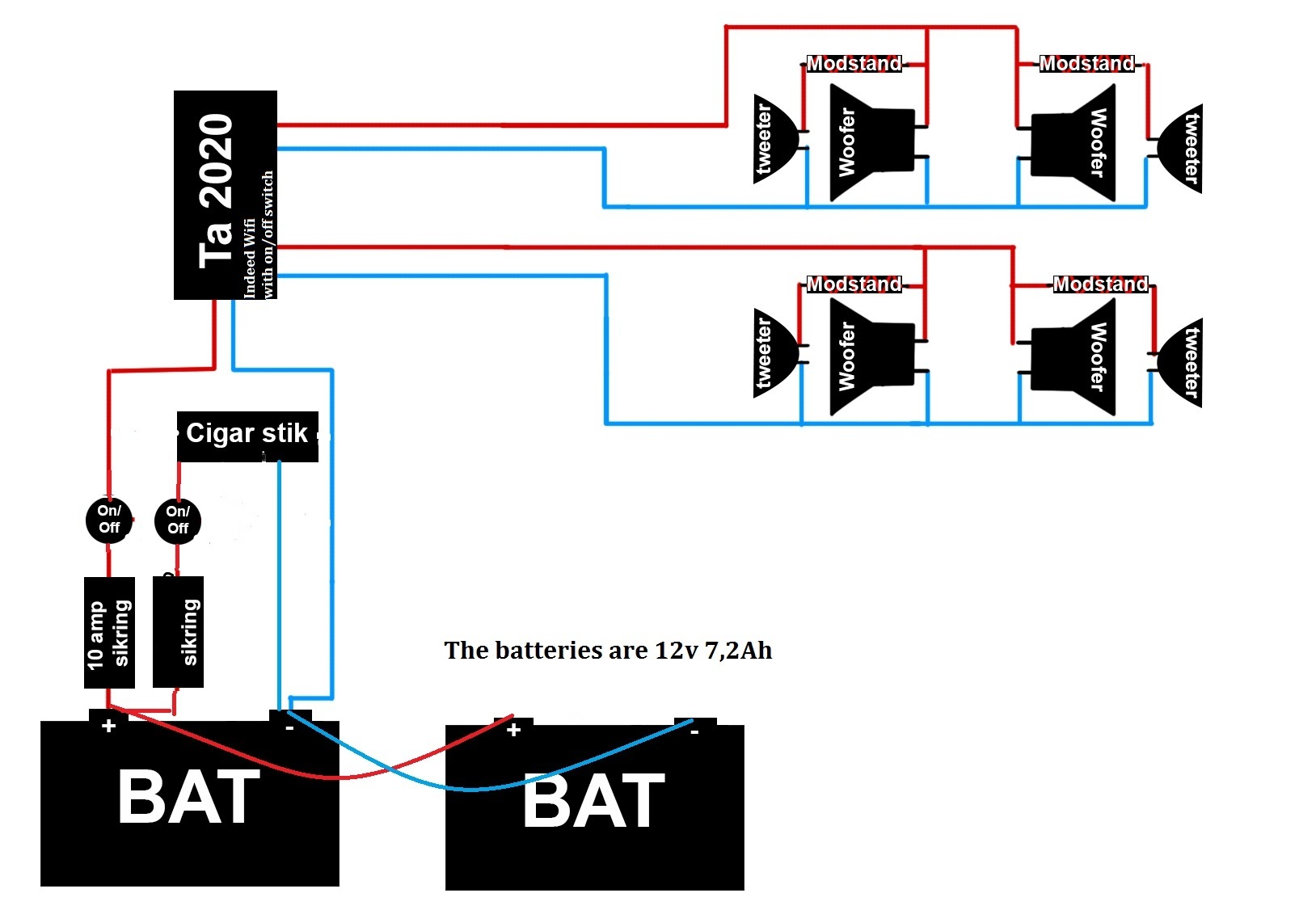

You can't put your cigarrette outlet before the Fuse (sikring). The first thing the battery sees must ALWAYS be the fuse 🙂
You should make sure that the cigarette-outlet is also fused. Just connect it after the fuse (I drew this on your diagram and reuploaded it).
This charger seems OK. It will however come with clamps, and I reckon that you want a "cigarette"-plug? Cut off the clamps and connect this.
Simply wind the cables together and stuff them in a cable shoe. If you don't want or can't stuff three cables in the shoe at the negative pole, simply run the cigarette-cable to one battery, and the amp-cable to the other. Remember however to parallel the batteries.
Biltema supplies, once again...
I reckon glue would be sufficient. There are likely some rubber feet underneath this. Just peel them off and route a perfect fit for the body of the amp and just slide it in, and then recess the front.
Thanks! 😀
No problem.
Okey thanks Viktor. Now my diagram looks like this. I still have some questions though:
1,5. How do I devide the cable after the sikring?
2. the cigar outlet is for charging my phone and charging the batteries with this charger: http://www.biltema.se/sv/Bil---MC/El/Batteriverktyg-och-tillbehor/Batteriladdare-12-V-2-A-37743/ will it work? will bouth of the batteries be charging with these connections?
3. I have to do 3 connections to the minus pole, what do I use to do this?
4. I have a Indeed Wifi amp (http://canopysound.dk/da/indeed-ta2020) and it has no screwholes, will it be enough to just glue+acrylfog?
